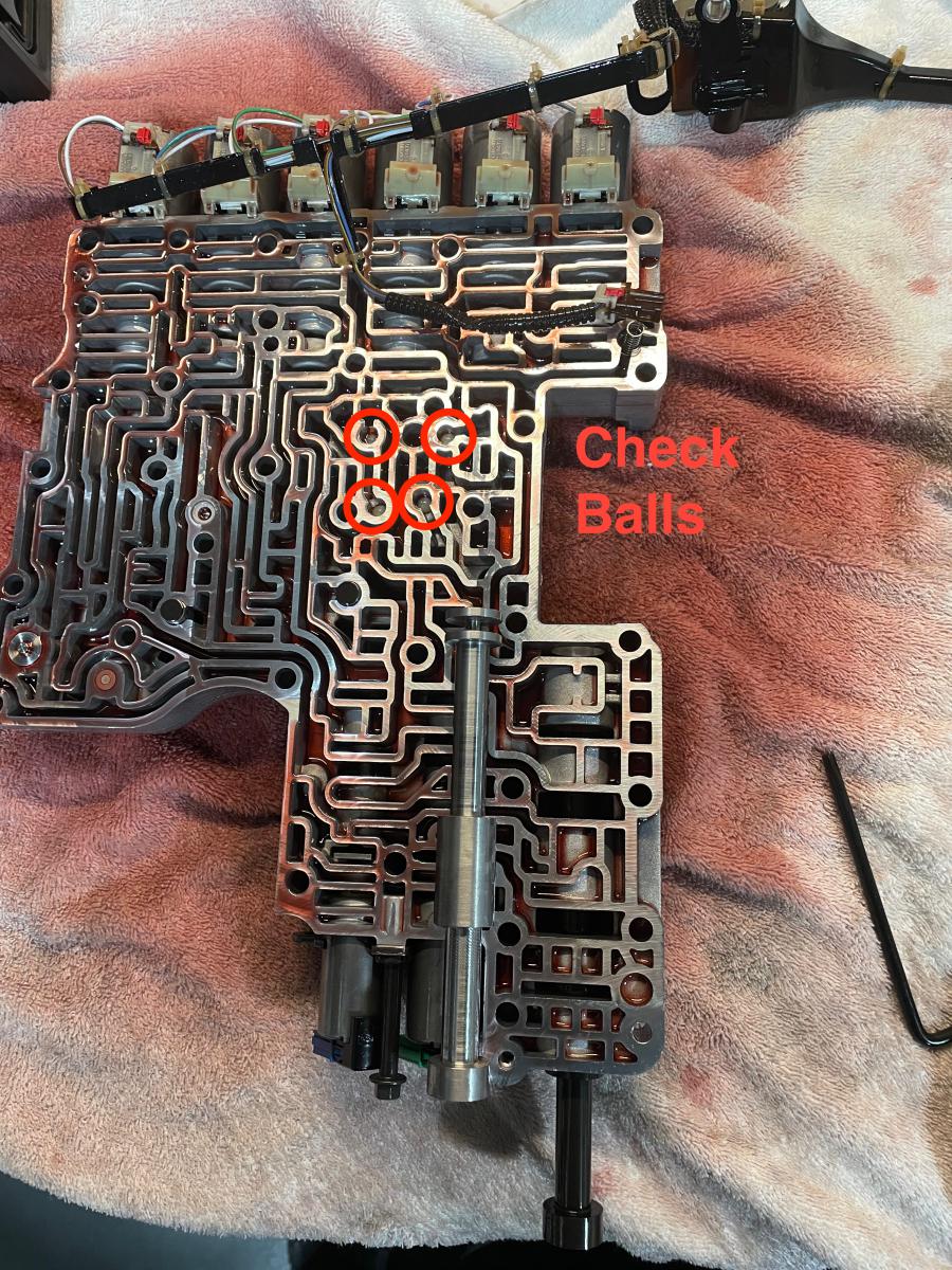

I received my Next Gen kit also but there is a tear in the instructions that show the check ball locations. Anyone have a pic of there locations? Thanks Roddrz for the tools required.

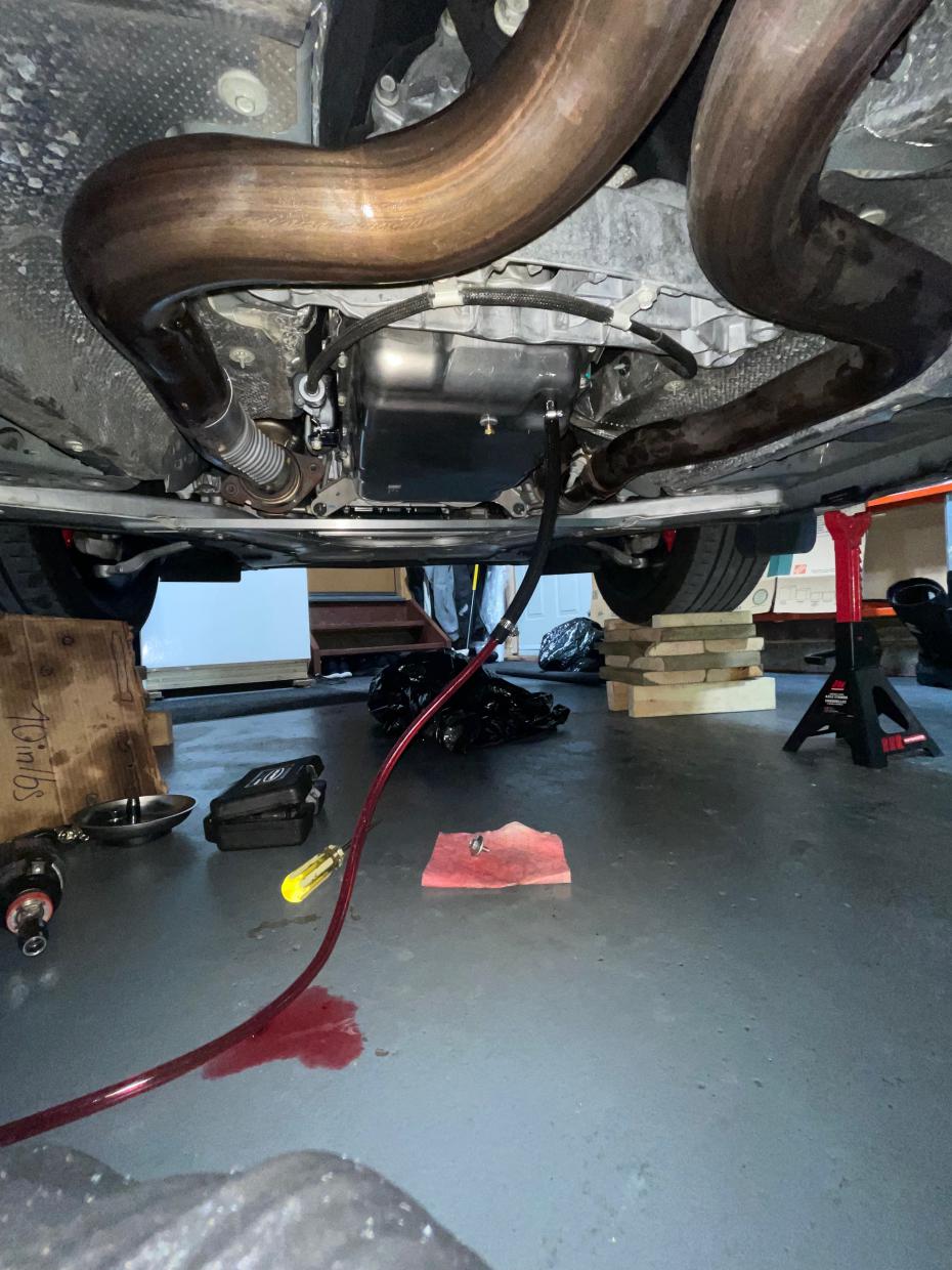

These are the main steps to install the Next Gen Drivetrain upgrade valve body kit for a 10L60.
Note: Not shown but discard all 3 OEM gaskets and replace them with the Next Gen Drivetrain gaskets supplied in the kit.
  • The gaskets after heating and compression forms the seal between the valve body halves.
The thermostat is the brass cylinder.
Discard this thermostat to improve cooling and facilitate a full fluid flush.
The installation from setup to cleanup is approximately 8 - 10 hours.
I'll also post this install with some additional tips over in the section, "Camaro DIY & How-to...."
