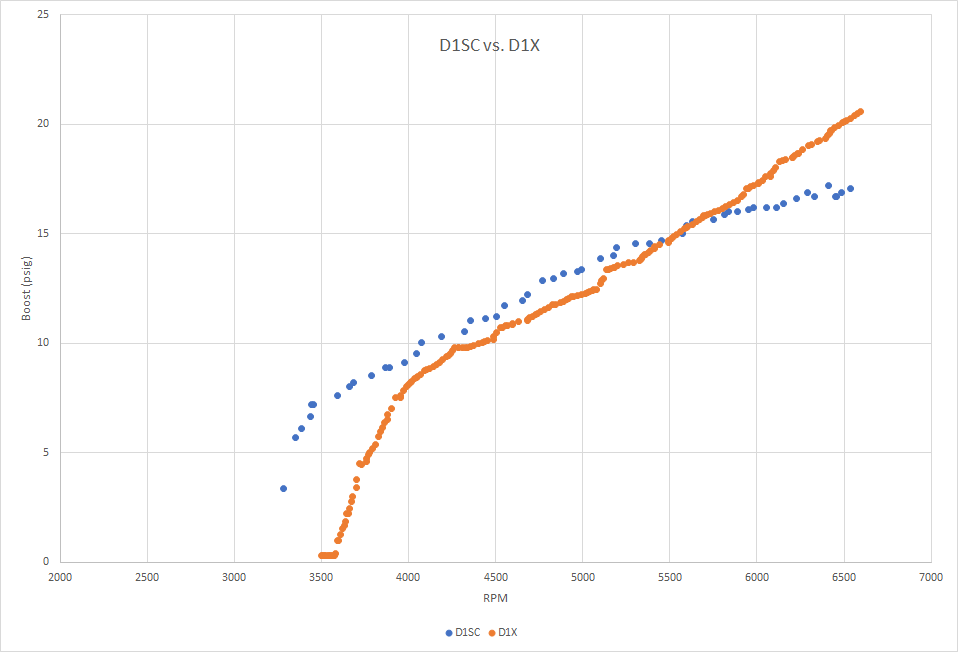

This chart is from LS1 Tech, a gentleman was kind enough to plot the differences between his D1SC spinning to 62,000 vs D1X spinning to 62,000. The D1SC does come on sooner than the D1X, but the D1X makes boost more efficiently beyond 5,500.
Having owned both blowers myself on different applications, I can honestly say I feel the D1X is the better bang for the buck
I picked up my D1X as a 2nd hand (really 3rd or 4th hand) deal for this application. If it wasn't for the fact that it's strapped to a fairly large displacement engine, I would have traded it away for a D1SC months ago. The D1X is absolutely brutal from a roll. And I like it a lot I do miss the D1SC in terms of low-mid curve grunt. Obviously not as punchy as a PD blower, but you knew it was there. We often cite "what rpm are you going to spend more of your time" but the real question is, what kind of power are you looking for when you get there? At WOT, I promise everyone spend more time between 5,500-7,000rpm than they do at 2500-4500. If you spend more time at 2500-4500 at WOT than any higher RPM, then you're buying the wrong type of power adder, you want to look at a PD blower.
That said, yes the X is the peakier blower, but you do not need to rev to 7,000+ to make use of it. With proper pulley combos, you can run a centri efficiently at any RPM. If you have to spin the blower beyond it's max rating, you should just move up to the next head unit if you want more power. If you roll over to LS1 Tech and read that whole post, guy is only reving to 6700 engine speed to hit 62,000RPM on the D1X. At that point, you're going to be fighting an IAT battle. Beyond that, you're exceeding ATI's efficiency rating for the head unit. Not to say that you can't take it beyond that, but the further you go the more you're just french kissing an angry dragon.
What you can't get in a D1SC is the efficiency of design. The D1SC is going to run hotter and never touch a D1X. Apples to Apples, a D1X is the better head unit. IMO, unless you're application is a truck, I think the X is the way to go. I know OP is talking about a P1X vs D1SC, but even the P1X is still the superior design and will take you to max power more efficiently. And again, how high the engine is capable of reving isn't near as important as how much air the engine can efficiently move. The X series wasn't designed for high rpm applications, it was designed to operate more efficiently at high rpm. As in, the head unit itself at high RPM. You can pulley a head unit so it maxes out long before the engine hits its peak, but then you're overspinning the blower.
To the OP: +1 for the P1X (though I really think you should consider the D1X if you're considering a D1SC at all).

Here's a comparison I screenshot of the d1sc vs p1sc1. Its not a p1x because like GreyGhost702 said the higher the RPM the more the p1x will make. My p1sc1 was on a 3.4 upper while the d1sc is on a 3.85. I could be wrong but from my understanding the procharger rep said the p1x would have made the same amount of boost if I did go to it so I did get that gain going to d1sc.

That graph doesn't really apply here because it is showing the capabilities of the D1x when pullied for 20psi. The car in discussion here is a stock bottom end. It won't make it 2 pulls on 20 psi of boost. Pulley that D1x for 10psi peak and you will see the D1sc has a much flatter boost curve and would be all around a faster car.
The D1x is way too much blower for a stock bottom end car.
It's no different comparing the Maggie 2300 to 2650. Pulley both for 10psi and the 2300 makes more power under the curve. Pulley both for 15psi and the 2650 pulls away no contest.
Different size blowers exist for a reason. Anything under 850whp I would stick with a D1sc or P1x. They both are fairly close in capabilities, so it's kind of splitting hairs. Manual car I would probably opt for D1sc for the little bit more low end boost that it makes. Auto it doesn't matter as much.
Agree 100%
I always thought the advice from the late, great, John Lingenfelter was always sage: “Build torque in the RPM band at which the car will spend most of its time”. Since torque is simply airflow plus timing, it’s not hard to get where you want to go.
