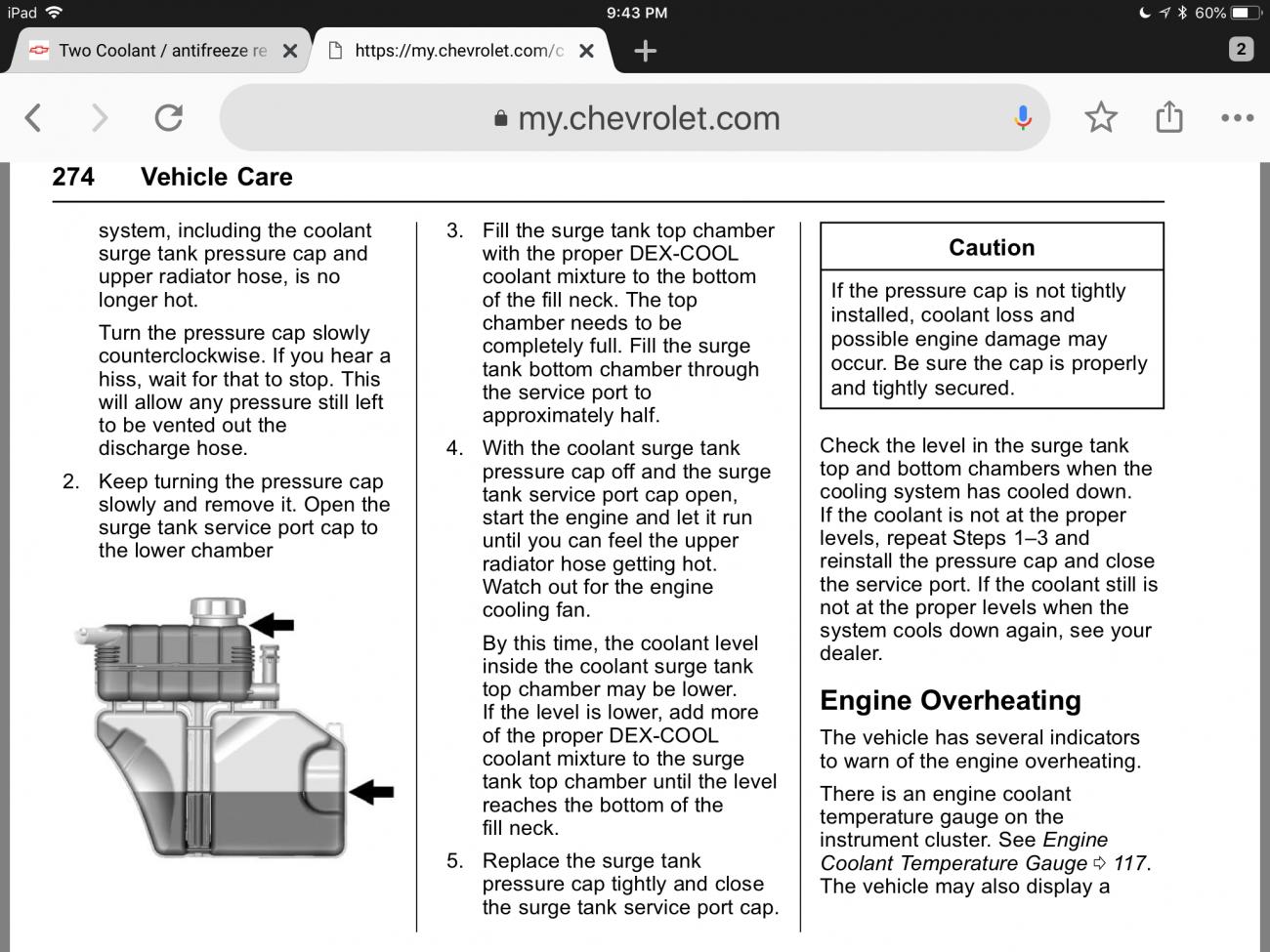

JSH, you're low on coolant.
The top tank is part of the pressurized loop and should always be completely full. The bottom tank is the overflow/expansion tank and should be half-full.

I've owned the car almost 5 years and I've handle this process incorrectly the entire time as has my shop. I'll do all of that this afternoon and see how things look tomorrow morning. Thanks!

In my opinion the manual is somewhat vague in how it explains it. The manual talks about the expansion tank service port but does not point it out. For those who have a strut tower bace, like me, the expansion tank service port is hidden under the strut tower brace.

Yes, but I'm comforted by the fact that I'm not the only owner who didn't know how to do it properly.
The service port is obvious on mine as it doesn't have a cross brace.

Yesterday I followed the procedure in the manual, drove the car and parked it. This morning the top reservoir was half full and the bottom reservoir was 3/4 full. The procedure says the bottom tank should be half full in the top tank should be full but I don't see how I'm going to get to that stage
