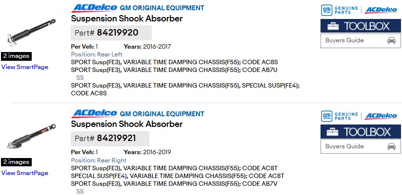

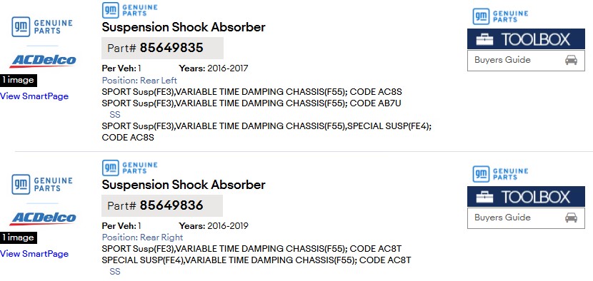

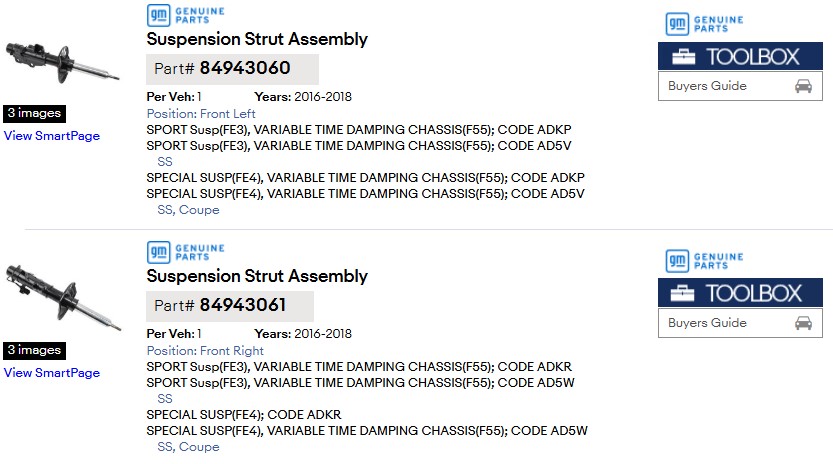

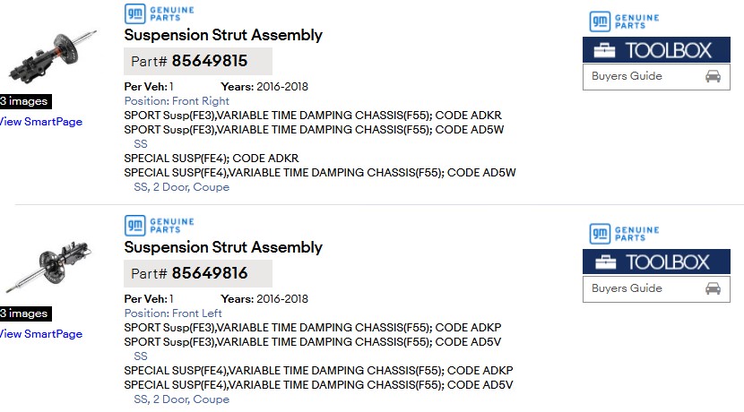

2017 2SS with MRC does anyone have part numbers?

What I found (from here: https://parts-catalog.acdelco.com/acesCat.php? )
