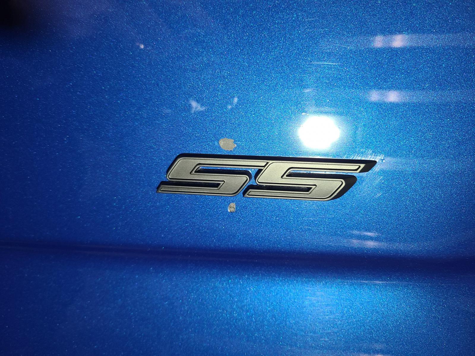

Yes, I recommend heat, it makes it easier to remove. But be very careful as others have said. I was using a plastic kitchen scraper, should have used something smaller/narrower. Don't let this happen to you.
My Camaro Journal
Old 11-30-2024, 10:43 AM   #9
Posts: 13,149
That SS emblem is upside down, too.

Haha, now that I think of it, the pic itself might be upside down, hard to tell
(Those paint scratches make that less likely, though, probably everyone would start the fishing line cut from the top, and that's where I see the sawing/hacking marks in the photo.)
