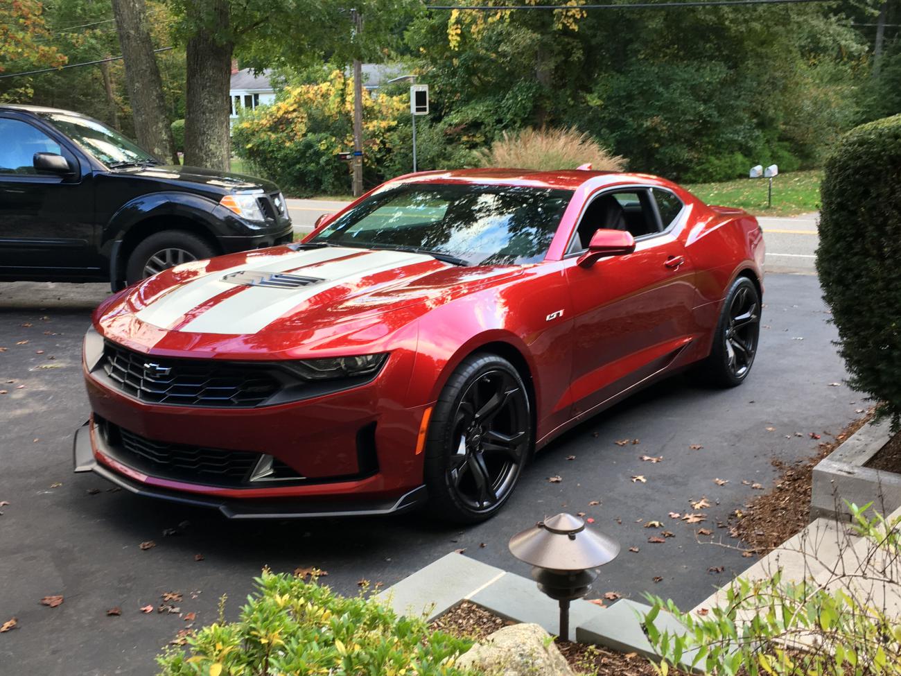

Here’s a pic of the wheels on the RS. If he wants to make it even more aggressive looking, add a splitter. The one I have installed is a cheapo EBay 3 piece. I added double sided tape to the grooved section(to make it more secure). Total cost somewhere between $80 or $90…
I just re read, your post… his RS is 2017, the front end is a bit different from mine.
