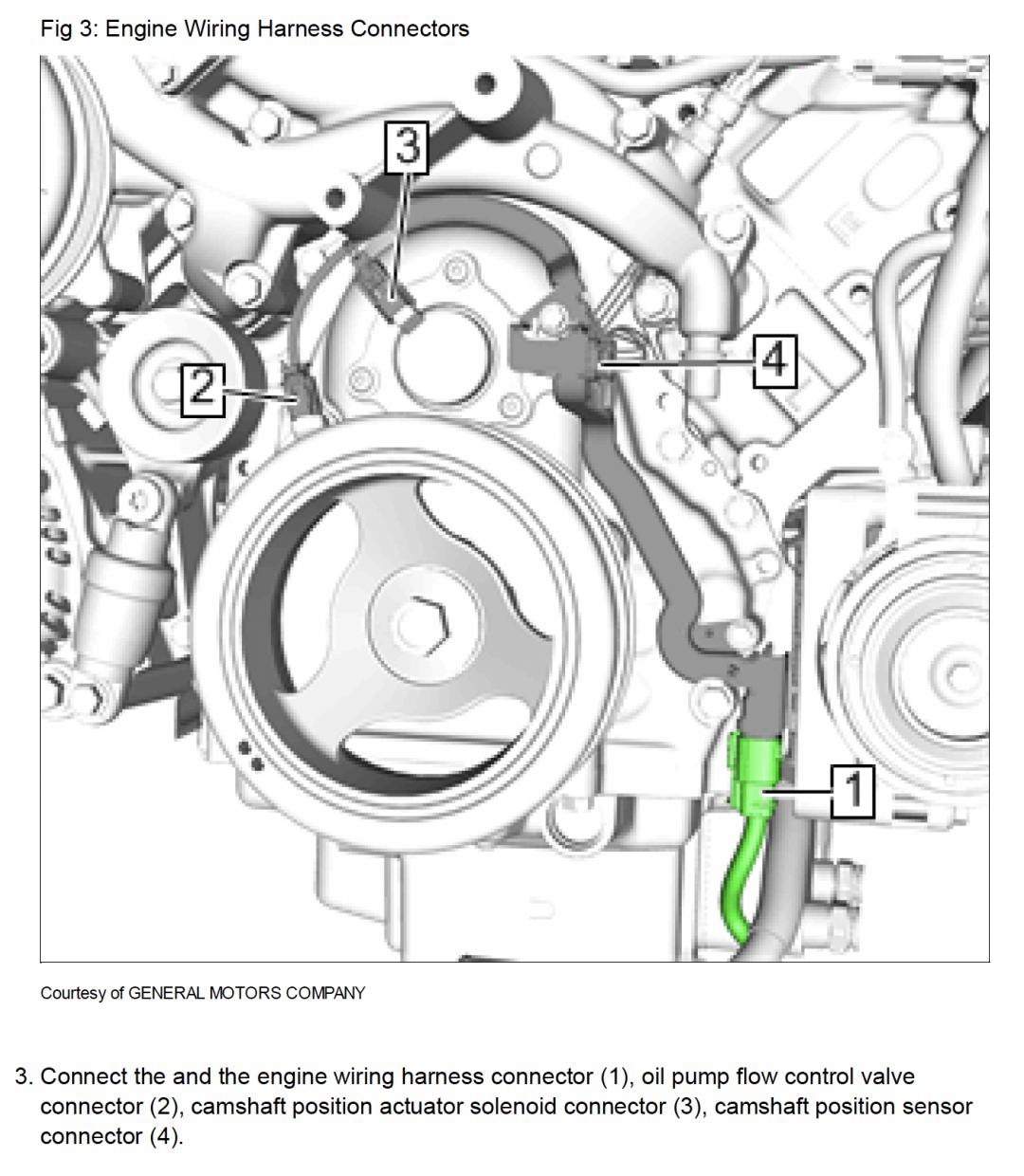

I'm curious now that I have the diagrams it shows there being three connections on that small harness. Do they use a new cable with the kits removing the cam actuator connection? Below is from the service manual.

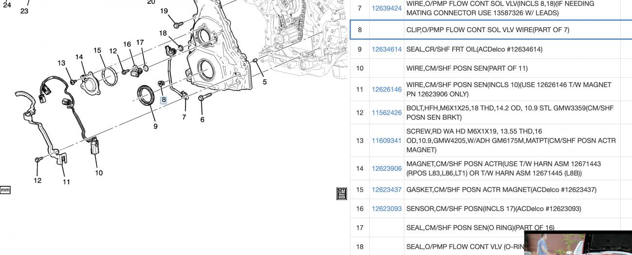

If it's the O-Ring 18 included with number 7 in the picture then that means the front cover needs to come right? If so then that sucks.
