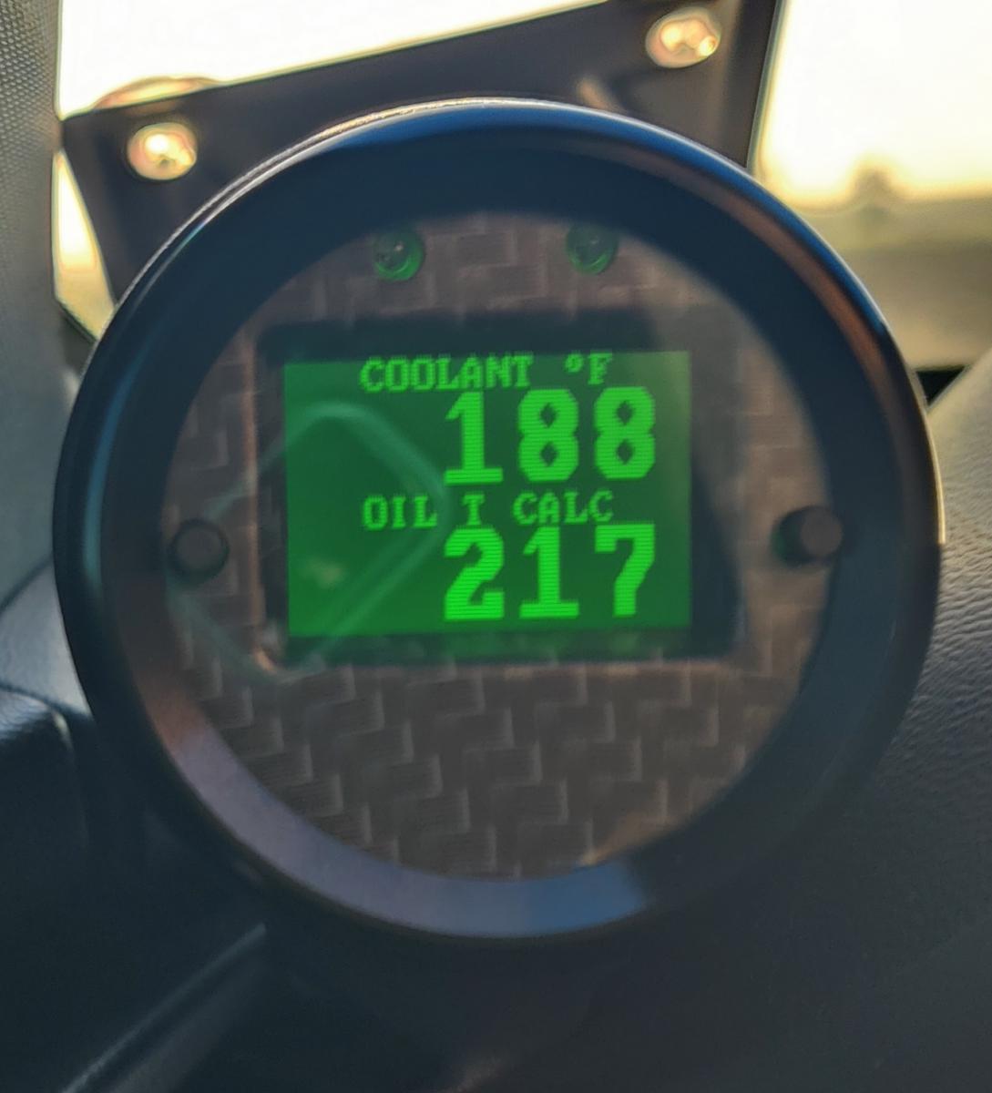

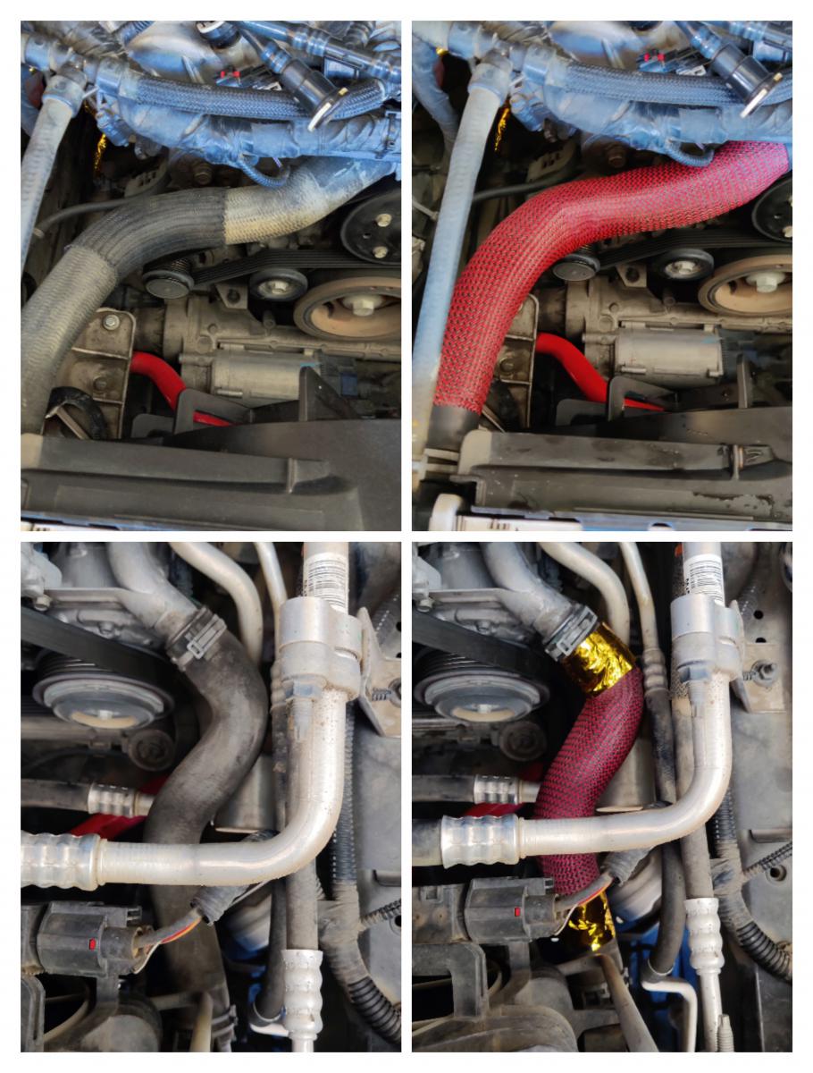

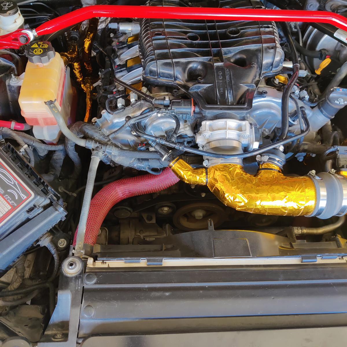

Mishimoto doesn't make the correct lower radiator hose for my model Camaro, so I ended up ordering heat sleeves. Intended for just the upper radiator hose, I had barely enough to do the lower as well. Ordered heat shrink to replace the lower gold wrap but it works for now.
From what I can tell, coolant reaches lower temps faster and stays cooler, despite pushing the engine a little hard for 20 minutes just to make sure there were no issues. After driving hard for a while I could touch the upper hose with my bare hands. Definitely cooler. And yes, coolant was added. I wanted a quick photo before I did more

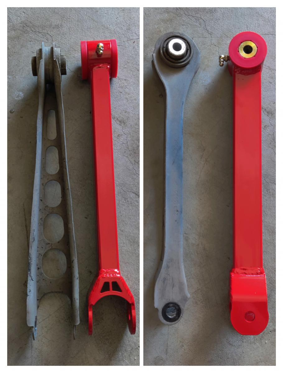

Installed BMR lower trailing arm. About a pound heavier per side (OEM: 1.5lb, BMR: 2.5lb). Just need to get the upper trailing arm and upper control arm then pretty much done for suspension

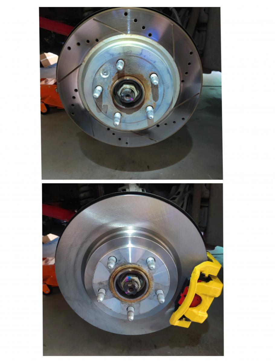

Swapped the rear Powerstop Z26 pads and rotors for OEM rotors and Brembo pads. Did a quick brake bleed since I had a bottle of the RBF-700 laying around.
What a big difference in braking. Car stops almost too easily

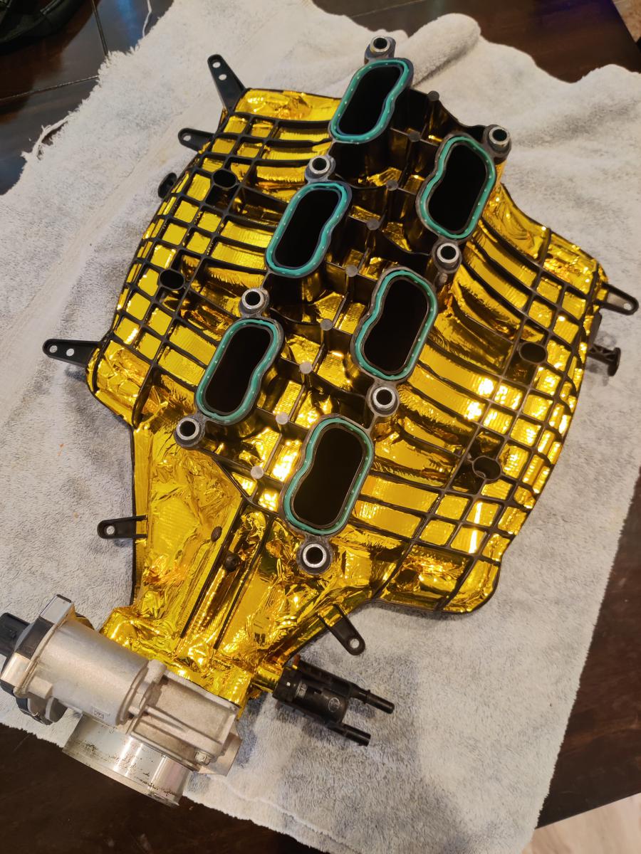

Saw someone selling their intake manifold that was gold wrapped underneath. Figured I'd do the same since I had enough laying around.

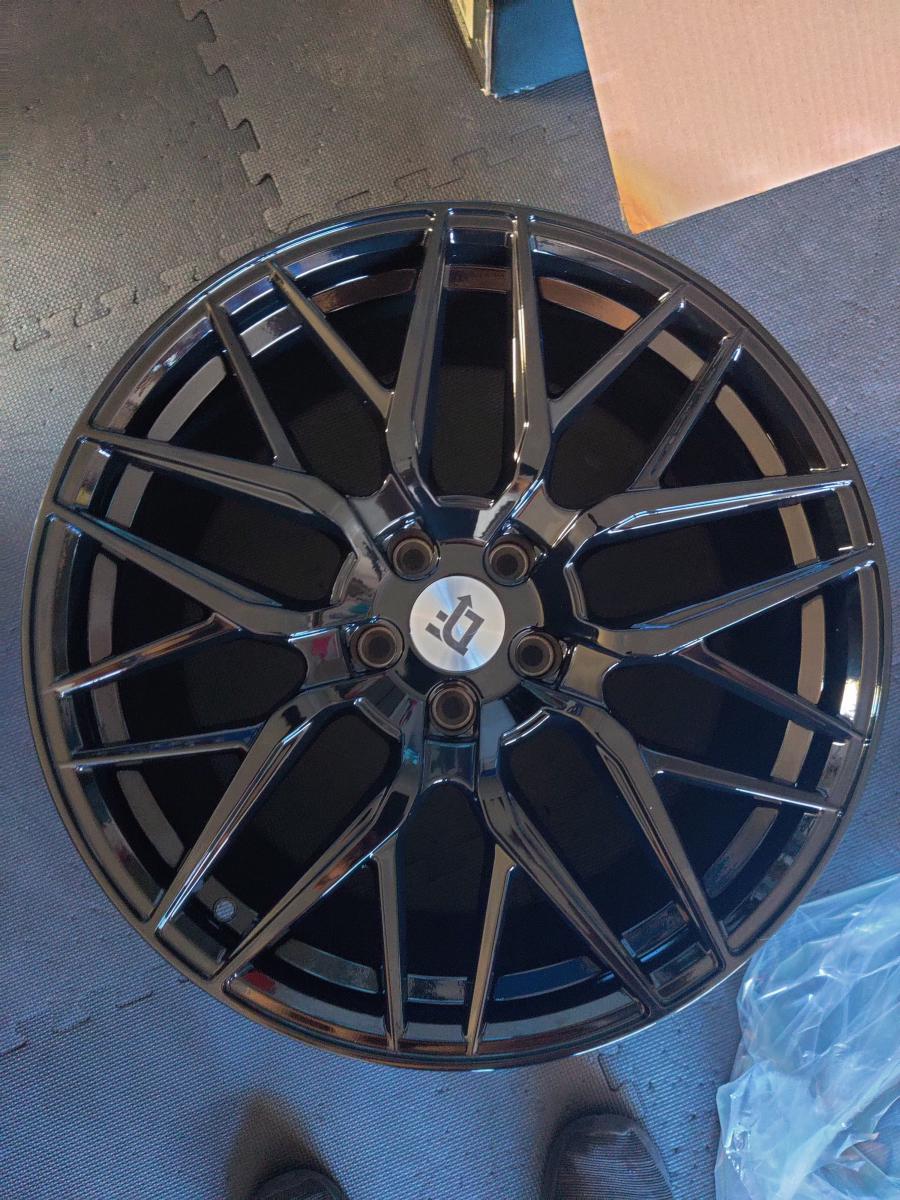

New Downforce DC10 20x10 ET 25 and 20x11 ET 43 arrived. Just need to get new tires (285/30 and 305/30) and wrap or paint the center caps.
Overall wheel setup will be 5 pounds lighter per wheel, so down another 20 pounds in unsprung weight which I hear is a good thing.
Current wheel setup will be available soon for cheap.

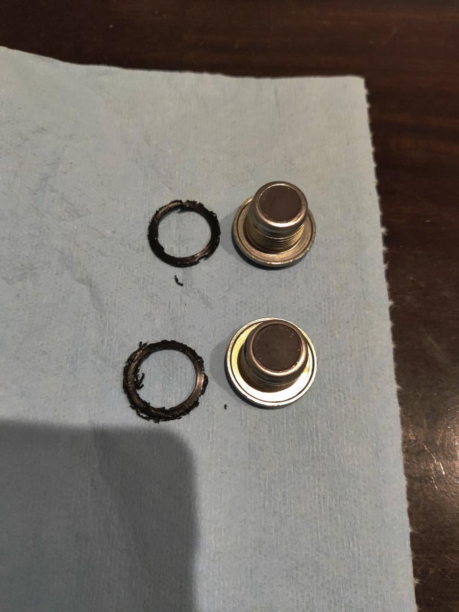

Day one of projects. Installed upper control arm, did an oil change with a new magnetic drain plug, drained the rear diff (fluid arrives tomorrow) and swapped gaskets on diff drain plugs since these were pretty beat up

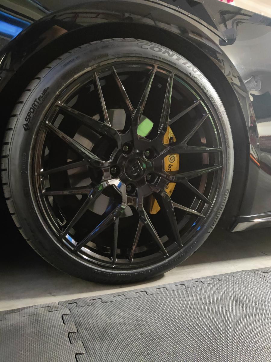

20x10 ET 20 front with 285/30 Continentals
20x11 ET 43 rear with 305/30 Continentals
5 pounds lighter per wheel than current setup. Will install and get a track alignment in a few weeks.

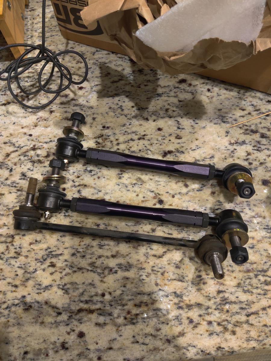

Finally got around to installing the BMR toe rods and front sway bar end links. Went ahead and preloaded the end links since it's usually just me in the car.

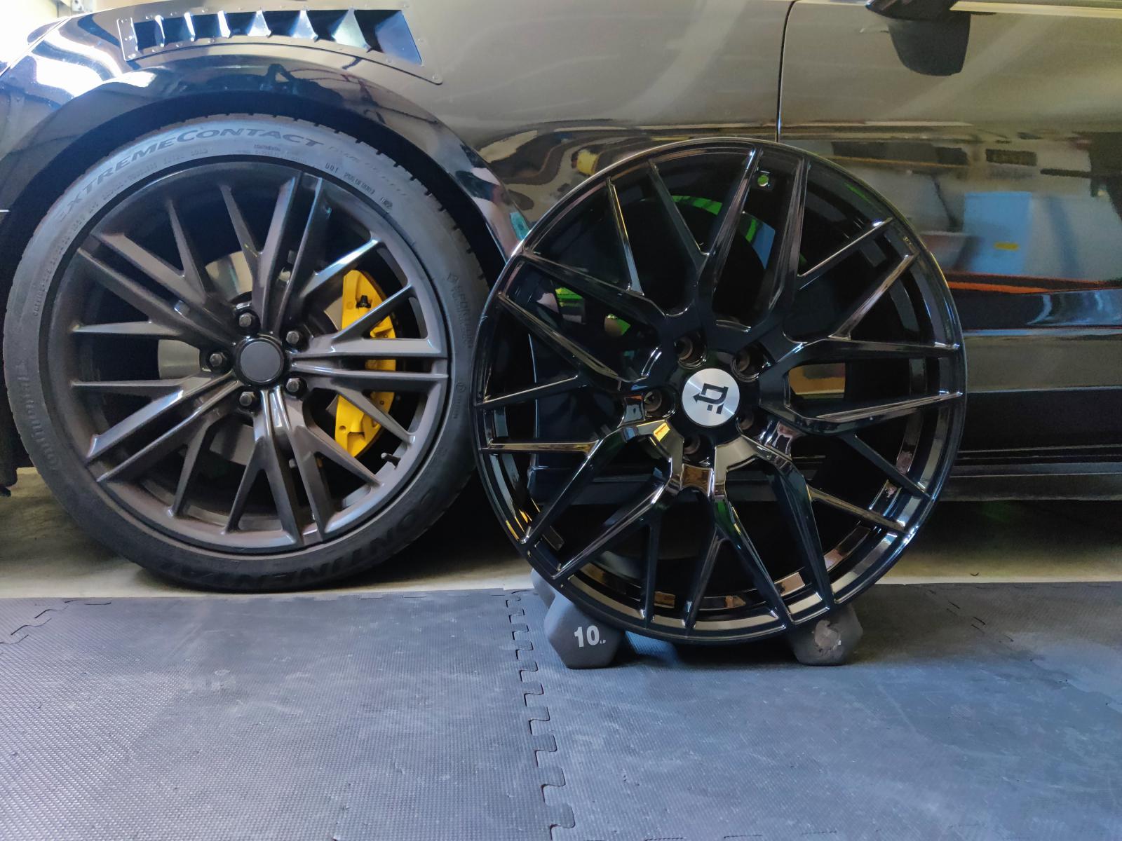

And while the tires were off I went ahead and put the new, lighter wheels on. Will be selling my old setup once I clean the wheels and take some photos.
