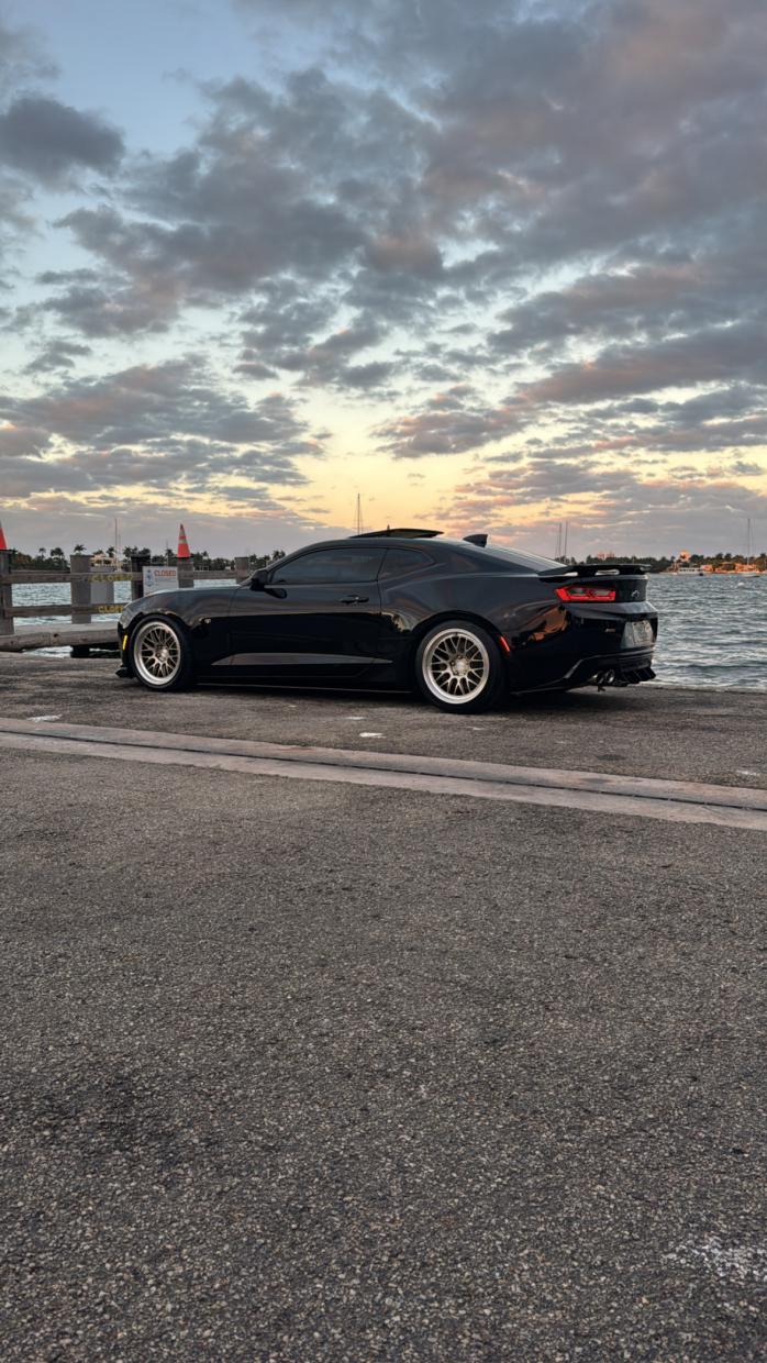

Old 01-28-2025, 01:03 PM   #326
Mike Aruba
Mike Aruba's Avatar
Drives: 2016 2SS
Join Date: Apr 2020
Location: Florida Man
Posts: 89
Need to get better pictures.
