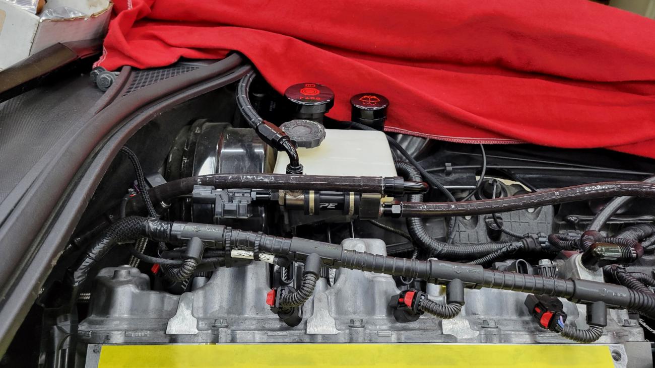

It’s still being finished. I’m having an oil feed and return made. Feed will come off the oil pressure sensor and return will be ran back down to the oil pan. The recommended oil service interval is 1k miles if racing or every year/5k miles if it’s a street car. When I talked to XDI I was told the pump failures were from people not changing the oil. They plan on making these pumps again with an oil feed provision once parts to make the pumps become readily available.

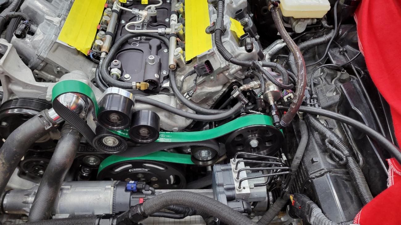

The kit I bought had a different style belt tensioner than what was in the C7 instructions. Looks beefier

We revised the bracketry to use the LT5 tensioner due to belt slip issues using the original design that had used the LT4 tensioner.

I’m going from a 8.4/2.83 pulley setup to a 9.45/3.15 to help belt wrap. I’m interested to see how it works out with a LPE HPFP on the engine side. I’m hoping I can now max the +65 injectors out holding 25-2,600psi.

It’s almost done. All that needs done is the interchiller spacers installed with the blower, refit the air intake for the 112TB/snout and prime the engine for startup.
