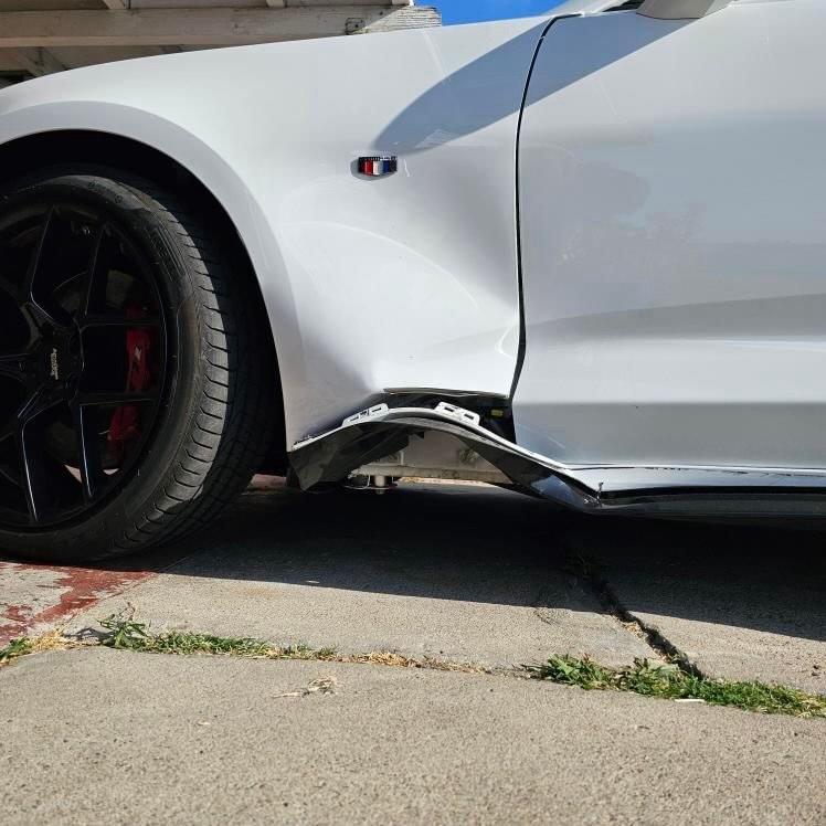

The tech absolutely had poor positioning on the jack, he barely had the lift point on the jack, and as he raised the car once the angle was too severe, the jack slipped off the lift point and the car fell fender first on to the jack causing that damage.
I have a buddy who is only alive today because we set our wheels under the car as an added safety measure in case of a jack stand failure. He was wrestling put his exhaust back together after replacing his clutch. Rear jack stand (Sears brand) failed likely due to side loading, (the shaft sheared the teeth all the way down) when that one failed the movement of the axle caused the second stand to be kicked out and the entire rear of the car fell on him. Frame hit the wheels and gave him a gap, only reason he survived. By the time we scrambled to get the jack under the car and pump it back up, there's no just no way he would've survived. We had to drag him out, take him to the hospital, he had a cracked sternum, some bruises/cuts on the front/back of his head, fractured elbow and wrist. Not to mention the mental distress.
Very few scenarios where a car falls on you and you just brush the dust off and walk away. This story smells of lies and I agree you should speak with legal counsel.
Regarding insurance rates, it does depend somewhat on the state, and while accident forgiveness is a thing for some insurance companies, it certainly isn't for the rest. In a world of algorithm's, employees often throw their hands in the air in front of customers saying "this is what the machine is telling me." A claim puts you in the system, it hardly matters who was at fault, the system only cares that your were "involved." Being involved moves you up the risk factor measurement and the algorithm takes this into account as well as the cost of the claim. As far as the devaluation of the car, only a legit appraisal will tell the tale, but insurance companies don't always care about what a care appraises for if it wasn't appraised by their agent.

This will end up in court if it's more than the car damage. There will be subrogation between the insurance carriers, especially if any injury comes to light (the mechanic allegedly under the car at the time). The next claim from the mechanic, if there wasn't actual physical injury, will be mental and emotional trauma.
It would be interesting to see the outcome. It's obvious how this happened. the lift pad has a crowned lower surface, and it's clear the pad of the jack was not centered and the car slid off due to 1) the lift pad crown, and 2) improper placement of the jack. The experts will argue in court, and I'll bet some blame will get assigned to both parties. ZL1addons will be pulled in for the design, but the OP will probably come out okay as he never told them to use the lift pads.

There are more than a few videos on YouTube of various pricey cars that techs fail to lift from the proper jack points on the chassis. It seems there’s just little or no proper training being done, especially at dealers by the manufacturers, on where and how to properly lift and jack these cars. Not just Alpha-chassis Camaros and Cadillacs - the C8 Corvette with its mid-engine weight transfer has seen its share of nightmare scenarios too.
It takes 5 minutes to simply look up the lift procedure in the factory service manual and these techs dont even want to do that if they’re not trained. Or better yet - don’t touch the f’n thing if you don’t know!

.Well good news I got my car back from the autobody shop. I'm very happy with the great customer service and effort they did. They got my car done 3 days sooner than estimated and texted and called thru out the process with updates. I highly recommend Carrillo &sons and can't thank them enough for getting my camaro back right.
I even plan on taking my 72 chevelle to them for paint and body work.
Thank you all here on camaro6.com for the support and feedback.
At 49 lessoned learned and I'm off to buy race ramps and do my oil change from here out......
