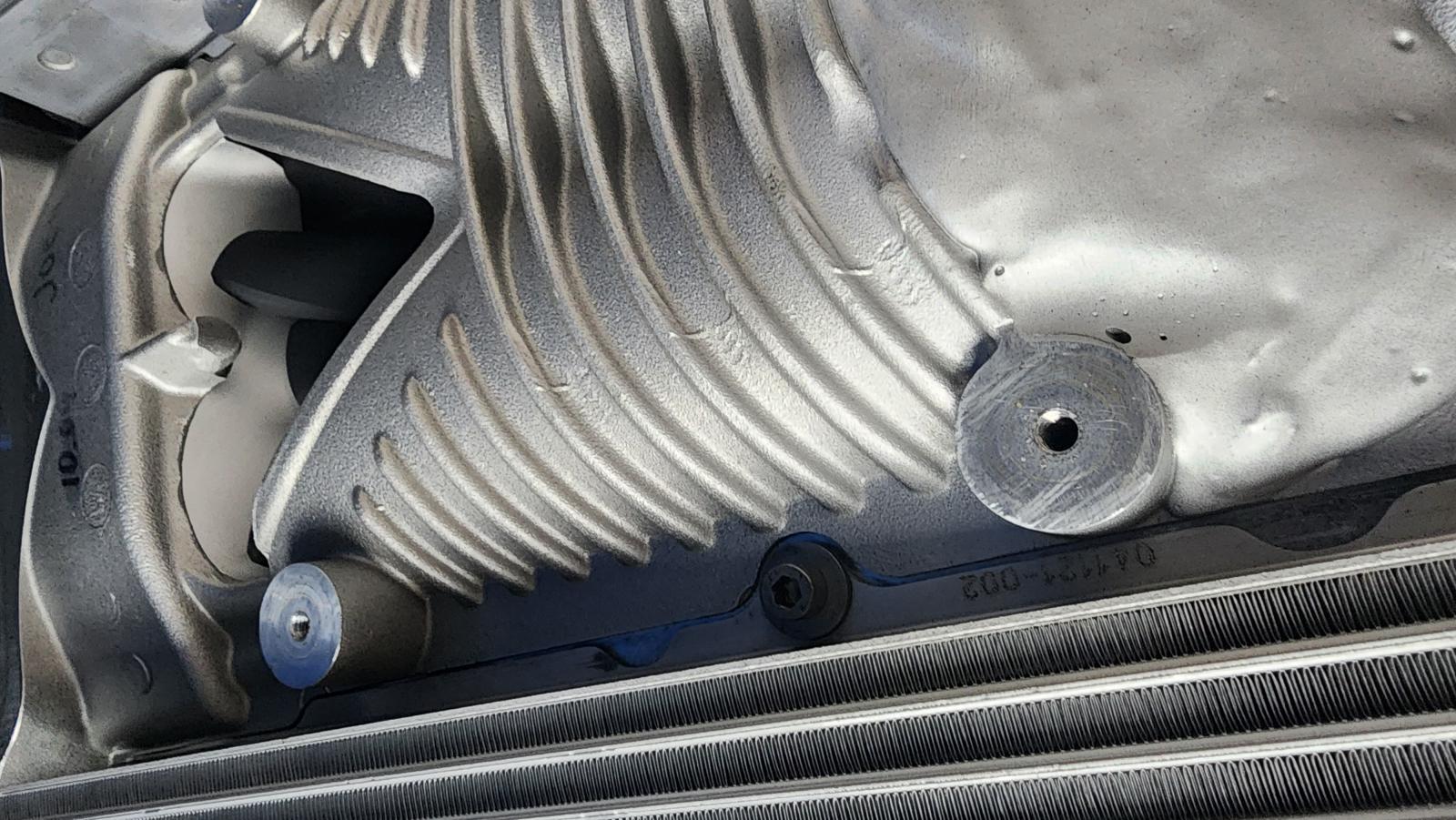

I just pulled my blower lid today to get my car ready for the new MPI lid coming in tomorrow. I have to say, I am IMPRESSED! There is not a drop of oil inside my blower. I had a Mighty mouse catch can prior to this, and it did ok, but there was still a small amount of oil in the blower. I track my car on a road course, so it is driven very hard. (I have done around 5 track days since the install) Whenever I installed the E2-X can, I didn't even clean the oil out of the blower. The last picture is with the mighty mouse can.

That's impressive to say the least! I had fits with my Elite E2-X, but that was with aftermarket valve covers that didn't have baffles. So it would have probably worked that good for me if I would have had stock valve covers or ones with full baffles. I ended up switching to the Mighty Mouse Wild 1000. Have you seen the new plates Kong is using vs the Epoxy !

Yeah, you gotta have baffles in the valve covers.

The design inside the E2/Tracy Lewis/etc. cans is solid for catching almost everything that goes through it.

I use the oil life monitor for changing the oil, and dump the catch can (CC) at the same time. I get about 2 table spoons of oil every time. I've pulled the lid off several times since installing the CC, and if there are many deposits, it's usually in grooves or stiffening ribs, and it's only drops-worth. The bricks are usually free of anything less than a "sweat" and almost nothing but a dry paper towel could pick up.
I feel like I started collecting slightly more after running E', but that could just be me. Usually - every drive, I'd go WOT a few times, so the engine's moving some air around.
