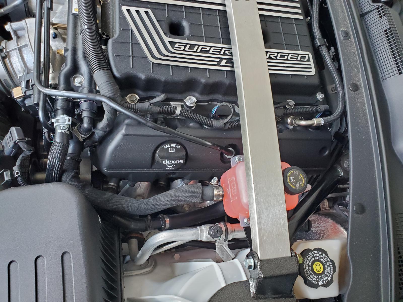

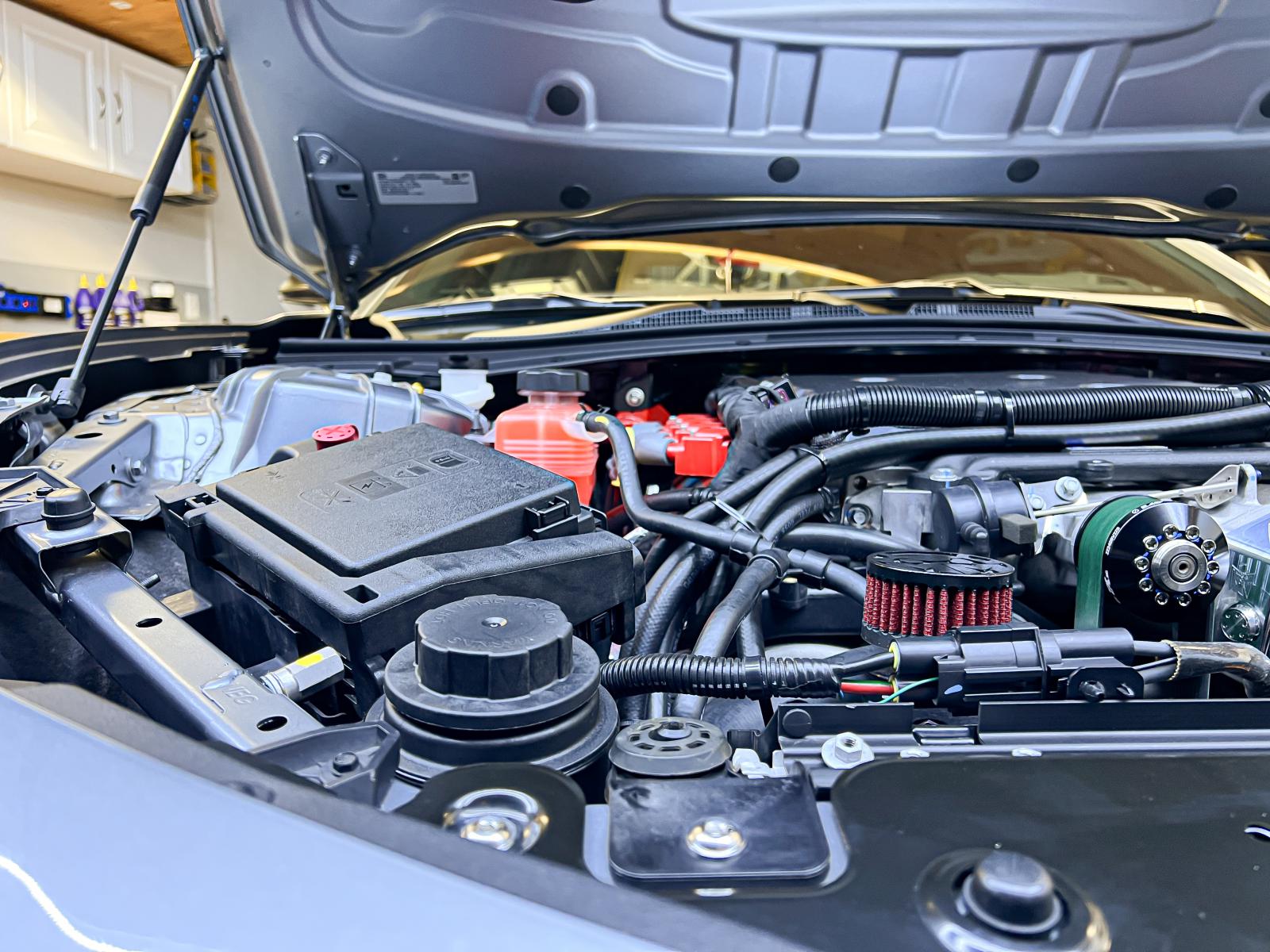

I have a Cordes expansion tank and it's not mounted by the headers. It's right behind the radiator in front of the belts.

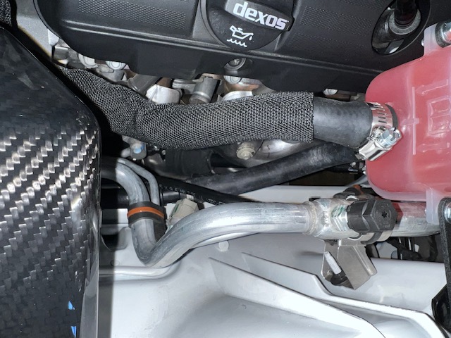

+1 on the LSA Conversion supercharger reservoir kit. I installed mine last week. Looks OEM, increases the amount of coolant in the system and is much easier to bleed and fill than the stock system. I ran my return line close to the fender and stock airbox.
Yes, this is the one I will be choosing my catch can is by the strut tower
Photo?
