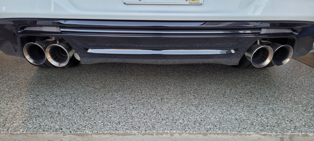

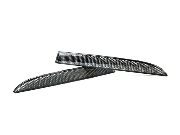

How on earth can anyone install smoked Rear Reflectors on their 2016-2024 Camaro?
I am having a hard time trying to install smoked rear reflectors on my 2022 Chevy Camaro. Reaching into such a tight space is tasking. Any suggestions on how to work smarter, not harder with this installation?

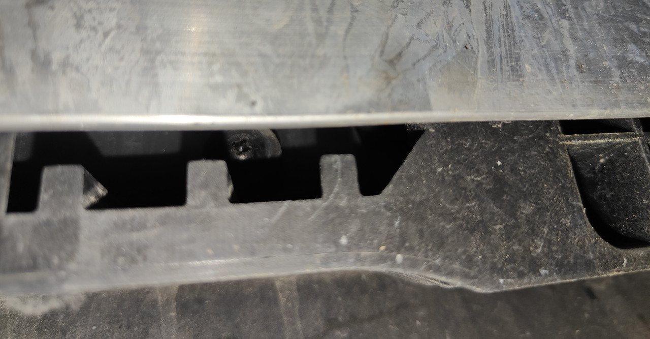

I’ve done it twice without even lifting the car up. Smaller guy so I can just slide under there. Having said that I am literally working blind. So getting the screw out is the easier part. The trick is to get the right sized screw driver so it fits in that spot and between the exhaust suit case. Once the screw driver head is directly into the screw, press inward and turn as they screwed it in pretty tightly from the factory.
To get the new one in I used painters tape to tape the screw to the screw driver. I think I also try getting the screw through the hole before completing putting the new reflector in.
Hope this helps. Just keep working at it and you’ll eventually get it. You’ll be tempted to just go buy double sided tape multiple times but I promise you you can figure it out without it.

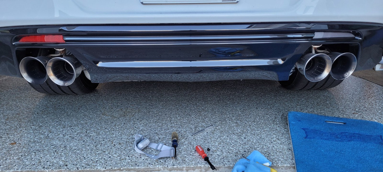

Patience is a virtue for this "apparently innocuous" easy procedure. This is mainly a blind, feel and touch procedure. First thing is run the screws into the new reflectors where the plastic screw receptacle is to get a good internal thread started. This will make the task of blindly attaching and tightening the screw easier later.
Aim a flash light at the area where you will put a small Phillips screw driver (preferably magnetized) into the black abyss and attempt to extract the small OEM screw. If you are lucky after many tries to get the little tip into the screw and slowly, delicately, gently un-screw the fastener. You will drop it inside and must retrieve it with a slender pen magnet. The red reflector comes out easily.
I used the OEM screw (kind of mistake) which has a built-in washer versus the supplied screw which is shorter and a separate washer. Put a small orientation screw driver from the outside in to find the area first where you want to put the screw in from the inside. My screw driver was magnetized enough to hold the screw while I attempted to put it in a tiny hole that you cannot see. This is the most frustrating part. Once obtained the area where you will feed in the screw, pull out the orientation screw driver from the outside. Put your finger in that same hole area while you feed the screw from inside. Eventually you will feel the point of the screw with your other hand/finger outside. With that same outside hand place the new reflector in and try to start the screw to bite into the plastic hole. Accomplishing this task is a great relief. Tighten gently the screw carefully as not to risk the screw driver falling off the screw. Maybe 20 minutes of frustration. One down, one more to go.
I did the other side the same way, but for some reason I could not completely tighten the OEM screw (reflector was to lose) and wasted a lot of time. Took a break then went back creeping under the car to start all over. Removed the new reflector and decided to use the smaller screw/washer provided. These screws are shorter, hence easier to apply and overall better (guess that is why they included them). Next my magnetized Phillip screw driver went limp and would not pick up the screw. I resorted to blue painter’s tape wrapped around the tip and the screw/washer to hold them in place. This time luck was on my side and I was able to remove and replace quickly in five- or ten-minutes total.
What a fun project and a challenging surprise, but totally worth the outcome. I think the rear end looks so much better.
