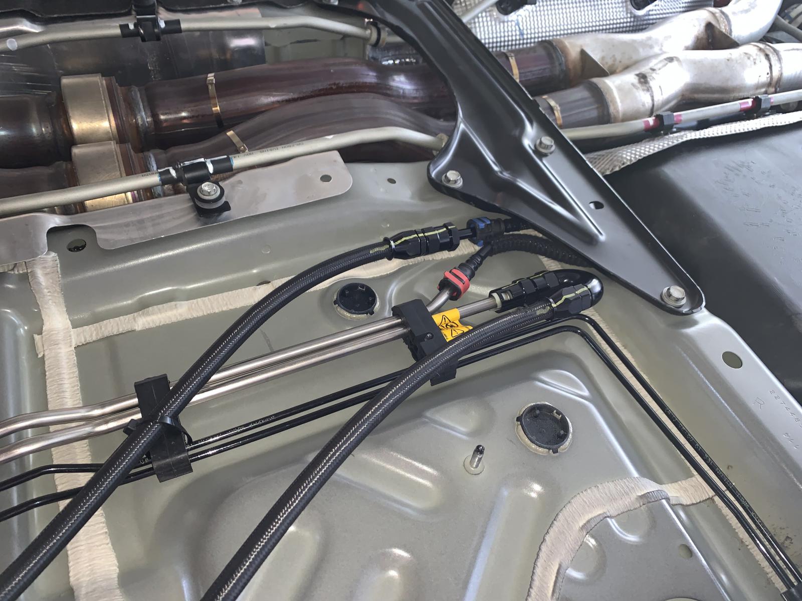

I'm trying to find (or put together) something more stealthy. So far - there aren't many in-line filters that are short enough to fit between the OEM tank feed and the OEM hard line, where the DSX aux' pump "T" pops in. I thinking I may have to fab up a "U"-type break out at that junction and run a filter there. Hmm... I was hoping for doing something with the OEM soft tank line, but there doesn't look like enough room... ugh
The dedicated motorsports filter kit is pretty stealthy IMO. It sits behind the blower, bolted to the firewall. The only part that you can see is the 6an line running to the OEM fitting above the valve cover. No different than having a FlexFuel sensor there.

I'd much rather have it under the car... there must be a solution out there already, no?
This is what I came up with, and funny enough - this was the same harness routing, I later found because of my fuel sender issue, that Katech suggests for their aux' pump controller installation. It wasn't too difficult and wasn't terribly expensive either. I'll add some nutzerts and adel clamps where the zipties are (they were temporary to see how I like it and how the underbody tray fit), and have since this picture, installed 1/2" spacers under the floor brace where the OEM tank lines connect to the car's fuel lines to give that area some more room for the fittings. It takes up no more room than the DSX aux' pump had and the filter element is about $35 or so (and it's a 2-stage 5-micron element) good for 1000-WHP on E', according to DW's tech.
As far as the filter-related costs: $90 for the filter; less than $100 in fittings; $80 for the PTFE line; and nutzert/tool costs, if you don't already have one. I like this better than the kit referenced above, for both heat/space reasons and because of a more factory look under the hood. I've never leave anyone to think I'm suggesting this is the best way (or that I did a good job, even, lol), but I'm pretty satisfied.
