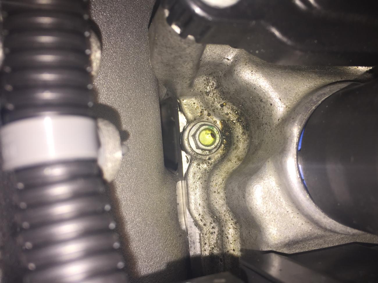

I found residue around the oil fill cap a few weeks ago and cleaned it up thinking it was from the last oil change. I’ve cleaned it twice already and it’s back again. Is this is a common issue on the ZL1?
Also found an oil spray pattern on the oem intake elbow where the clean side pcv system gets its vacuum.

Actually appears to be leaking from the sensor just below the fill cap toward the center of the motor. Clean it and check again or just take it to the dealer, thats an issue I would want resolved quickly mostly because its making a mess.

My bad, I thought the last pick was a close up of the oil filler tube. Still looks like there is a leak at that sensor socket below, oil leaks typically migrate front to back.

Thanks for the help. I took the plastic cover off to make sure it wasn’t something big and it’s either one of the valve cover bolts might be loose or the oil fill cap is just not keeping the oil in. The plastic extension piece that’s attached to the valve cover is loose and there is no way to tighten it. You can see the blue o-ring in the picture that’s supposedly sealing it.

Not doubting you at all. Just wanted to see where the hell its coming from. After looking at the back side of the plastic cover I’m certain it’s from the oil fill tube. The sound proofing on the back has absorbed most of it and you can see it’s misting out past the oring of the fol tube.
