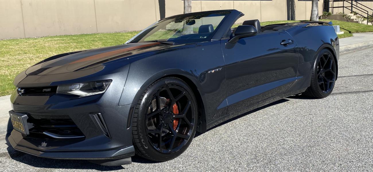

Check out this thread: https://www.camaro6.com/forums/showthread.php?t=471781
Those look like aftermarket headlights. Also, if you have a 2017, the highest trim level for the V6 or I4 is 2LT. Typically, 2LTs had the RS package.
See attached picture of my factory headlight. Mine does not have the angled lights nor the square headlight. I can send you a better picture when I have access my laptop.

I saw that thread, and nothing in the pics matches what I'm seeing. I'll call my Camaro Club's preferred shop and see what he can do. It's definitely a '17.
