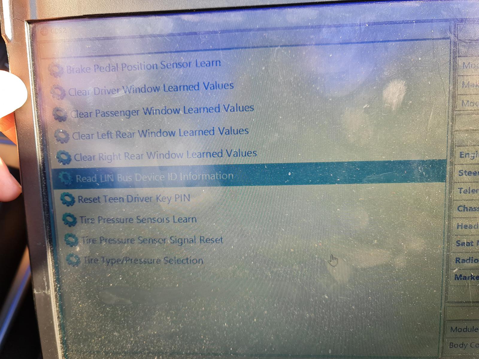

Fixed! Topic solved
Hello,
Thanks to the input from our colleagues raidaru and ejik418 we managed to find the root-cause.
All symptoms are connected:
- heating/venting not working
- unnecessary triple door unlock command
- driver's seat memory not working
The problem lies with the BCM and can be fixed with single command executed from diag computer.
Command is named "Read LIN Bus Device ID Information", this brings you to the list of modules but ignore them and go straight for the "Update" button - pressing it fixes all instantly.
I have attached photo from diag computer.
I hope it will help some other forum users (to avoid replacing modules or exchanging seats/modules with other working cars, or trying to look for error codes like 3 of us did).
Best regards,
Jarek
I am marking this topic as solved!

Thanks for getting back to the topic with the solution, Jarek. Makes even more sense if what happend was that a module got replaced (at some point) and thus IDs didn't match before you executed this re-read command.

In our case even after the module replacement of the module this command was not executed by the service people and problem remained (this was the case for ejik418 - until he went to dealer service) no errors were reported.

Tried that stuff that Jarek said it worked for him but I didn't get so lucky. After I execute that function it sends me to a sub menu of stuff related to windows and from there I can't do jack! Here is the vid https://www.veed.io/view/996f1e0a-11...6-172c9a20a10d
The update command at the bottom doesn't do anything?

Hi Raidaru,
I double checked with my electronics guy today - and just as Keko suggested - it is the "Update" button that does the trick.

Just a follow up. I did what Jarek recommended and have a diagnostic tool to go through the bcm update. It populated all the models and all system back to normal. Anyone near me needs help, DM me.
