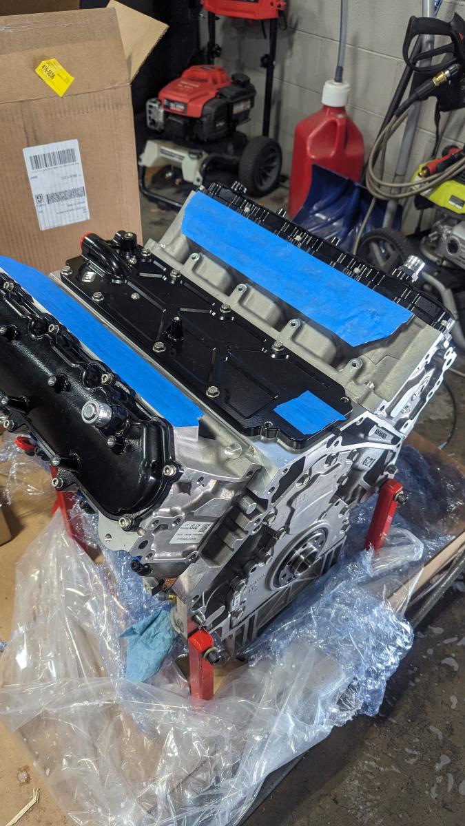

You're right about all that, but I think the primary message is that I was thinking that there's no way my OEM short block could last very long at my horsepower levels. So the only thing that I knew was broken was the harmonic balancer when I ordered this new short block. then after the new owner took it apart he found that in a quite a few things going wrong with it. Seized lifter, debris in the oil pan and all cooler lines, thrust bearing looks sketchy etc. I mean these short blocks from Chevrolet are great but they do have their limits.
This new 390 is just a much better engine. Also, solid harmonic balancer this time.

The shop took a better pic than mine

Have you sat the blower on it yet to see how that valley crankcase -12 clears the blower? What are you using to plug the PCV port on the blower floor?
No, but I can ask the shop to confirm that it clears. LME is aware that an E2650 goes on it so I assume they allowed for clearance.
LME just told me "no problem."
