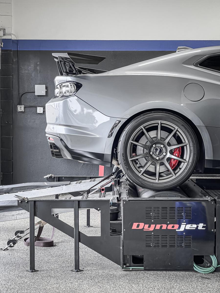

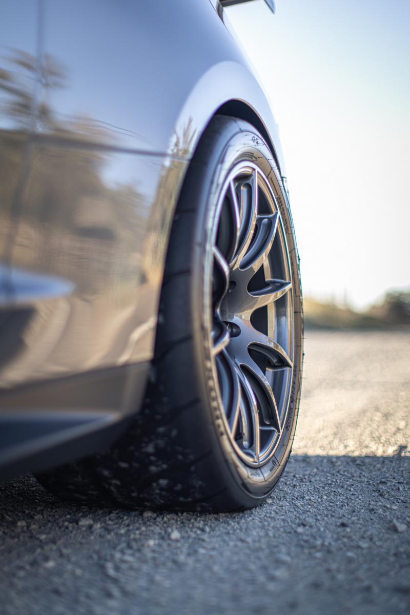

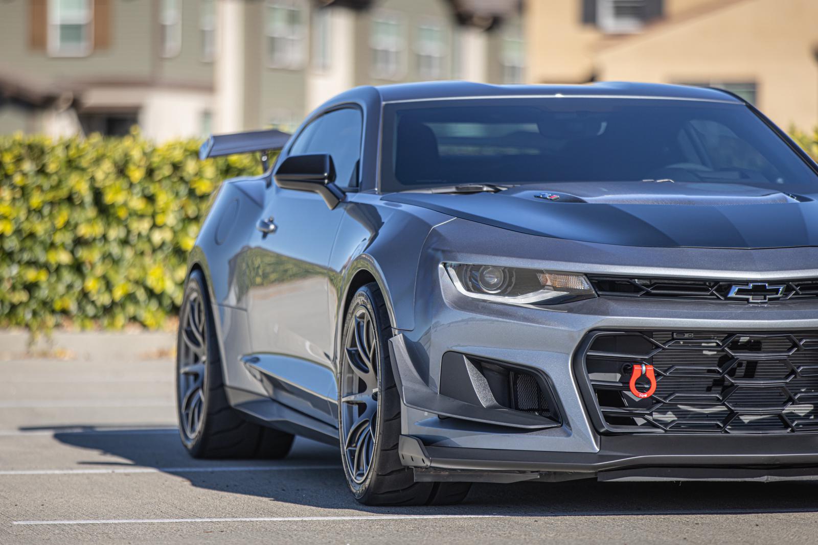

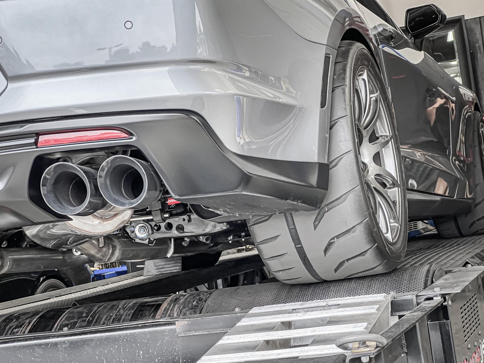

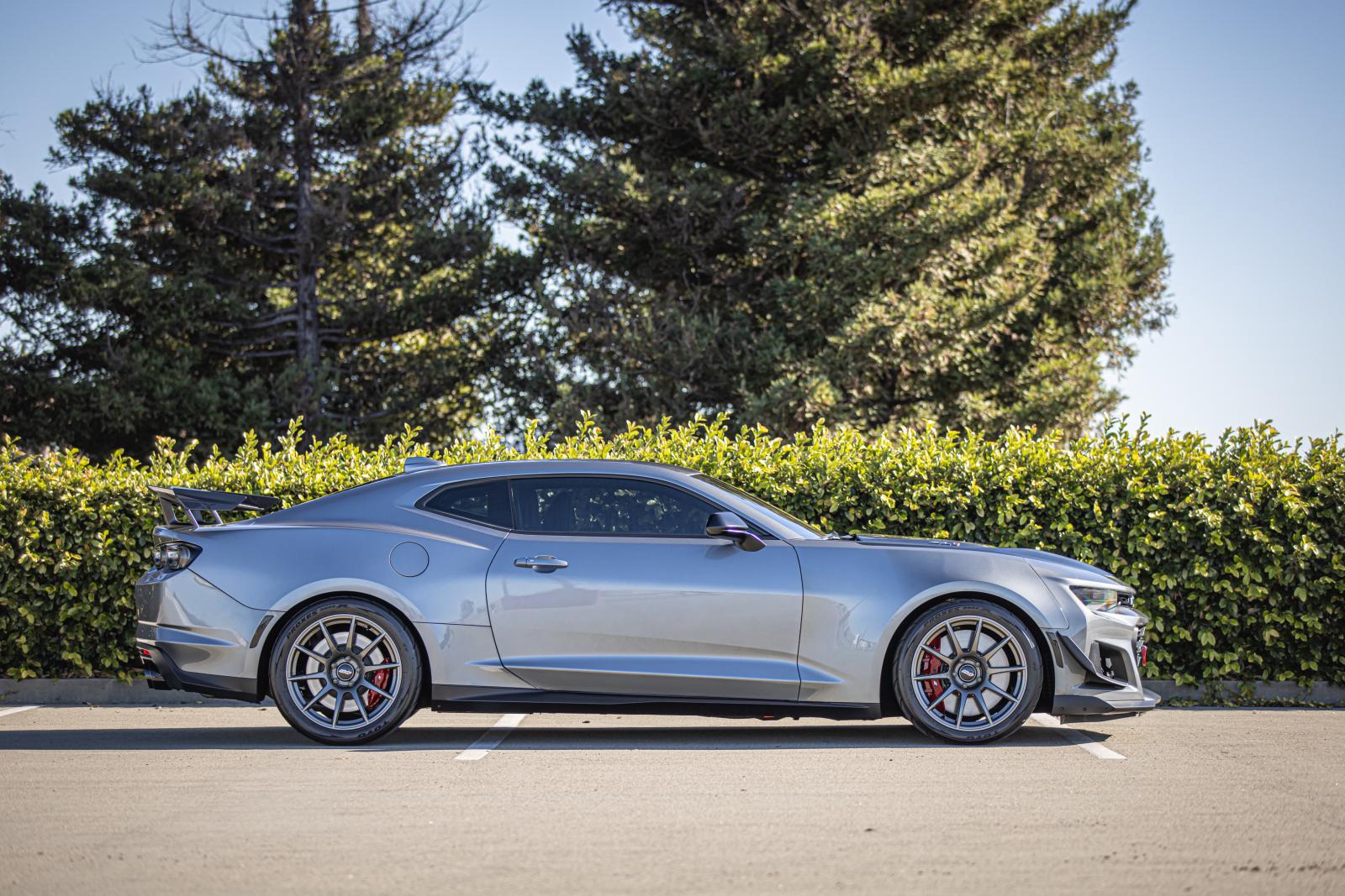

Worked for me... Although I upgraded to the APEX SM.10's the wheel sizes are the same...

Yes, same size as stock...
19x11 up front wrapped in a 305/30
19x12 in back wrapped in a 345/30
