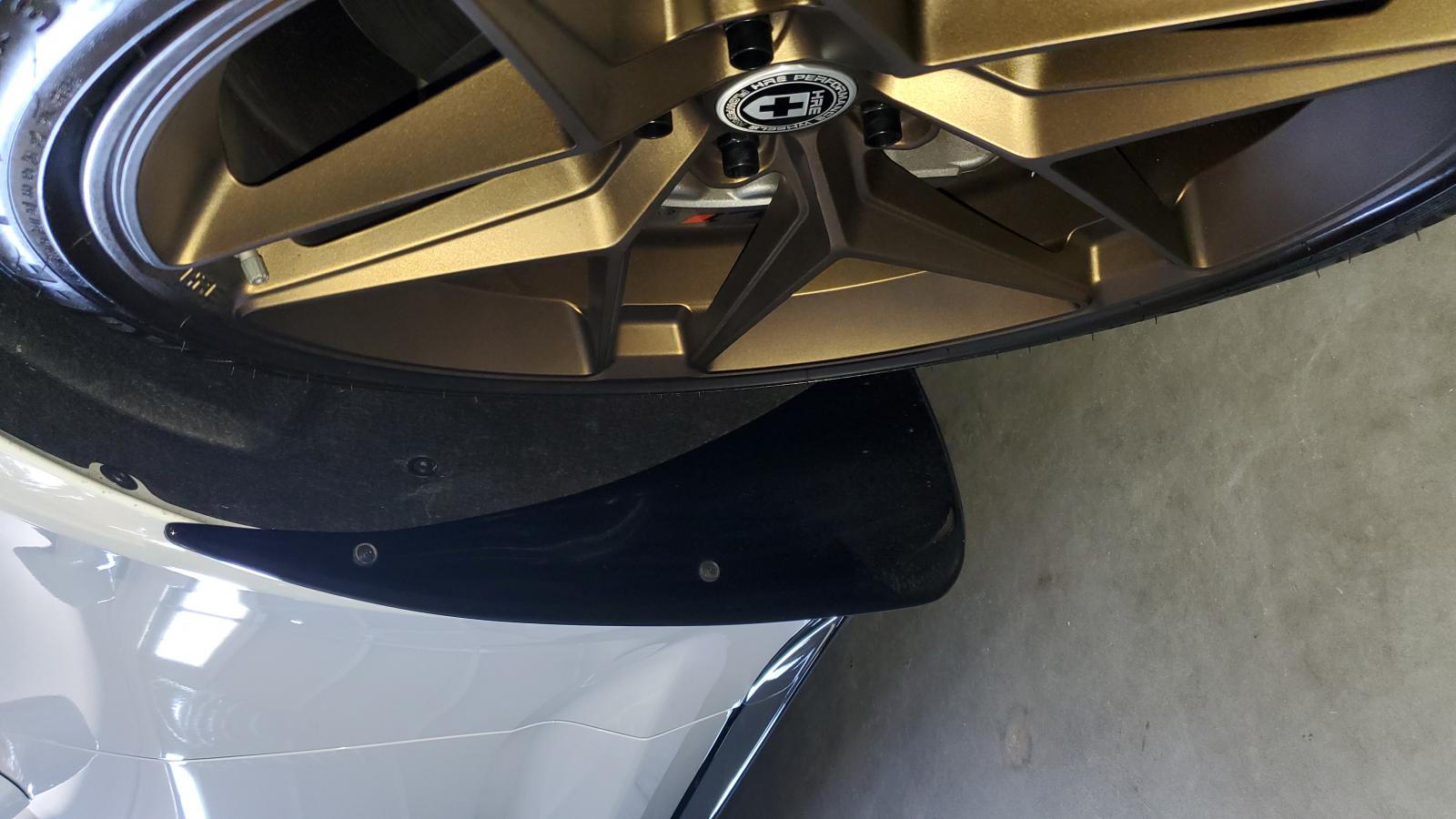

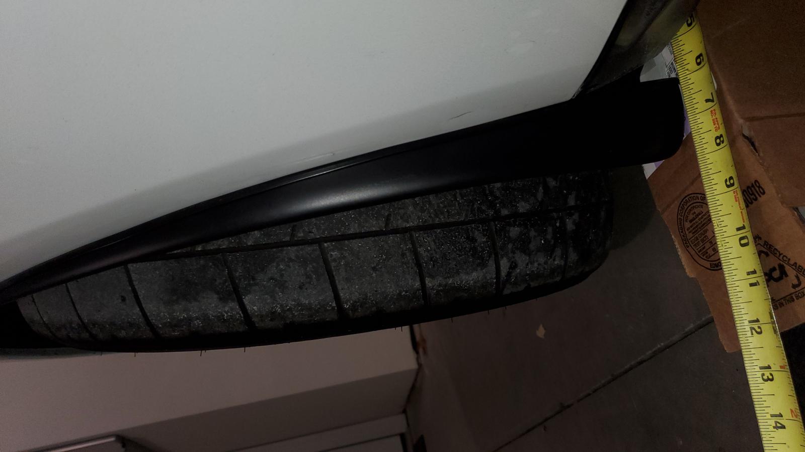

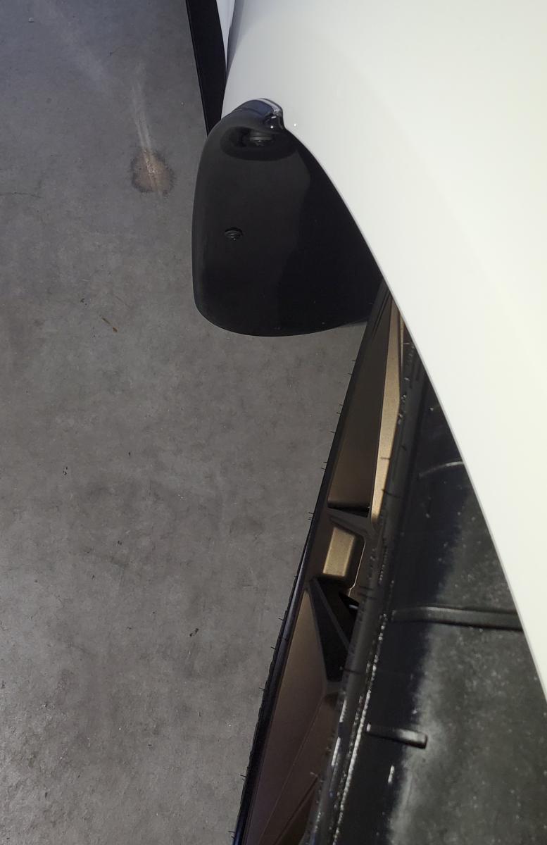

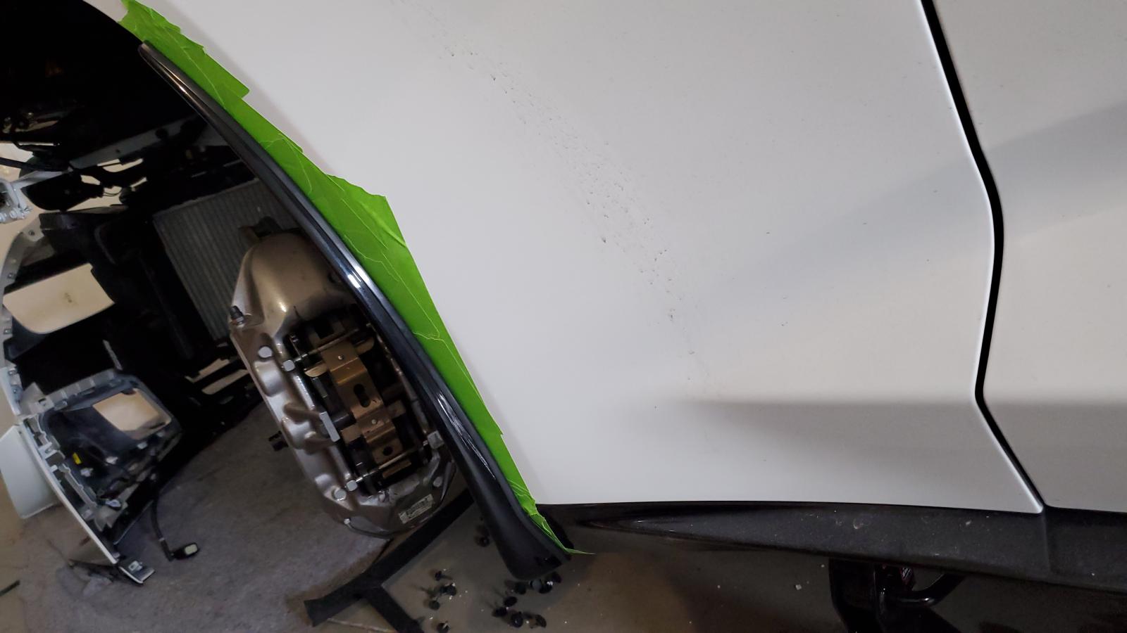

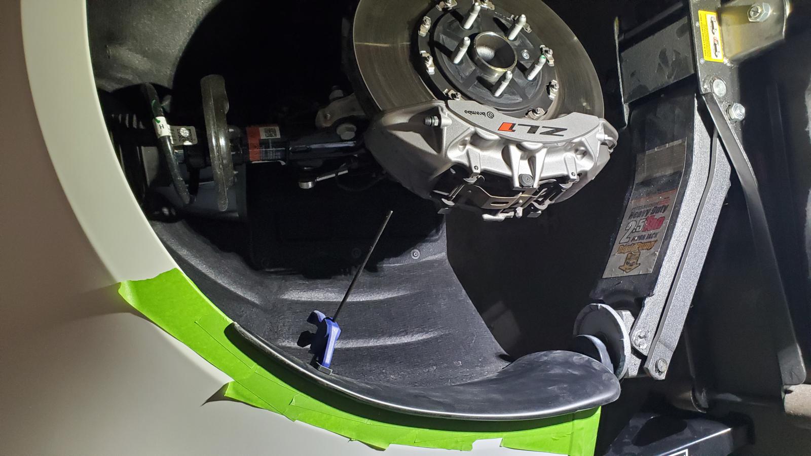

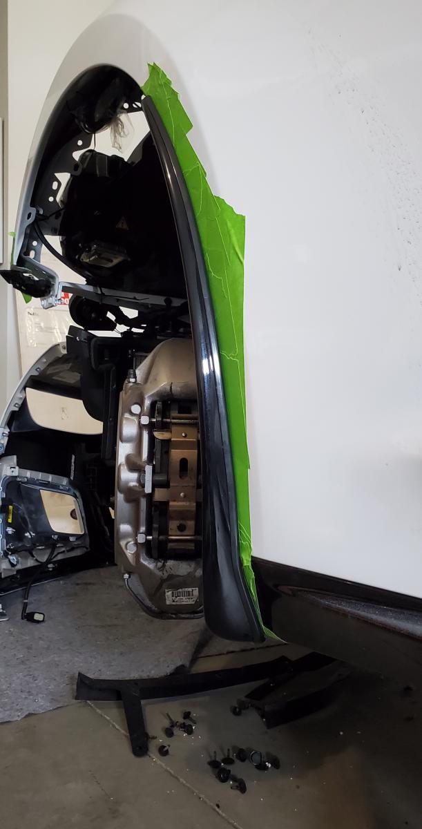

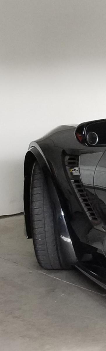

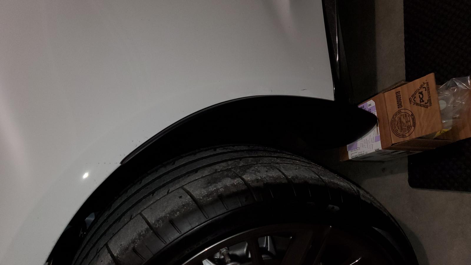

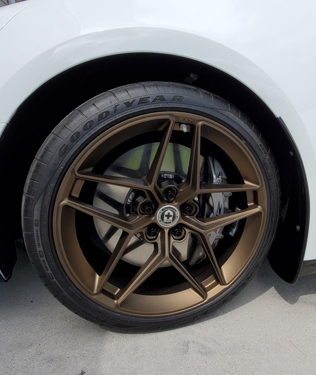

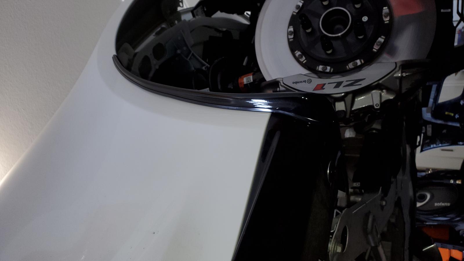

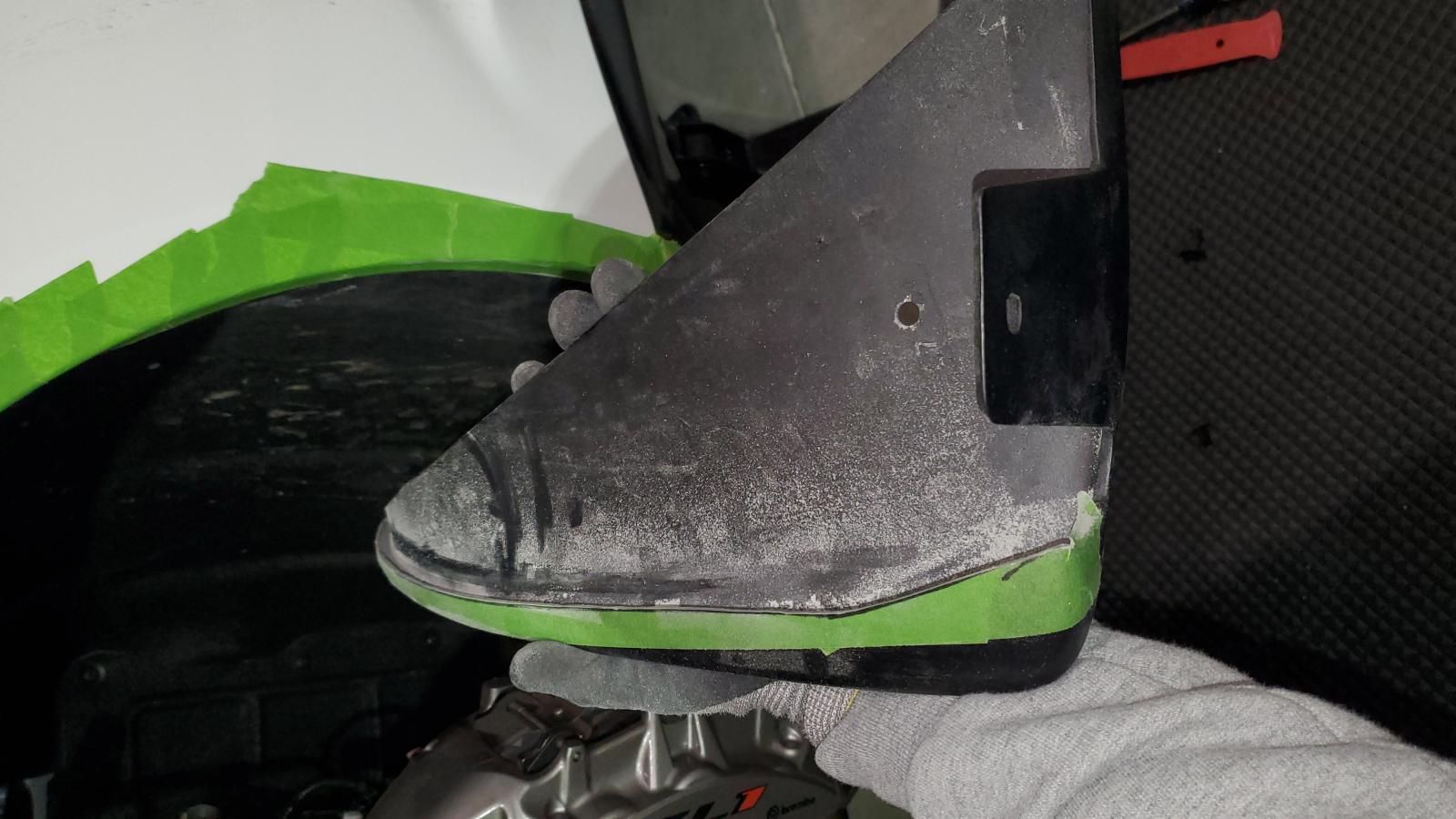

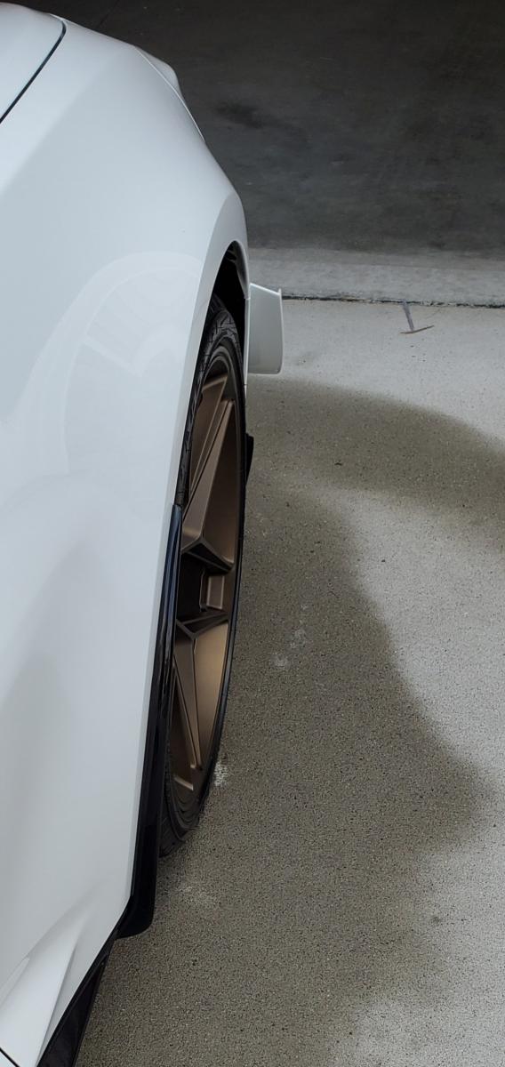

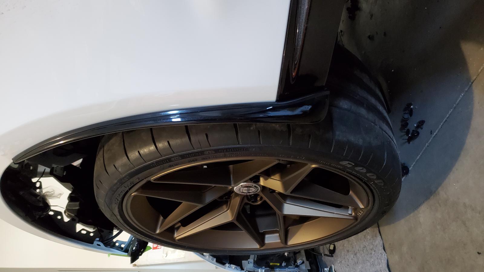

I've always had APSIS USA splash guards for my Corvettes , and was disappointed they didnt make them for the Camaro. After reaching out to Jersey they couldn't guarantee fitment. Did some poking around and found they have a somewhat similar wheel well. The fiberglass the splash guards are made of can be heated and allowed to become workable, so I took the chance and bought a set of C7 basic splash guards in Flat Black(still $250)..
It took time to heat up with the heat gun, measure, trim, and form, but eventually after they were painted Mosiac Black, I think they are really the best looking ones out there.

FF11s in IPA($500 upcharge)..I also had my buddy ceramic coat them. Wheel weights hadba hard time sticking lol. Had to run strips of Clear GORILLA tape over them to make sure they wouldn't come off again.
Bronze would look killer on your Red Z..
They look Killer in person in the sunlight too.

Not sure. I got these to move decently, but they can cool and crack too, so the working can't be too extreme. I dont know the curve of the rear ones. APSIS makes rear ones that would probably be easier to work with. They wont guarantee fitment, so it's a chance you have to take. Just keep waving a heat gun till it gets nice and warm. Trimming was required in several directions too.
