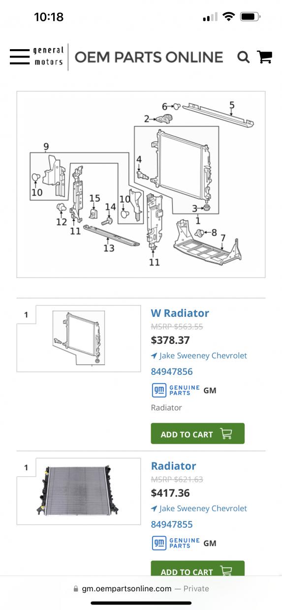

So the dealer cany get me in until the 1st.
I think this started after I went off track at willow springs. My engine cover does have a crack in it just before where this radiator is. Although it shows no impact to it, im wondering if I caused this? Anyone know part number for the big radiator (closest to the engine?) Might just have this replaced out of warranty.

Posts: 71
It should be one of these two part numbers:
Thank you man!
