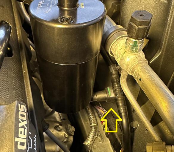

It is the same line no differences, my first pic has yellow arrow that points to the same OE connector shown in your pic.
You do not have to unclip the line. You simply take your finger and hold the line up and out of the way as shown in my second pic BEFORE lowering the can in place.
If you set the can on the line as shown in your pic then you will not be able to move the line. In that case, you need to remove can, hold line up and out of the way, then lower the can back in to place.
If you want to spend more money and exert more effort to place the can in a different spot more power to you...your money your car.
There is no reason to create an issue where there is none. The E2 kit is a quality product the way it comes and there is no issue with the supplied bracket.
