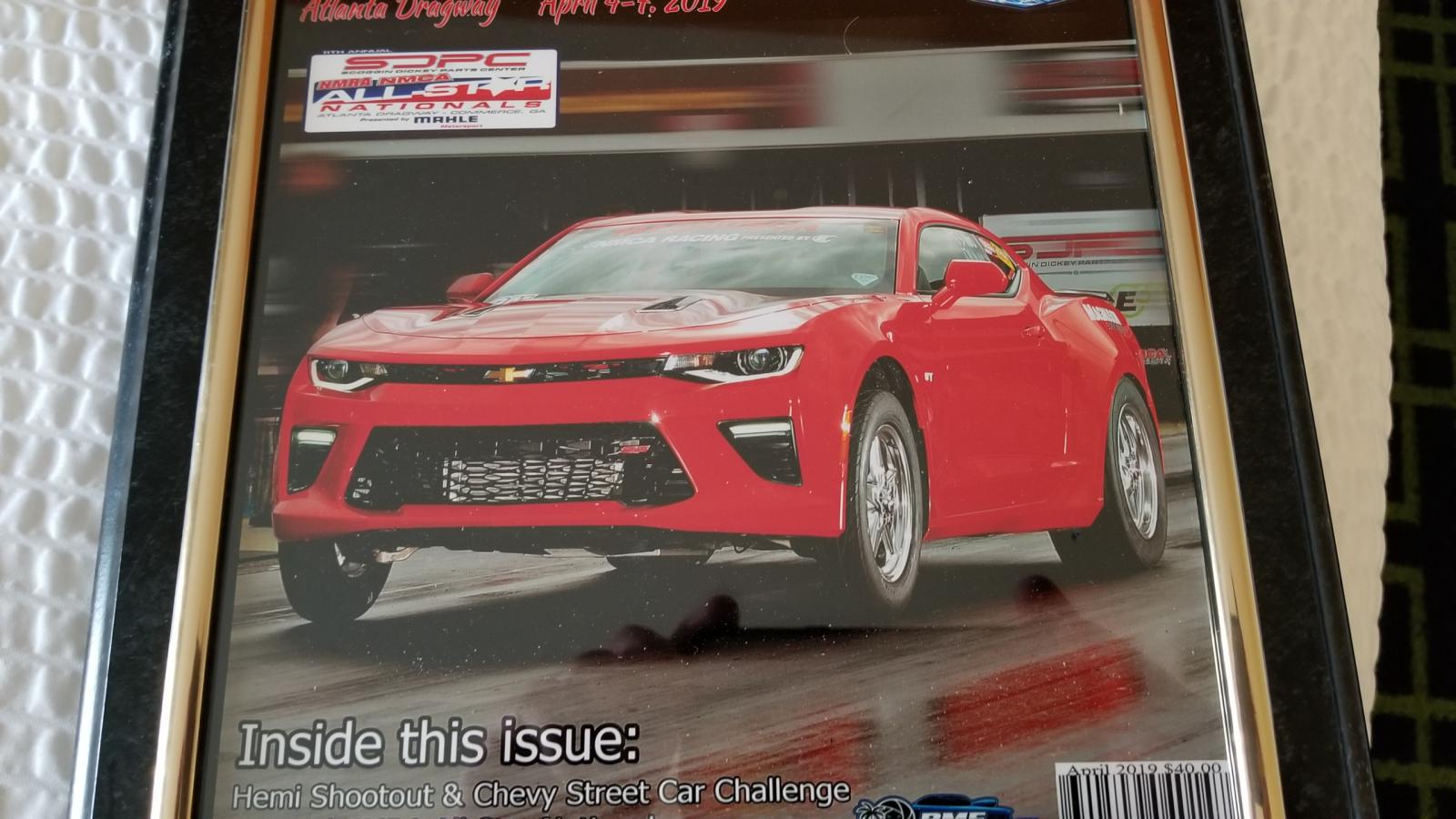

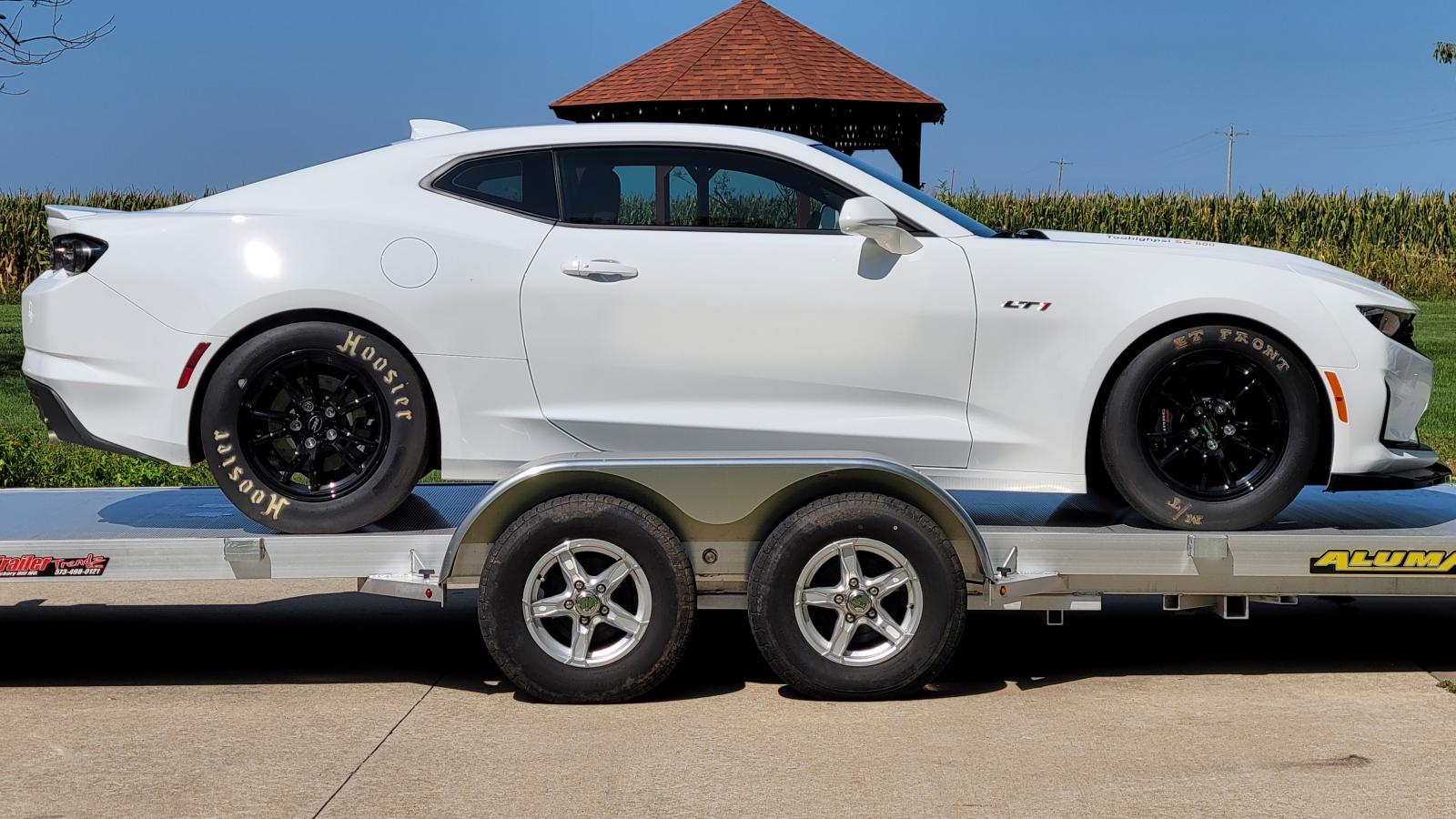

Or you could save hundreds of dollars and a bunch of weight and just seal your rear drag pack wheels as I have on my last 3 cars, my red car made 850 plus and never spun the tire on wheels, my white car made over 700 and my C7 which dead hooked on ever pass never spun a tire either. Mount the slicks or drag radials dry, air them up and balance the tires, make sure you mark the tire and the valve stem for perfect alignment. Break them back down and use Permatex High Tack Cement, comes in a small can with a brush attached to the lid. Put a nice coat of Permatex on the bead of the wheel and bead of the tire. Let them get tacky which usually takes about 20 minutes, bead them back up to about 35 psi. Let them set for 24 hours and your ready to go drag racing. I got this information from Mickey Thompson Tech and verified by one of the Kent's Hot Rod Garage who sells Race Stars which I used on my red Camaro and C7. I ran the RC Component Bandits on my White Camaro. But you can do what you want, add weight and spend more money. According to MT and KHRG they have plenty of 1000 hp cars using this mounting/sealing process instead of bead locks.

Both of those cars looks really nice Laynlo!!!!
