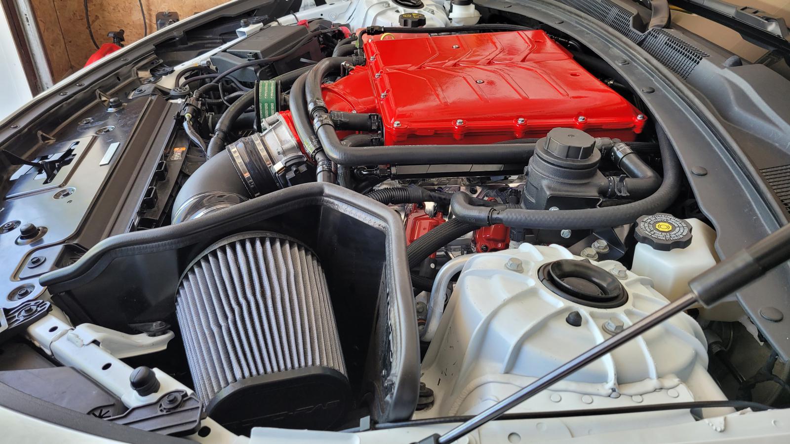

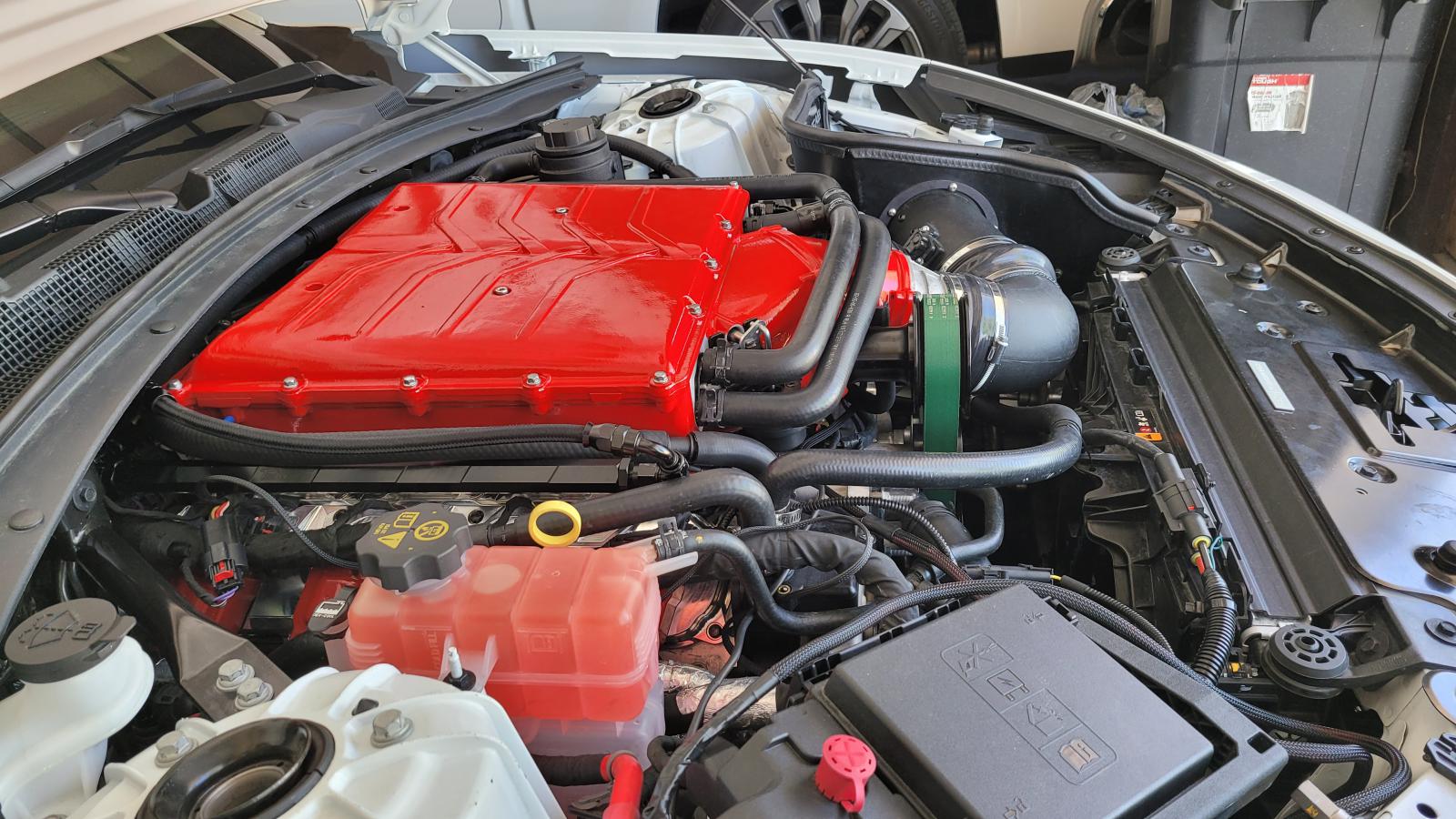

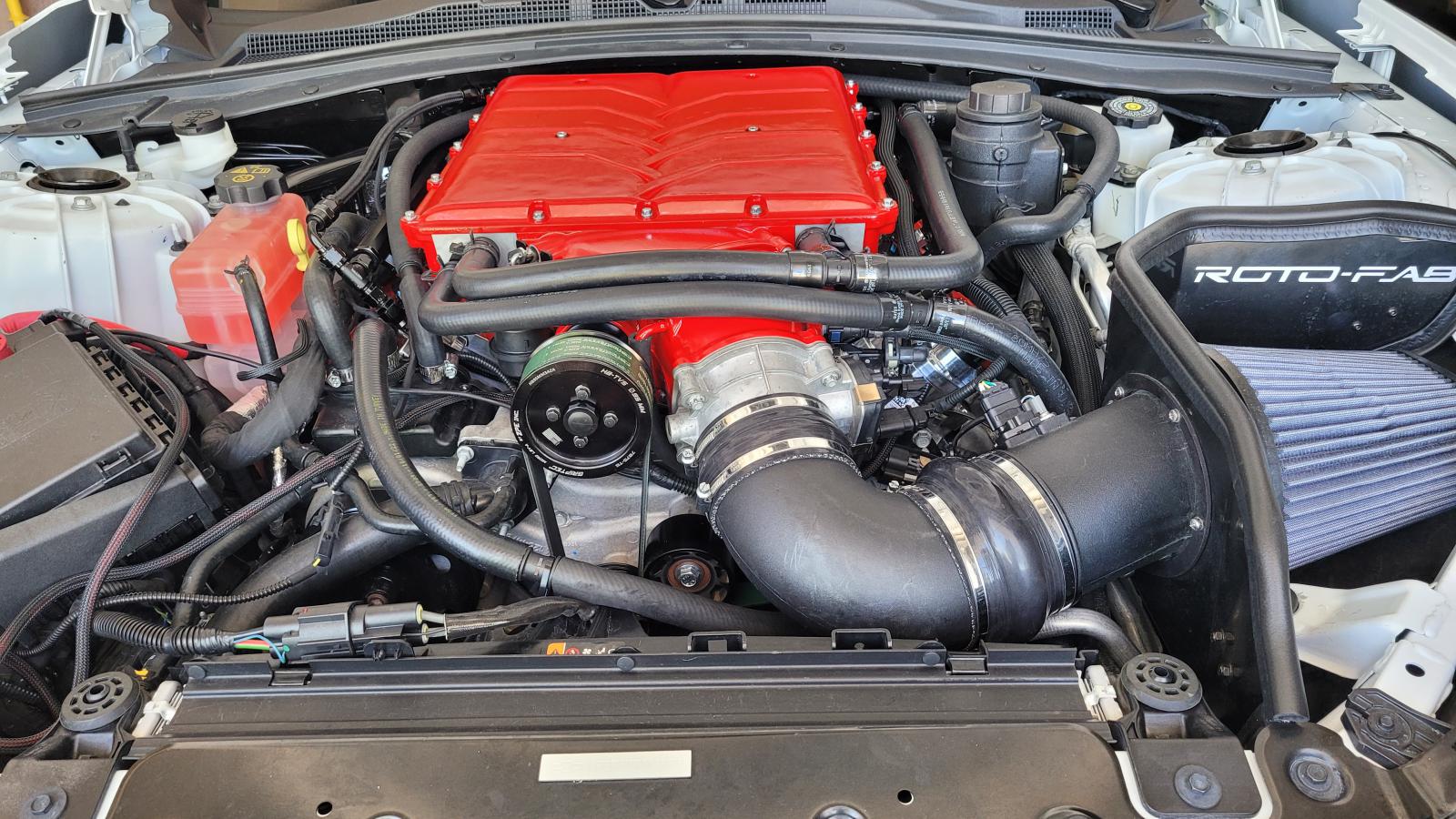

Looking good, remember to increase the hose sizes on your PCV system.
