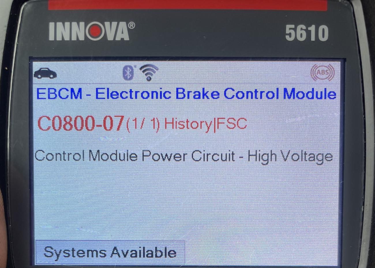

Elusive stabilitrak problem
I have been getting a “service stabilitrak” message for some time now on my 2018 ZL1 1LE. Usually it happens under hard acceleration. Yesterday, it came up under light acceleration, stayed illuminated longer, and I could hear my exhaust tone change as if the valves were opening and closing or the engine was surging. I did not feel any surging, though. The A/C stopped cooling for a minute or so and then it went back to normal. I drove it today and can’t get it to act up again. No codes were set. I have heard that throttle bodies sometimes cause issues like this? Car is cammed and tuned but throttle body is stock. I don’t want to go buying parts without some idea what it could be.

Check your battery. Most of the problems when you see that message is the battery going bad.
Cars these days are dependant on a good operating battery. So I'd start with that first.

If the car has headers, check the pass side harness for burns.
Put the battery on a tender for 48hrs. If problems persist, find the best automotive electrician in your area.

Found some codes in the BCM, cleared them and then went for a drive to get the message to come up again. Checked for codes and found these. I’m guessing it could be the voltage regulator. Might need to replace the alternator. Wish I knew for sure, that job is a pain. Might not be so bad with the BMR motor mounts.
Do take the advice above and get a new battery before exercising more expensive options. I'm speaking from experience.

Update - it was not the battery, it was the alternator. I’ve had battery issues in a Gen 6 before, even from a brand new Optima battery which I found aren’t what they used to be. I agree there are a lot of battery related issues, but it turned out that this wasn’t one of them.
I found the problem by reading the BCM codes indicating high voltage, and my service manual indicated that the codes meant a problem with the charging system. Battery voltage on my Aeroforce gauge was bouncing all over and going as high as 15.5 volts.
After getting 2 damage alternators from GM I finally got a good one and installed it. The packaging they put it in is totally inadequate. Working great now.
