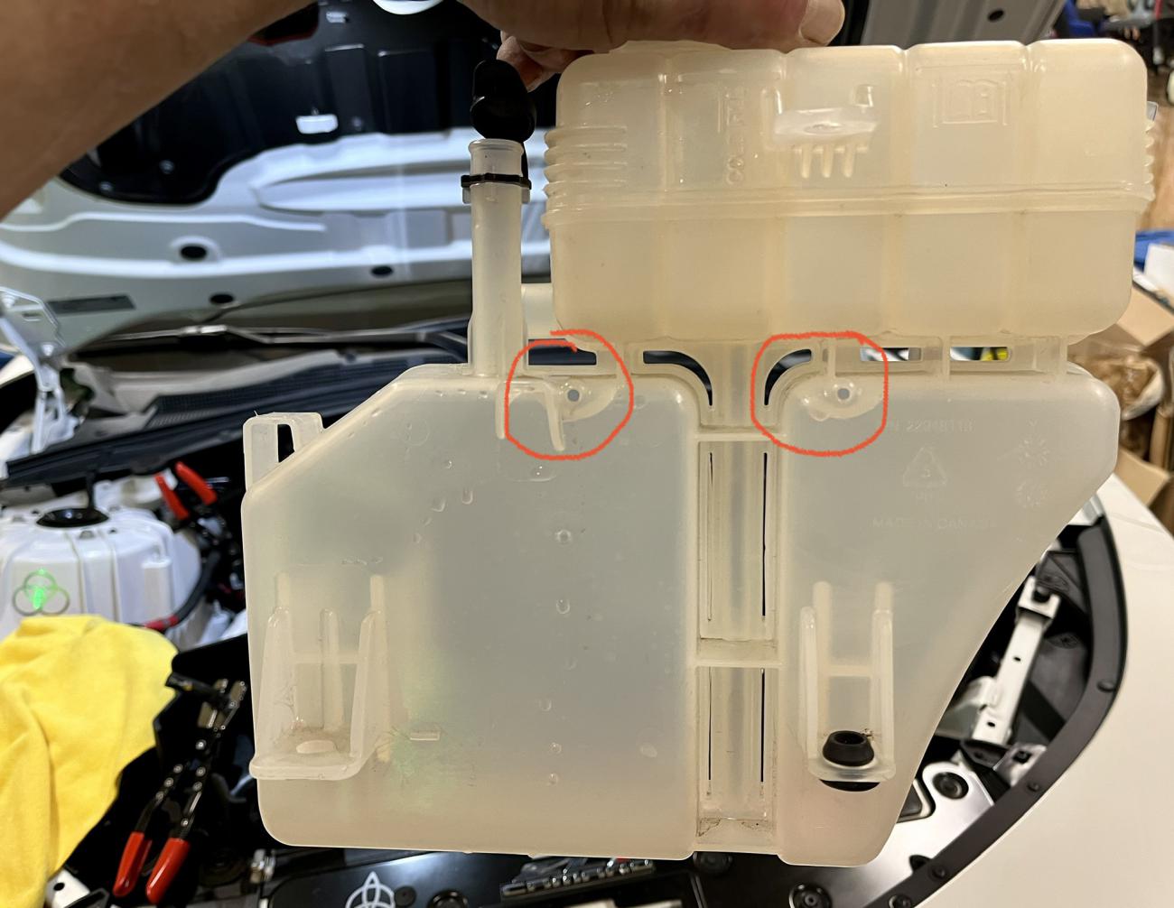

Old 12-01-2023, 05:10 AM   #25
CalgaryZL1
CalgaryZL1's Avatar
Drives: 2020 Chevy Camaro ZL1
Join Date: Apr 2023
Location: Calgary Canada
Posts: 1,652
The lower tank has vent holes in it, which contributes to evaporation over time.
...and why you may smell a bit of coolant smell underhood especially after running it hard.

Ah this is some good info. I appreciate it all i never seen those holes. But how much evaporation is normal? Id think this would evap the same as my SS. Granted these cars do get pretty hot in the engine bay. So zl1 owners how much coolant do you normally go through?
I followed up with the dealer and waiting for their response today.
