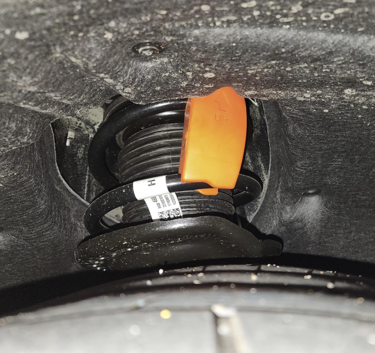

Yeah, they're supposed to give them to you after they remove them. On my car, I looked for them in the trunk and in the glove box and didn't find them, so I looked at the front springs to see if they had even removed them. There they were.

Just lean over and look inside the front wheel well above the tire. You'll see the coil spring and you'll see them if they're there.
With the spring spacers installed, the car will ride harshly and the front end will sit higher than it's supposed to.
