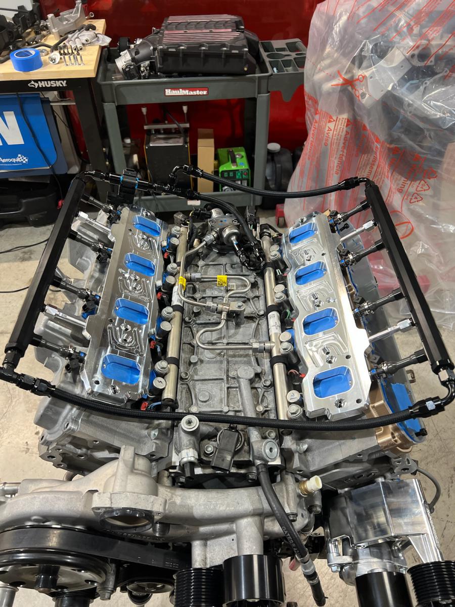

Here is a good picture of my setup on the Camaro. I'm assuming you got hold of Mike to talk to him, I told him you'd be calling.

Attachment 1140235
We shared a few emails while they were at SEMA this last week and he pointed me to the install doc on their page of your build. I purchased everything he had listed used on your installation. The only thing that's missing from his documentation is the length of each cable. From the pictures posted I was able to determine which fittings were needed for the ends of the lines and put those together and labeled them accordingly. Just patiently waiting now.

I'd probably wait until you have everything in front of you before trying to make the fuel lines.
The fittings aren't really reusable once you've tightened them down on the fuel line. Sure you can probably "get away with it" if you make one wrong, but fuel's no joke... and those things are expensive if you make one or more of them a little too short or long.
So if it were me, I wouldn't pre-assemble anything. Even as little as a 1/2" off in length can be a big problem.
I didn't record the lengths on mine or I'd give them to you, and given that a minor variance can be a problem, i doubt I'd be able to get you completely accurate lengths if i went out and tried to use a tapemeasure or something.
All the fittings I had were reuseable, just don't over tighten them. Mike actually built mine that's in the picture and shipped it to me unassembled, I put it all back together at least twice, once with the original blower and after it was rebuilt at SCOL I put it back together again. Maybe you bought different fittings then I had, not sure why you think they can't be used again.
Im talking about the side of the fitting that crimps the hose. For the ptfe hose you have to buy new ferrules once the hose has been installed into the fitting and tightened. And even with anti-sieze the threads on that side start to get a little rough after a full tightening and removal.
The other end of the fitting can be installed and removed onto another connection many times without issue.
