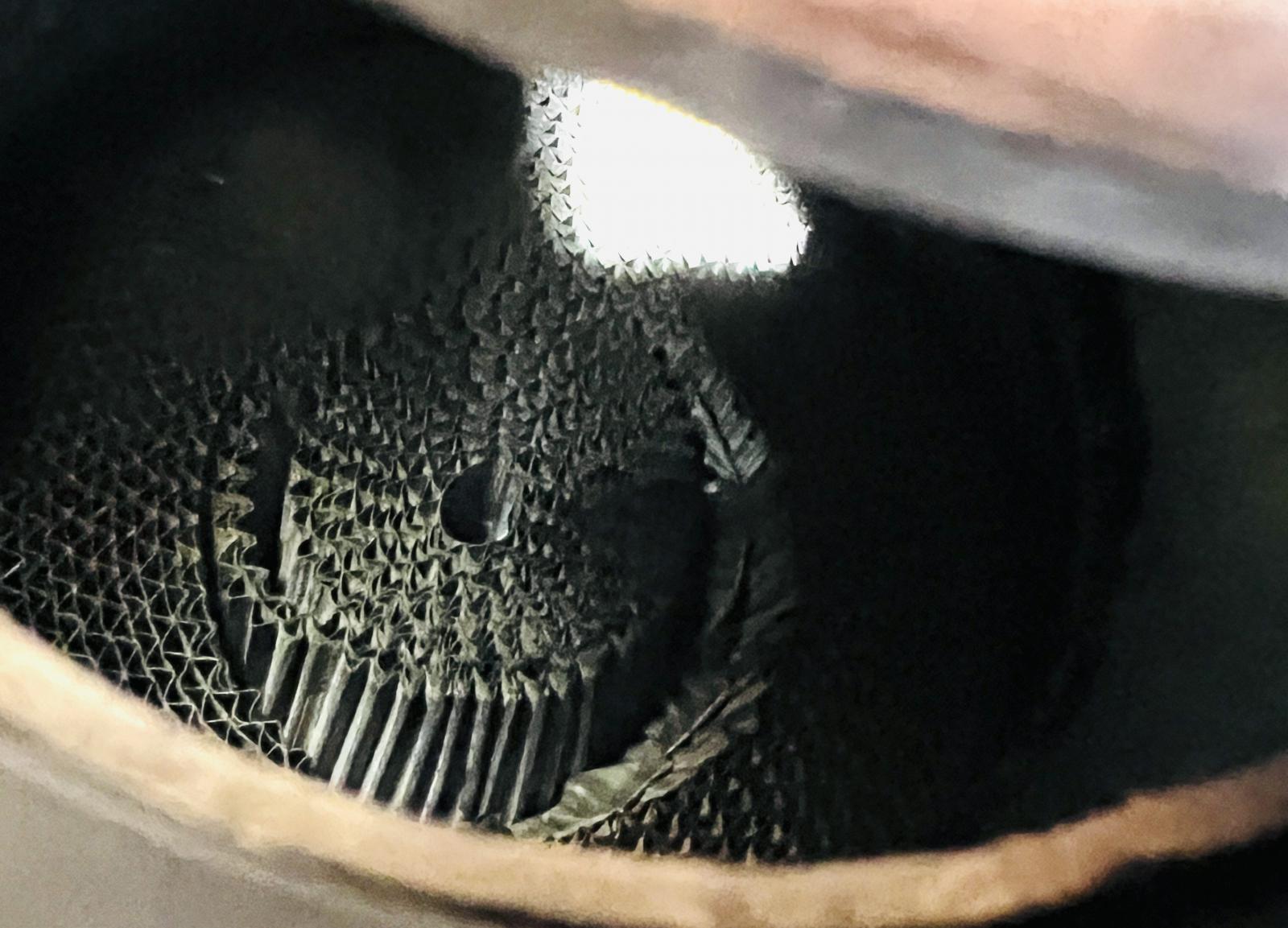

Hey TEAM, So I wanted to share a recent close call I had.
After watching CSP's recent interchiller video, where he was hyping his 4.5" OD GESI Gen2 cats... I gave them a call because I could not find them on their website, and was curious if any power gains could be expected... After discussing my application, and telling them that I am still running the HF cats that came with my ARH kit... they stopped me and said WTF! You better take those ARH cats off ASAP before it's too late. Worried, I found this thread, and decided to crack open my Vbands to take a look. I was feeling good, after finding that my passenger side was perfect, then sad to see that my driver side is fu*ked :(
Note: this is only after 3,500 miles!!!
So, I am going to make some custom off road pipes with V bands... give that a try, and if its too loud, them I will order the 4.5" OD GESI's...
Stay tuned
After watching CSP's recent interchiller video, where he was hyping his 4.5" OD GESI Gen2 cats... I gave them a call because I could not find them on their website, and was curious if any power gains could be expected... After discussing my application, they stopped me and said WTF! You better take those cats off ASAP before it's too late. Worried, I found this thread, and decided to crack open my Vbands to take a look. I was feeling good, after finding that my passenger side was perfect, then sad to see that my driver side is fu*ked :(
Stay tuned
So what cats were you running that fell apart?

They were the HF cats that came with my American racing Headers :(
You should have stated that in your prior post because it reads like you are implying the GESI Gen 2 4.5" cats are the culprit....which had me scratching my head. The ones that came with your AR headers I don't believe are the same. Honestly these high-end header companies need to start offering the Gesi Gen 2 4.5" for forced induction applications imo. Standard high flow cats and cars >700whp is No Bueno.
