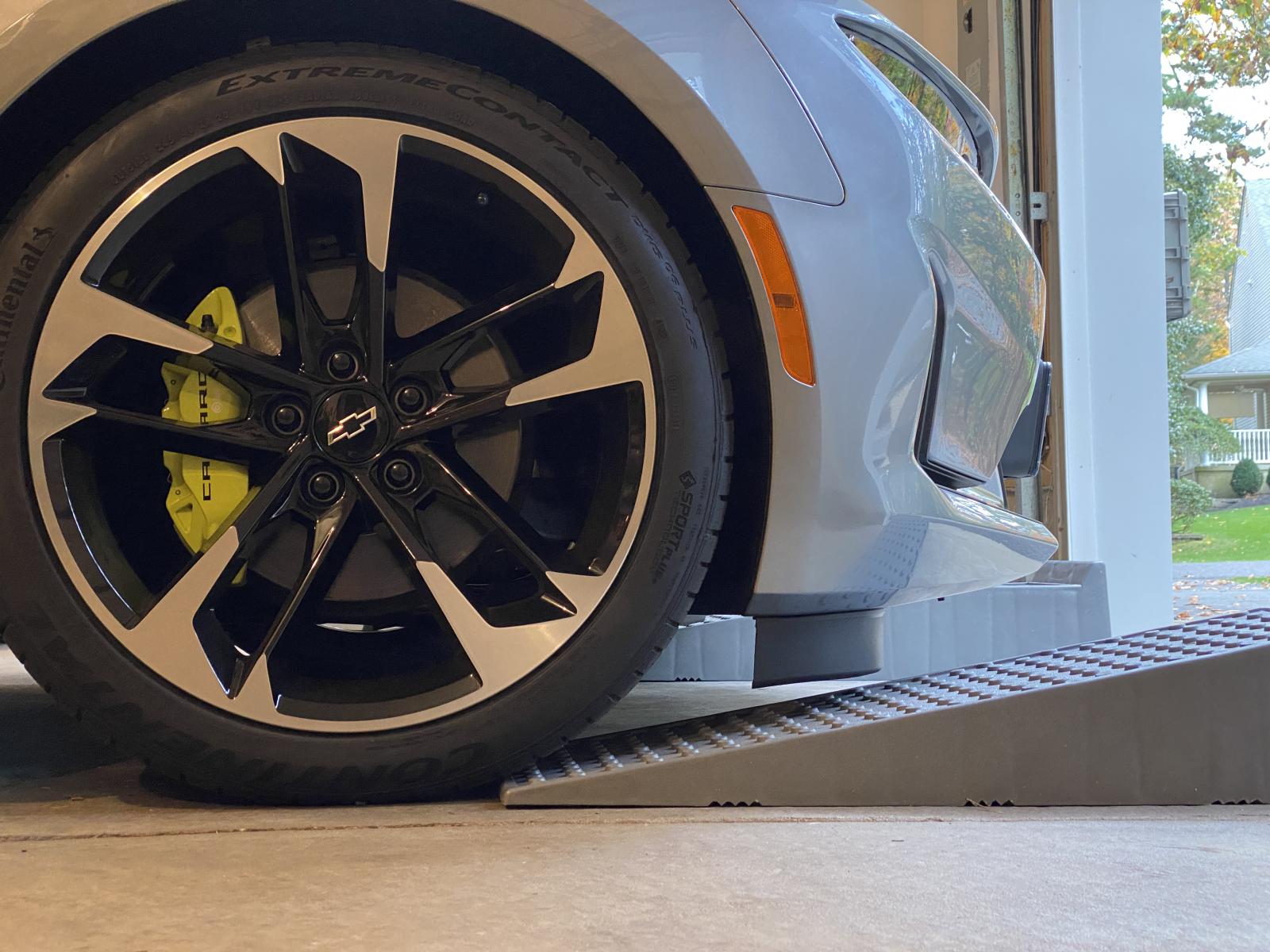

Bob's Industrial BIS-0777 to the rescue!
I spent some time researching the different ramps. I foolishly purchased Rhino Ramps as they advertised they were good for lower vehicles. Turns out the 17° is not adequate for my 2023 2LT Convertible. After doing a little math, I figured out I needed more like a 10° angle in my ramp... well that's going to cost between $160-$500 plus tax.
I found Bob's Industrial Supply ramps... they are great! At the time of my purchase, they were selling at Amazon for $160 plus tax. But right now they are a little cheaper... here is the Amazon link.
https://www.amazon.com/gp/product/B0...E7U53NWQ&psc=1
But I got mine from Woot! for $102.99 + $6 shipping (free shipping if you're a Amazon Prime Member). These are beefy stands... around 18 lbs each, and support 5 tons each. Jump on the Woot! deal if you need a nice pair of stands, with no futzin'.
They stand up nice on their own as well... or you can hang them by a strong nail or screw in a stud. The ramps have hanging holes but you'd have to drill through the rubber feet if you wanted to hang them flat against the wall.

Interesting to see this thread revived this morning. I also have a set of 67 inch two piece Race Ramps. Yesterday I was going to put the ZL1 up on them to check out the underside of the car and to install the ZL1 Addons jacking pucks I just purchased.
However, the front or lower portion of the ramp would not fit under the car without hitting the rubber spoiler under the car. So I didn't try to force the car up the ramp. Do you have this issue? I'm considering purchasing some Race Ramps Extenders to further reduce the approach angle. I've never had an issue with my Race Ramps rubbing before.
