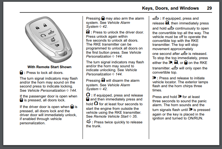

Doesn't one have to actually *hold* the start button, until it starts? That's how it works with mine, which admittedly is not a ZL1 and is a year older.

This sounds like it may be the issue, unless the reference to a double tap was just a typo in the description of the problem. Double tap is for the trunk button, but the remote start button gets held down (worked this way for both my '16 and '21).

Yeah, you gotta RTFM

Mine I have to Hit the lock button once and then hold the start button for 3-4 seconds.

Even though the FOB is sealed the contacts and buttons can get sticky causing intermittent operation. In your case I'm wondering if the buttion was "sticky" enough to see the double tap as a single long press. Maybe the temperature has changed or the debris has moved enough to now register the double tap as a double tap. Did you confirm that when operating the remote start per the manual, that it actually works?
other RS inhibitors are Oil Life monitor percentage, oil pressue, unlatched hood, too many concecutive remote starts (you get only 2), vehicle not in Park (gm has had issues with the selector sensor), the "spare" FOB is in the vehicle. I'm sure there are others and all of these may not apply. Some of thes may not provide direct feedback to the operator that they are inhibiting Remote start.

Put a fresh battery in my primary fob. 1 tap of the lock button, 1 tap & hold of the push start button, fired right up. Not sure what was going on. Like I said I've had the car for almost a year and never had any issues with the remote start until now. Nonetheless, I appreciate everybodys help and input

The sequence for most remote starters is hit lock, then start with a long hold. I have noticed If you’ve moved the car, for example pull it out of the garage and shut it off without driving it sometimes it will not remote start until it senses you’ve travelled a distance, some sort of a reset I guess. The same thing applies with my truck
