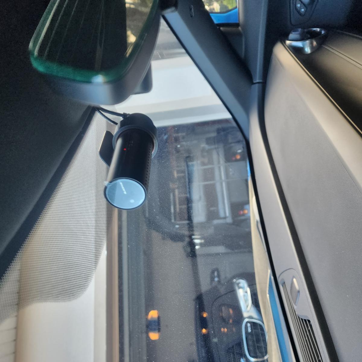

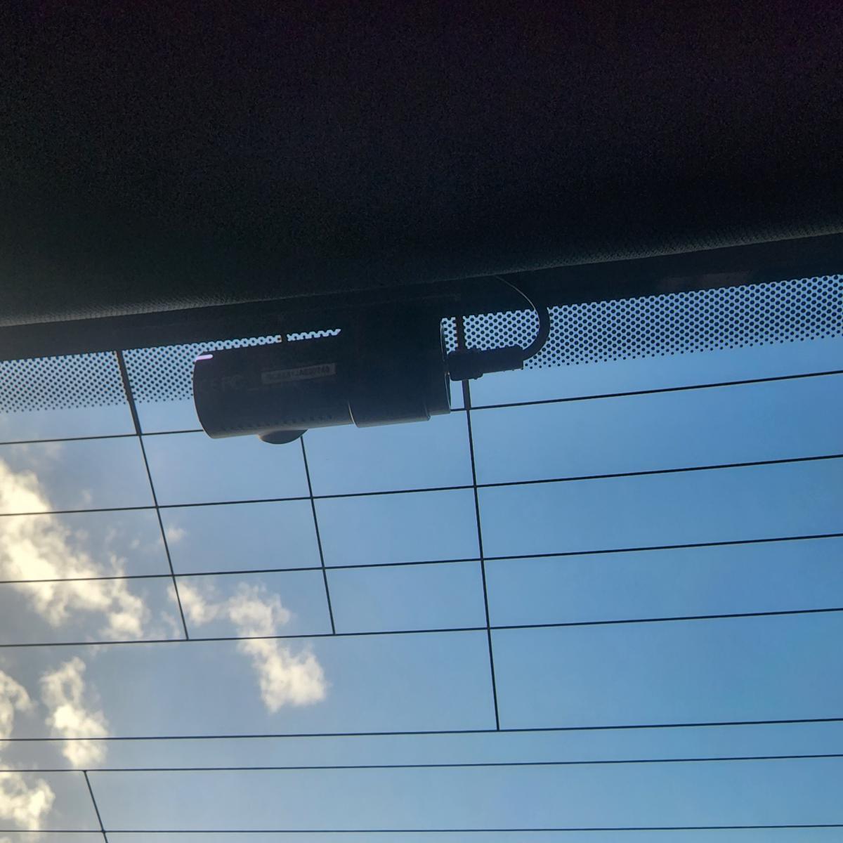

Gen5DIY has a harness adapter that plugs in under the pass side foot well (blower motor IIRC). Ran mine and my front cam is not visible when driving (sits behind rearview mirror) and I dont even notice the rear cam (Blackvue) was able to hide all the wires as well. If I had to do it again I would install the rear cam upside down and invert the image so the plug for the cam is on the pass side not the driver side as shown
EDIT
IDK why the first pic is 90* off, looks ok in my folder LOL
