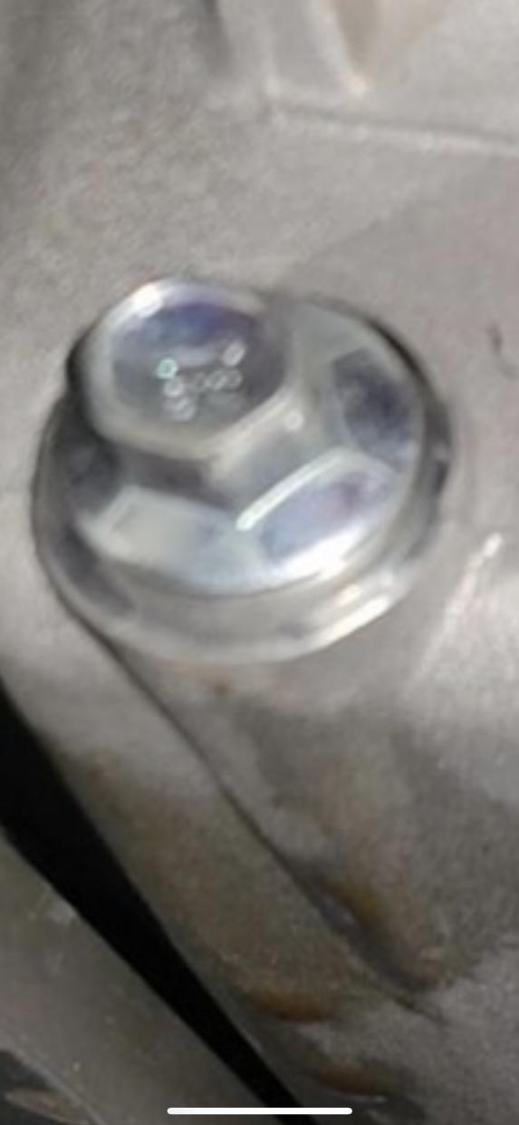

Originally Posted by CalgaryZL1 View Post
This time the oil looks like it’s running down from above, if you look close by the drain plug it looks dry around it
Dry stain around the plug then?
I can't be sure. either way, looks like a leak!

Posts: 1,653
If this is what a dry stain looks like then yes! Do you see much oil leading up to the drain plug? To me it looks like the oil stops at the lowest point of the oil pan which is just below the drain plug.
So, yeah, a blurrier picture might help
I would think they would put dye in the oil and then you could shine a light from the bottom and see if this is dripping from topside.
