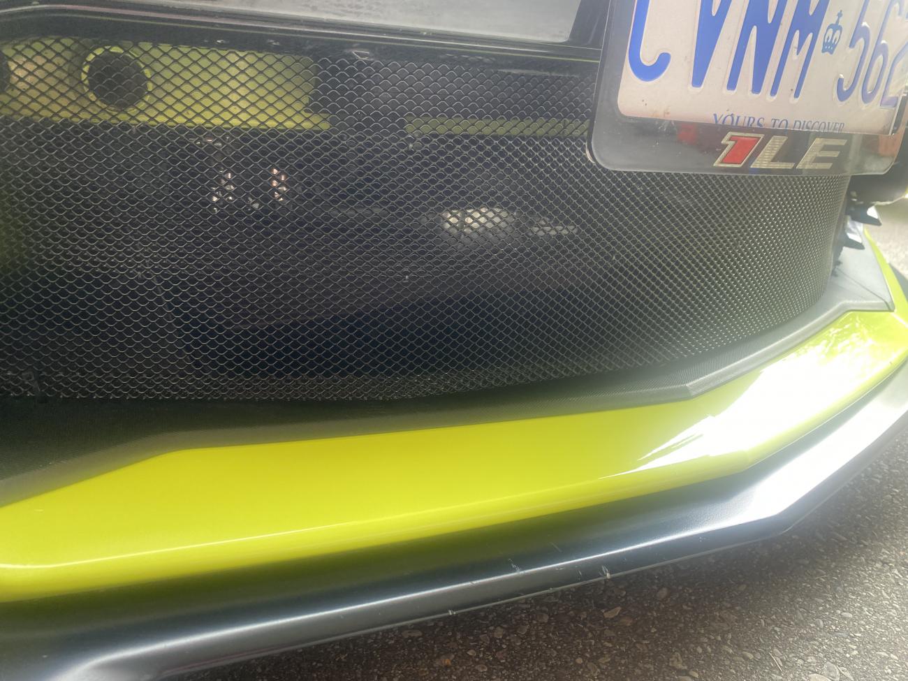

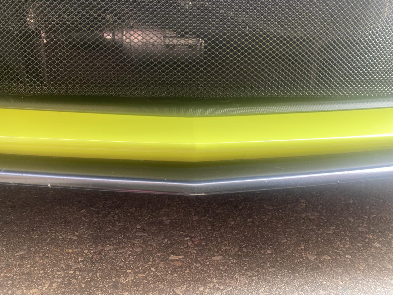

Okay getting some results with temperature in the 70’s now. Pretty sure I saw Complete Street Performance going the 40’s & 30’s.. The bigger pump helps the flow but I am thinking of wrapping more hoses especially near the engine to help.

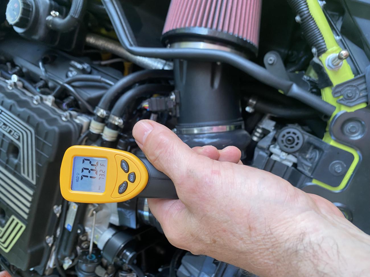

Had the car out for a 15 min cruise and let it idle for 10 mins then took the temperature on the cold line to Supercharger 73.2 F. I did read once in the 60’s.
Added a pic of the front grille and you can see the bigger PIERBURG CWA400 behind a custom grille I made. I decided to make 2 clips on the bottom of grille and 2 clips on the upper part so at the track I can just unclip the grille for better air flow into engine bay. Also I now have lower access to chiller and pump without taking off the front bumper.

You’re getting there…! Are you 100% on the refrigerant charge being spot on?
That’s my next move after I wrap some more lines, the shop where I do the dyno recharged the system. What’s the coldest freon I can get? Will have to ask what they use. Anyone with a chiller no the correct charge weight of replacement Freon? They didn’t no the correct number and didn’t want to over fill and then cause the compressor problems. So what is the required charge weight, no idea?

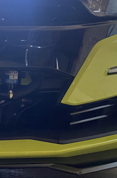

I'm not a car ac guy but 50 years in the commercial/residential end. To my knowledge 134a is the only refrigerant used in late models. The charge is probably in the owners manual but when you add something in the system like longer lines or h/e then you need to add more refrigerant to fill it enough. That would be determined same as engine tuning according to conditions. Pressures and temps should be the same as stock.
Nope, the Gen6 Camaros run R1234YF refrigerant not 134a. I’ve heard rumors that you can evacuate the system and run 134a in its place but haven’t tried it personally. I believe with an Interchiller there is a sight glass that you use to determine if the charge is correct.
Yes you’re correct about the sight glass, I forgot about that. I will watch the sight glass to see if there is any bubbles in the system. It’s behind my pull out grille, so coming in handy already. I need to see at a shop that specializes in AC to get there opinion if I can use a better/colder Freon.
