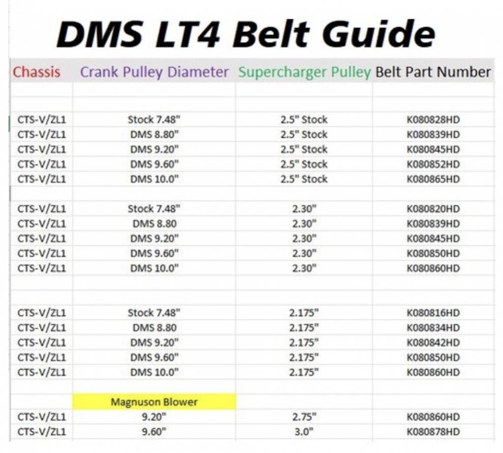

Anyone run a 2.40 upper with a 9.60 lower and have a ported blower? I know the combo is pretty aggressive for stock blower. Was wondering if anyone has the belt size for the particular combo as well.
I only run a 2.4 upper and a 9.17" lower.... peak boost is 13.5
See graph below from DMS...
