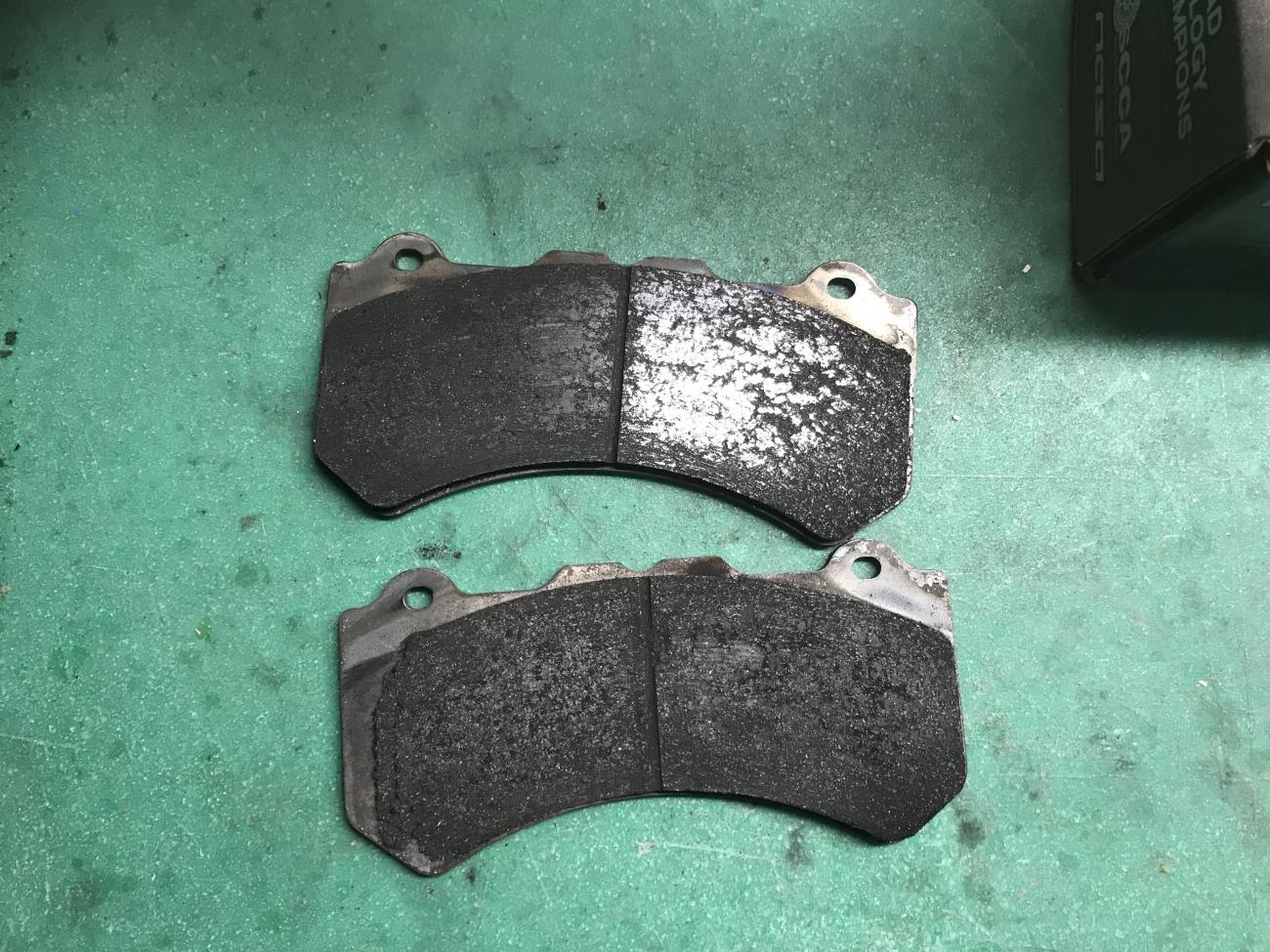

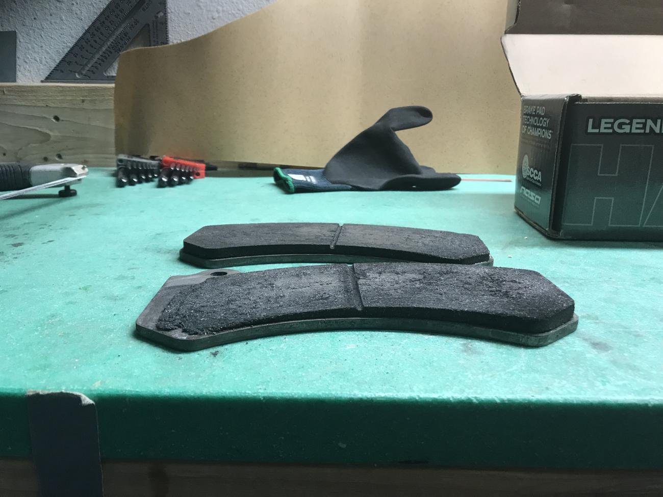

Also be wary about pad taper. I pulled mine off the night before a track night event just to check. The front edge looked ok(5mm) but the lower edge on the inner pad was breaking apart. Always double check.
Not sure why it was so tapered…. I might need to rebuild a caliper or replace some seals….
I too have experienced this. Swapping pads side to side after each event helps.

Every set of front pads I've had since the begging develops a taper. I swap them left right or inside/outside to even out the taper. Seems to work pretty well most of the time.
That taper shown by Eimarshall is pretty severe. I wonder what mine would look like if I didn't rotate them.
That's some severe taper for sure. Mine have a touch but nothing like that.

You can't hear the warning squeaker tabs while the brakes are hot anyways and they don't hurt the rotor when they touch it. You do have to snap them off on the rear pads to swap them inside to outside. It is easy to do with a pair of needle nose pliers just moving it back and forth.
Agreed on the taper wear; it is best to take the wheels off to check for it before a track event.
I have run the stock pads a session too long several times at different tracks often due to unseen taper wear. At Barber and Road America I was getting left to right movement in high speed brake zones because of running out of pad material in one small spot on one pad which is not a good feeling! I almost dropped a wheel into the grass at over 100mph at Barber because of this...not worth it! If you run out of material on a small part of a front pad you might feel the pedal go deeper than usual and ABS engaging. Thankfully my rotors have been fine after these experiences and just installing new pads evened out the scoring/grooves over time.
