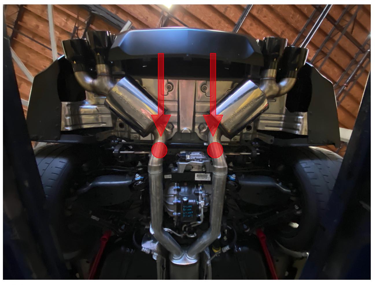

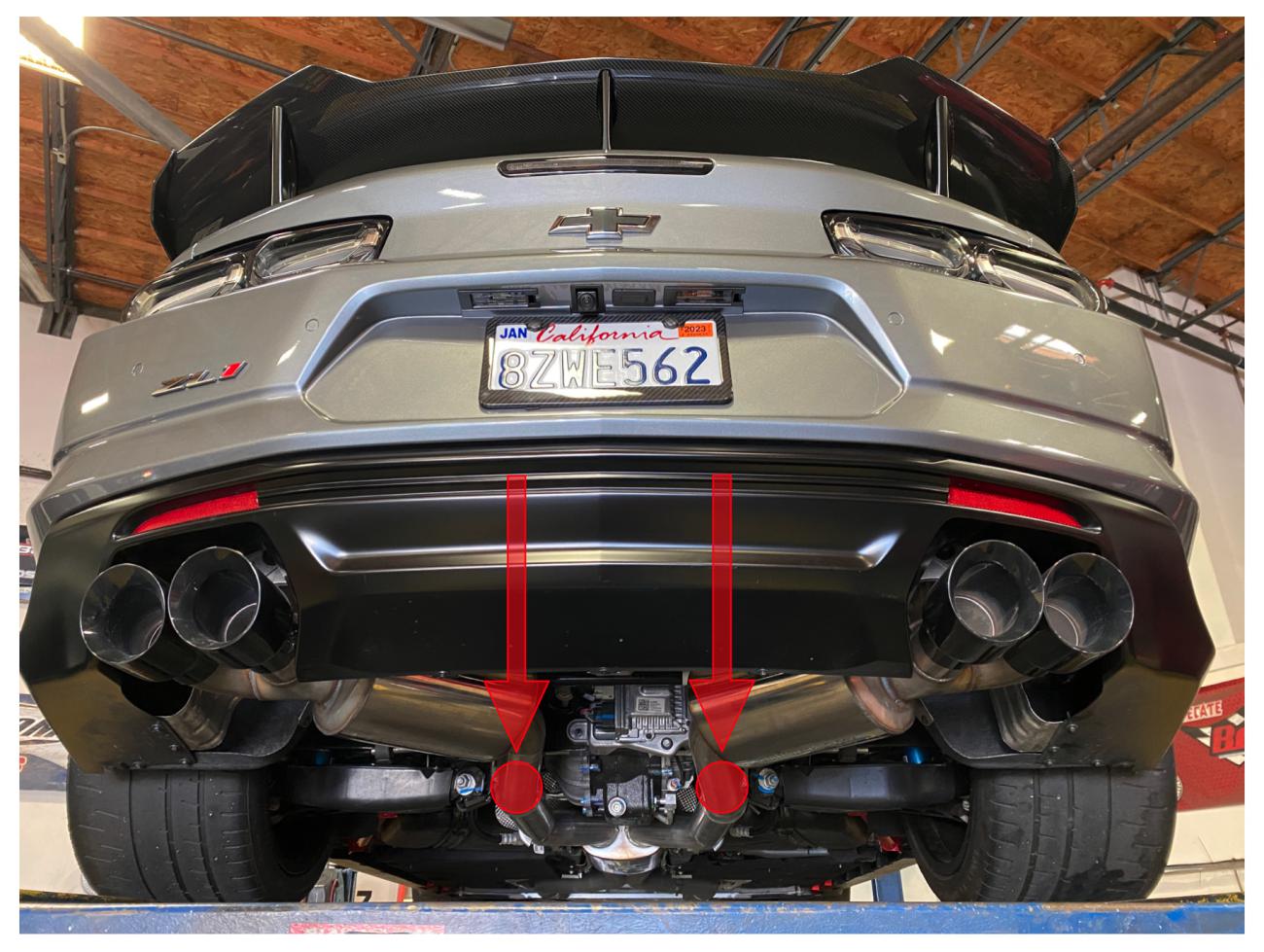

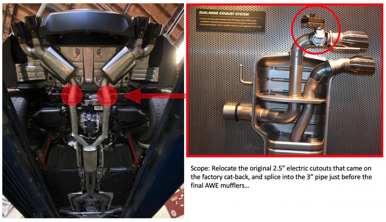

Thanks for the feedback guys… Trust me, no one is more frustrated than me for feeling the need to modify more… but I kept the old parts and love the idea of dumping the exhaust after the X muffler and before the AWE for more volume… I assume that would be a lot louder… Im thinking of something like this… but between the mufflers like I said. Anyone else do this?

I guess I’m worried that the “Y” diverted will either hurt the current sound or performance when it’s closed…. Due to added turbulence at the split?

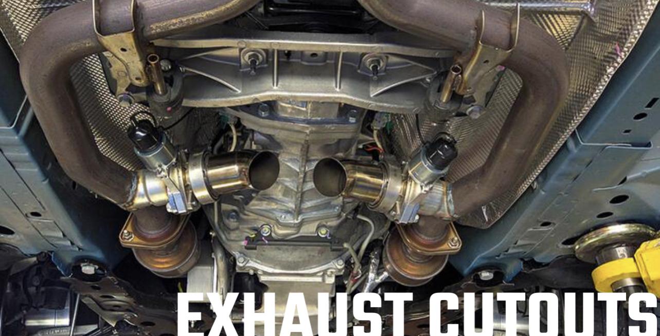

OK team... I am bringing this thread back... I want more "attention seeking" idle volume for low speed driving / car shows / piss off the neighbors, etc...
Like I said in the original post, I still have the factory cat back with NPP valves, and i'd like to stitch them back in either after the cats (super loud, and I dont think there is enough room) or after the center X (should be perfect)... that would only bypass the AWE mufflers.
I like this plan, because they can be controlled by the driving modes just like before.
What would you do?
