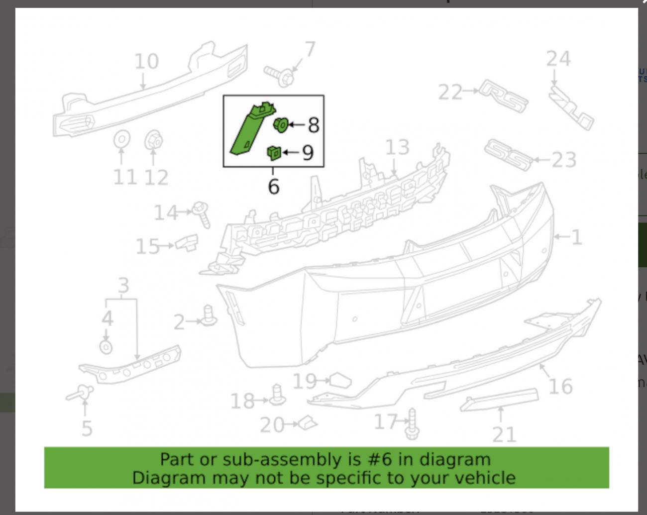

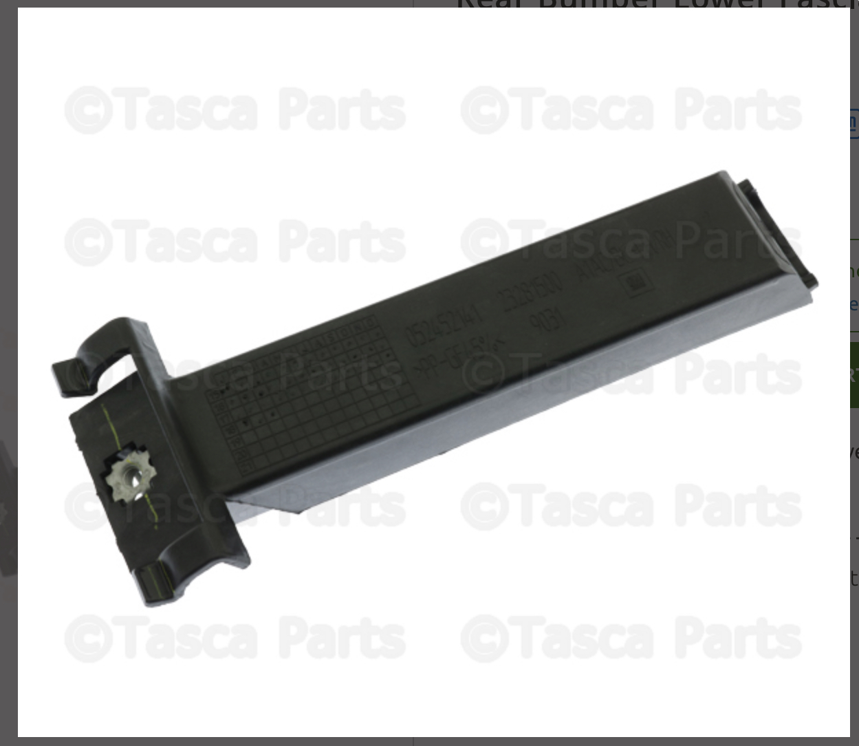

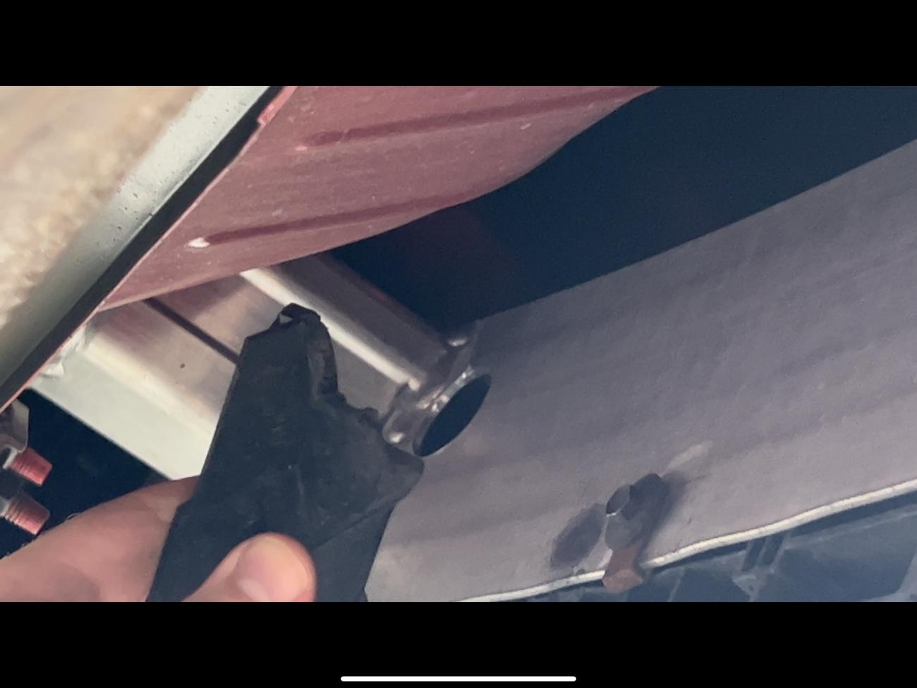

The noise from this has been driving me mad so I finnally got underneath the car to investigate. It appears the supporting brackets are both broken and totally loose. I attached a photograph. Although my car is still under 36k, I did get rear-ended and had insurance work done less than a year ago and I have since relocated. That fiasco was crazy as I was hit by another Camaro driver! Went without my car for a month due to State farm. Would a local dealership see this as warranty work? Upon further research it appears the bracket is its own part #23281500. Perhaps I can DIY. My bumper cover is also misaligned and sagging similar to the 2017 GM bulletin…frustrating
https://www.tascaparts.com/oem-parts...acket-23281500
https://www.tascaparts.com/oem-parts...ascia-84054988

If the Carfax report shows it was rear ended I don’t think it will be warranty, although you never know if the dealership would try to run it through a warranty claim also that part number comes up as being $14 so you might want to just change it yourself

My 1LT had a broken one of those, from what I figured it just adds rigidity to the lower valence. It’s two bolts (one to the rear crash bar, one to the bottom of the lower valence) easily accessible as you’ve already gotten to the ‘harder’ to reach of the two in your photo

Turns out it is more involved than I imagined. The repair shop installed the bumper cover first and then decided to be lazy and install these brackets backwards. To install them properly, the bumper cover needs to be removed. I will share a photos next time I find myself underneath the car.
