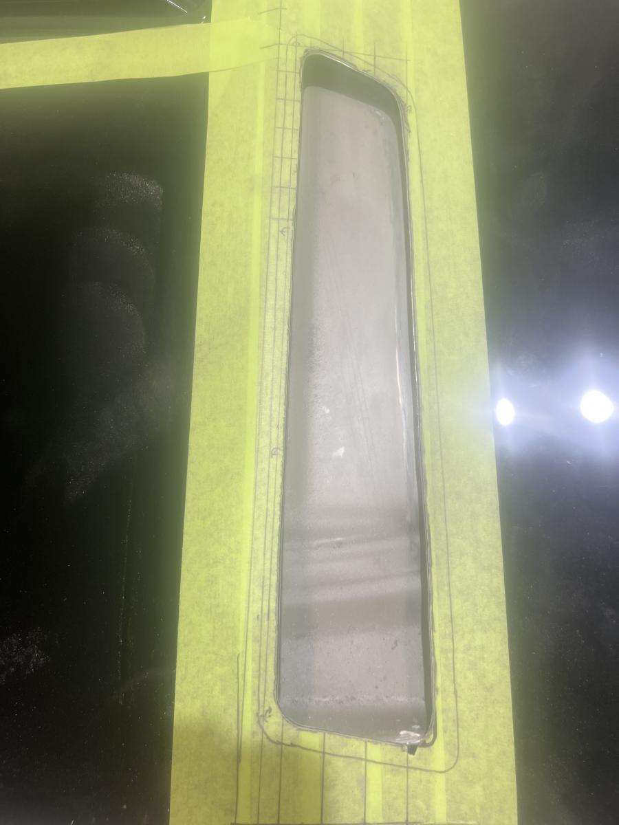

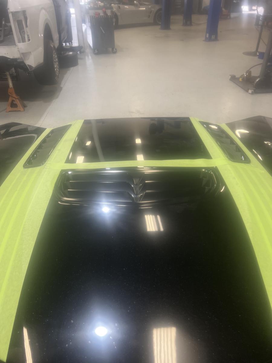

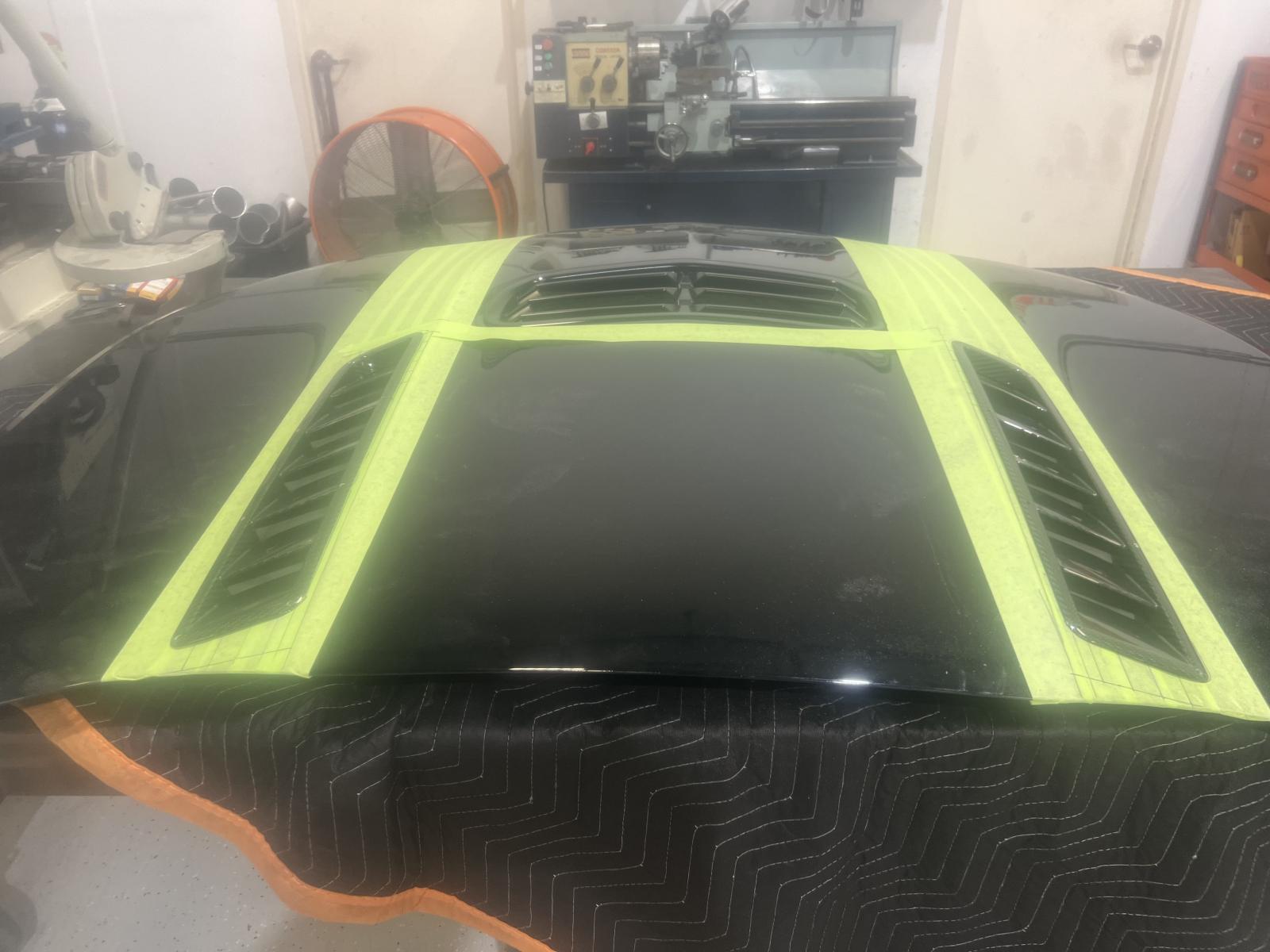

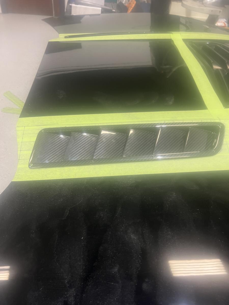

Well with the 100 degree heat down here the under hood temperatures were getting too hot when I was tracking. How do I know??? Well I cooked two starters over the last couple months due to excessive heat. So I am having AMP install these carbon fiber APR hood vents directly above the header area in my SS hood.
These pics show the install in progress. Typically you lay out some painters tape on the hood and then precisely draw out the cut lines and then cut the OUTSIDE part of the hood FIRST. It would be nice if APR Performance would have included a cutout template but they dont!!!

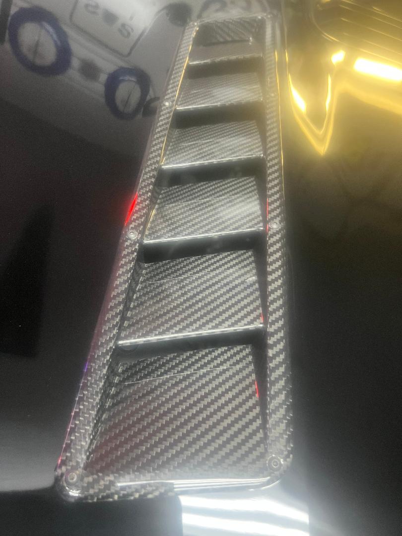

I will take another set or pics once these are installed. The finish quality on this APR part is very good and these cost roughly 375 dollars. They are attached with some very small stainless steel buttonhead bolts (included). There are 8 bolts per vent.

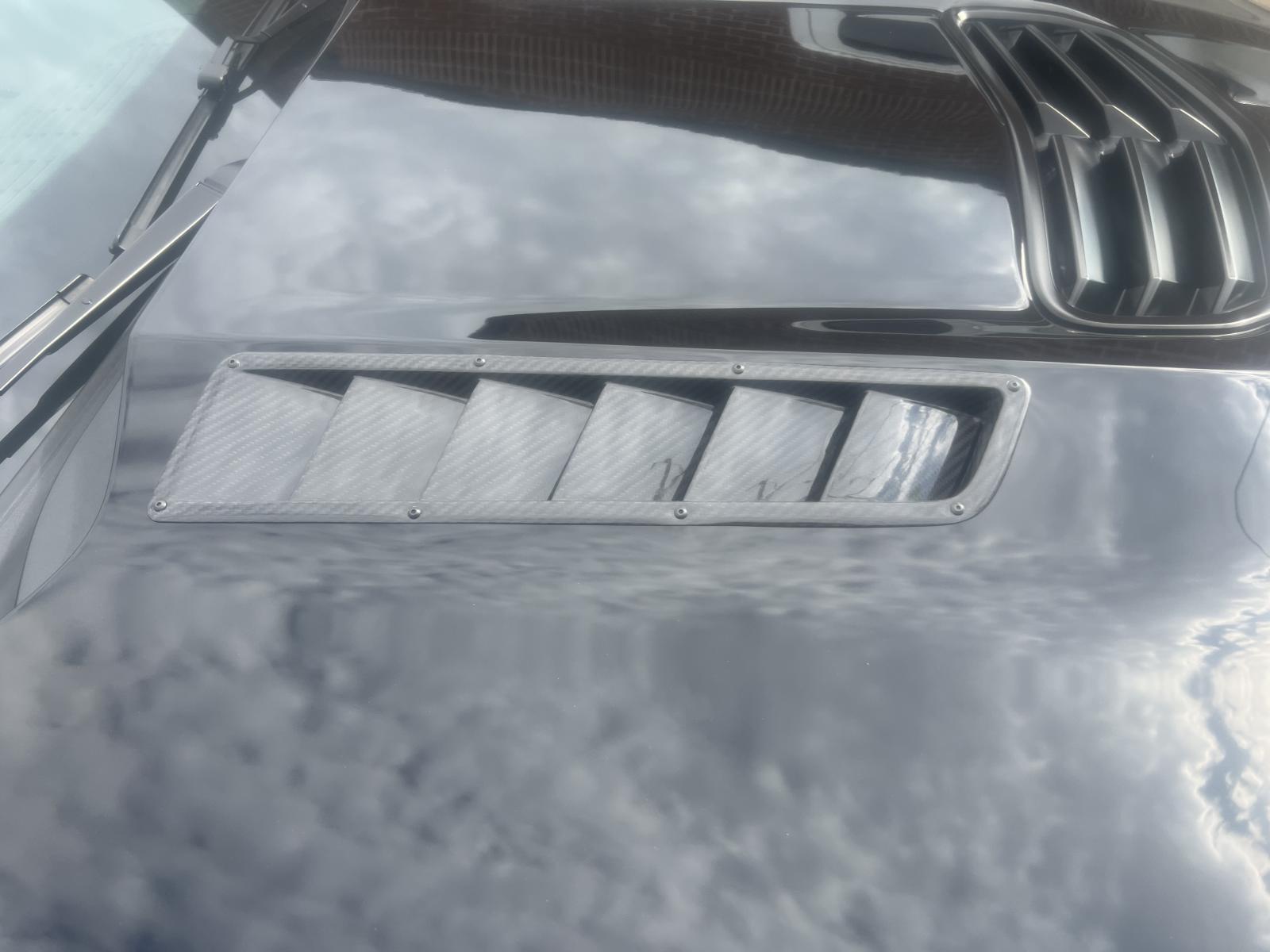

INSTALLED HOOD VENTS PICS

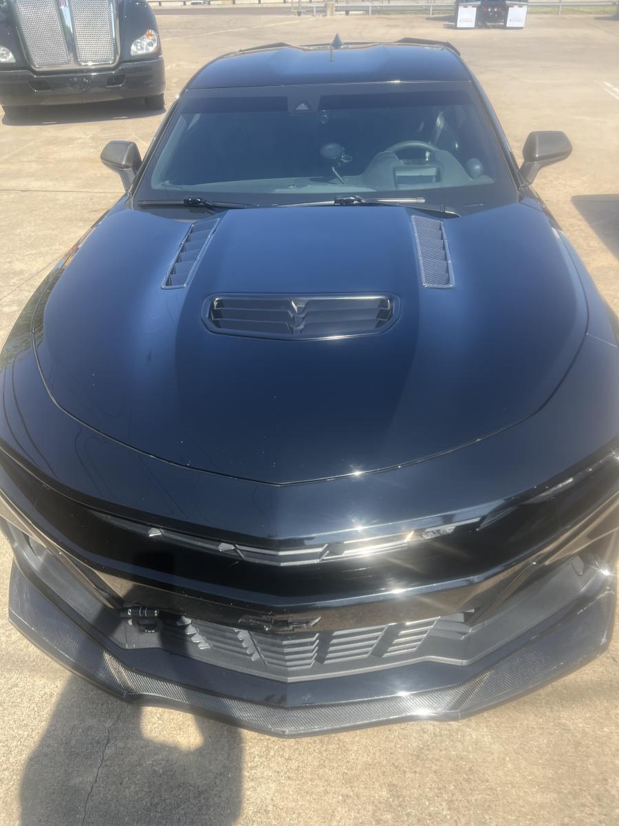

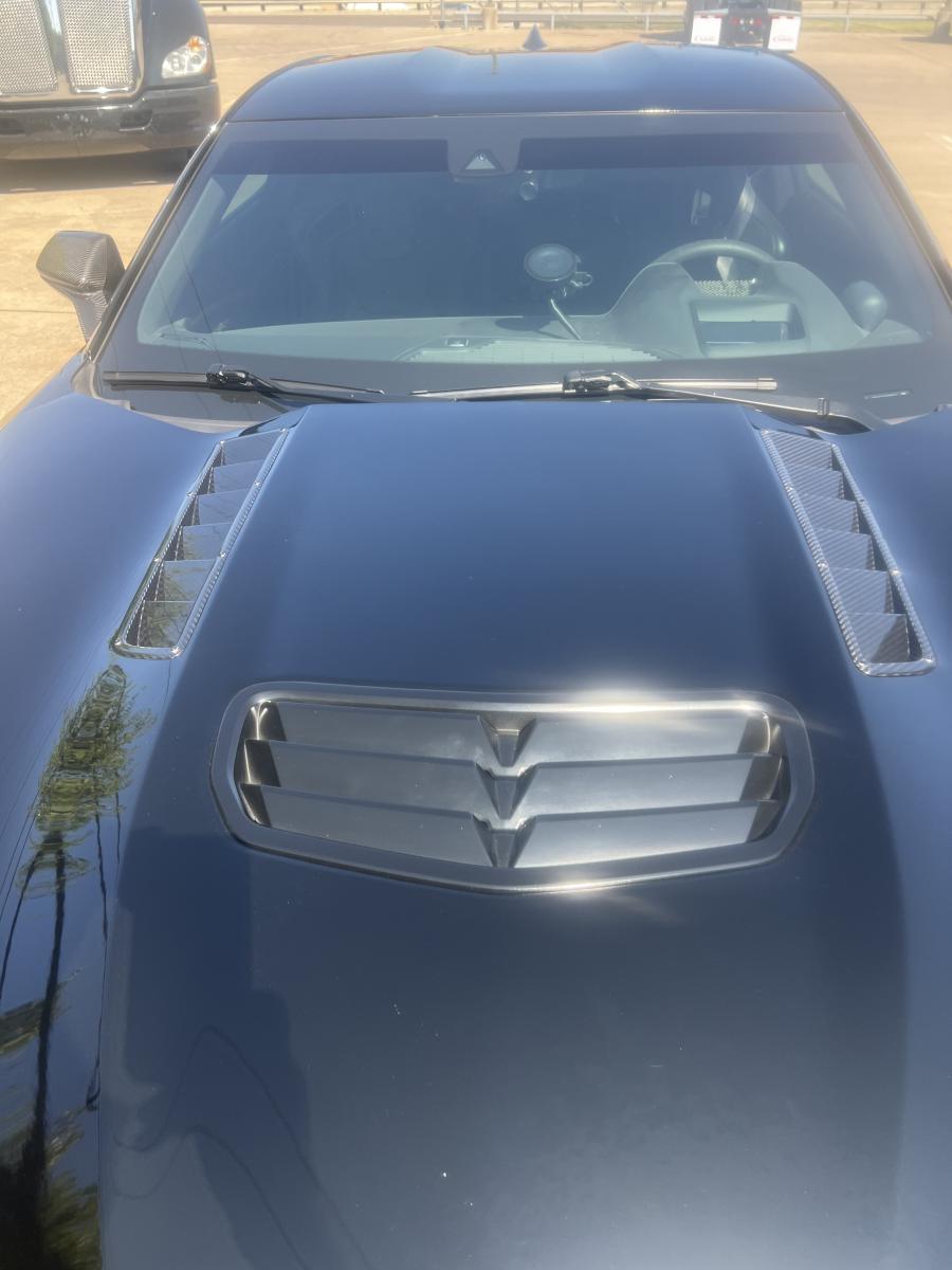

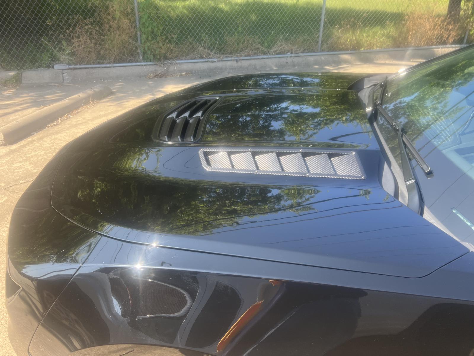

Ok as promised, here are the INSTALLED pics on the APR Carbon Fiber Hood Vents. Notice that the hood vents are DIRECTLY above above the header location so that heat can more easily vent directly upward and out of the car. It is my hope this will help with my issue of excessive heat during HOT track days KILLING my starter.

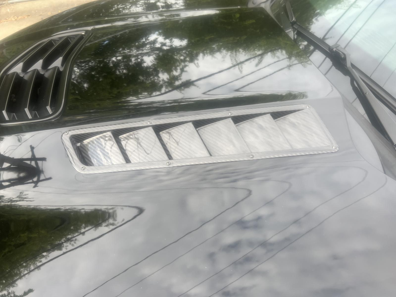

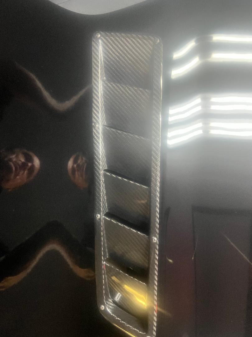

Updated PICS of HOOD VENTS

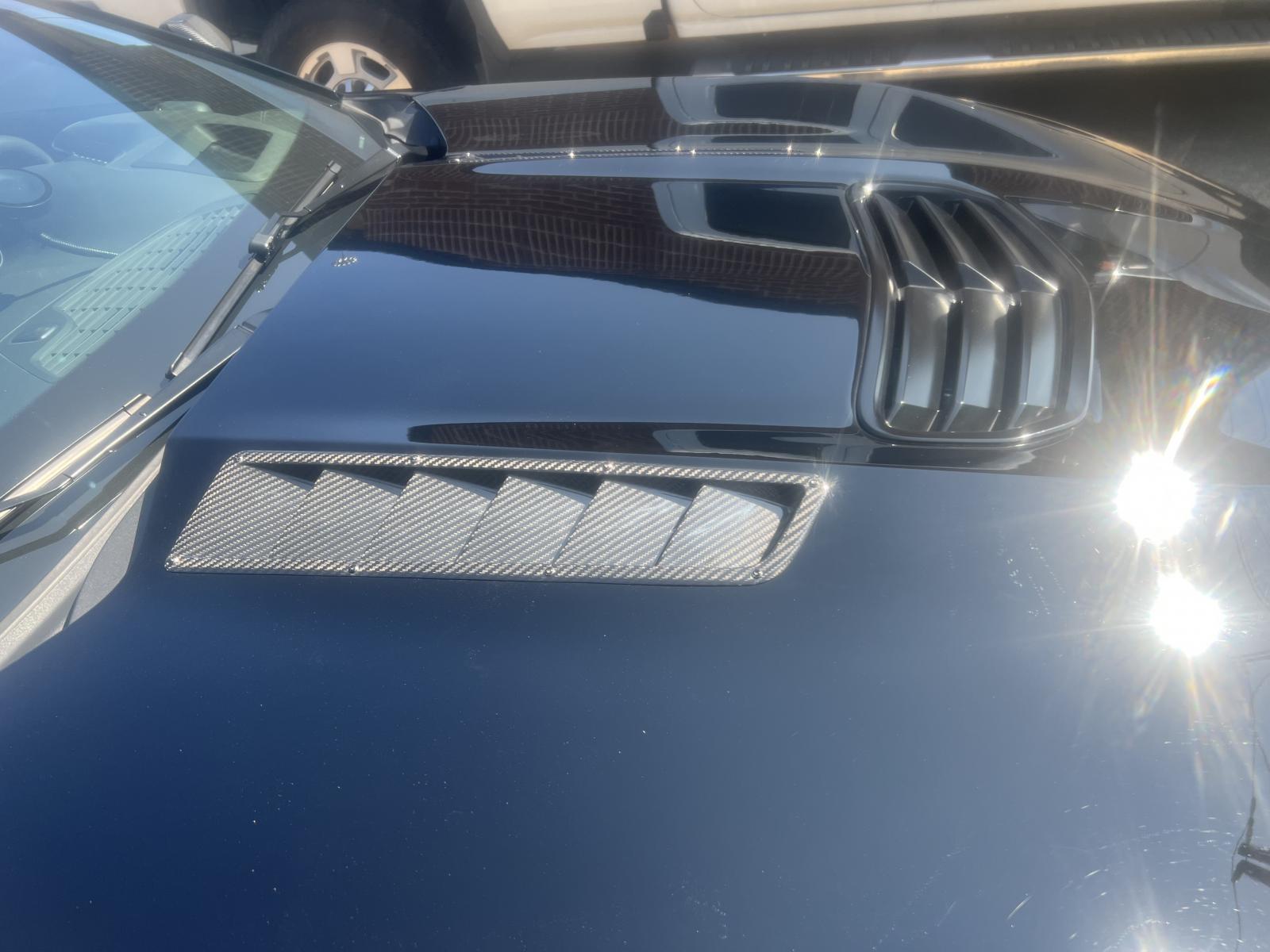

Well I changed out the small bolts that attach these carbon fiber hood vents to a BLACK bolt because basically I didnt like the look of the silver head contrasted against the carbon fiber vent and black hood. Since the overall theme of this car is bascially a STEALTH mode, wolf in sheep's clothing type of thing; I felt like the silver headed bolt detracted from that theme.
PICS Below.

Originally Posted by 24LT1guy View Post

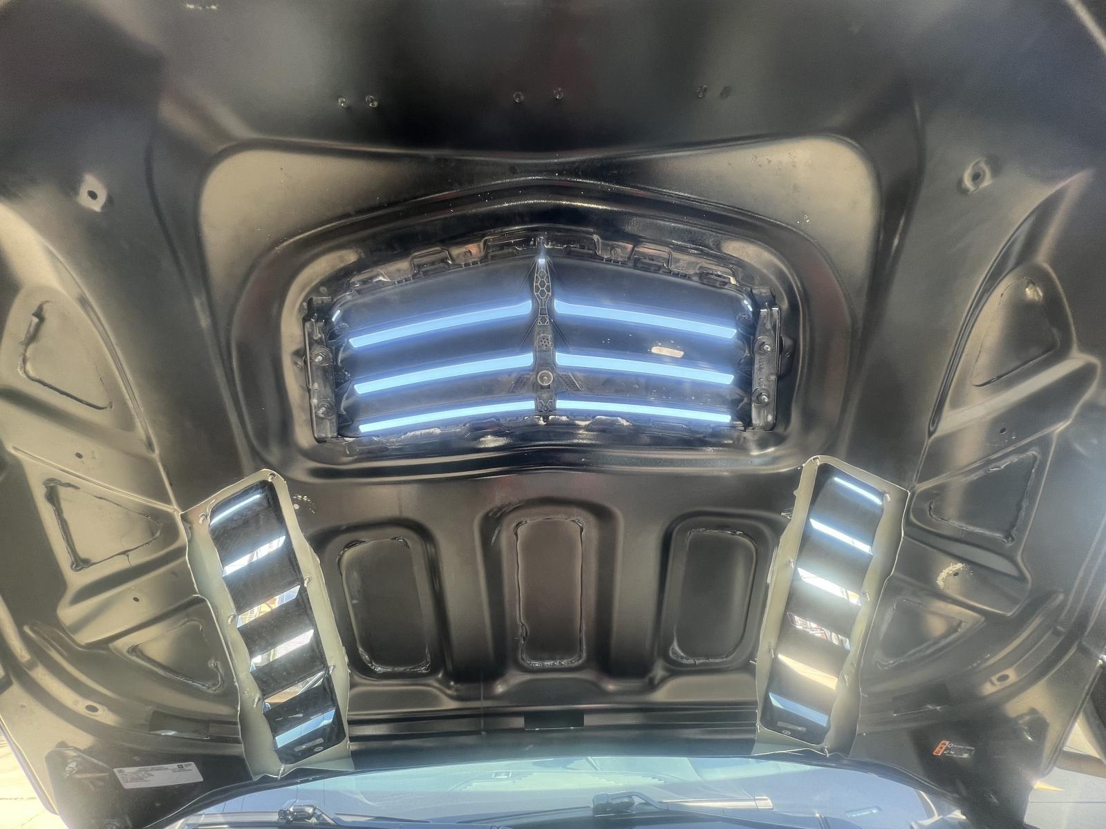

Are you worried about water intrusion?

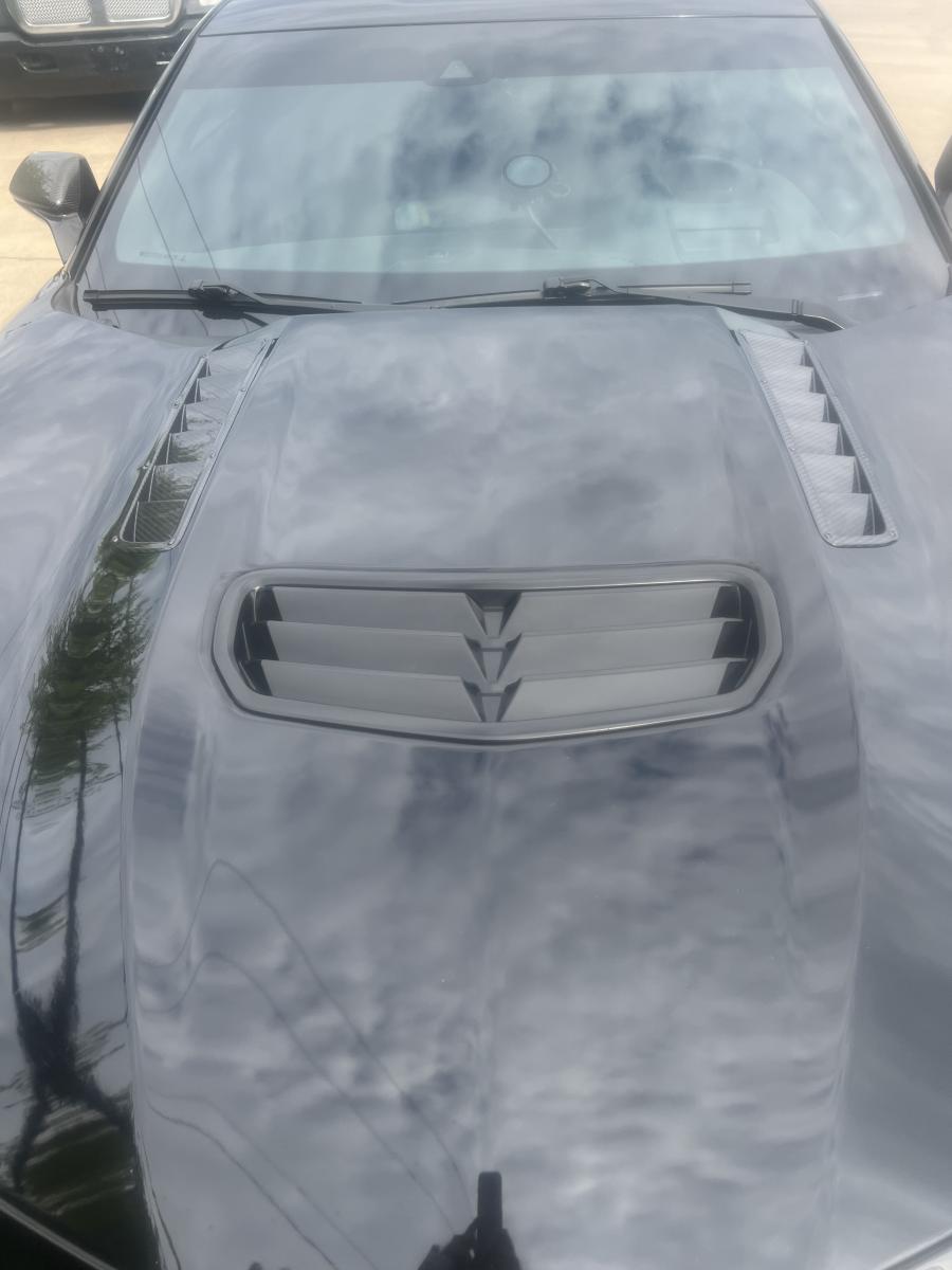

No not really The vents are designed where rain falling vertically cant not go straight down thru the vent and at speed most of the moisture will blow over the top of the vent with the air flow
Look at the FIRST PIC below which is a view of the vent from the TOP. The SECOND pic shows that the largest opening faces the back side or windshield side. As the air enters the FRONT of the car it will exit out through the BACK part of the vent opening towards the windshield.
