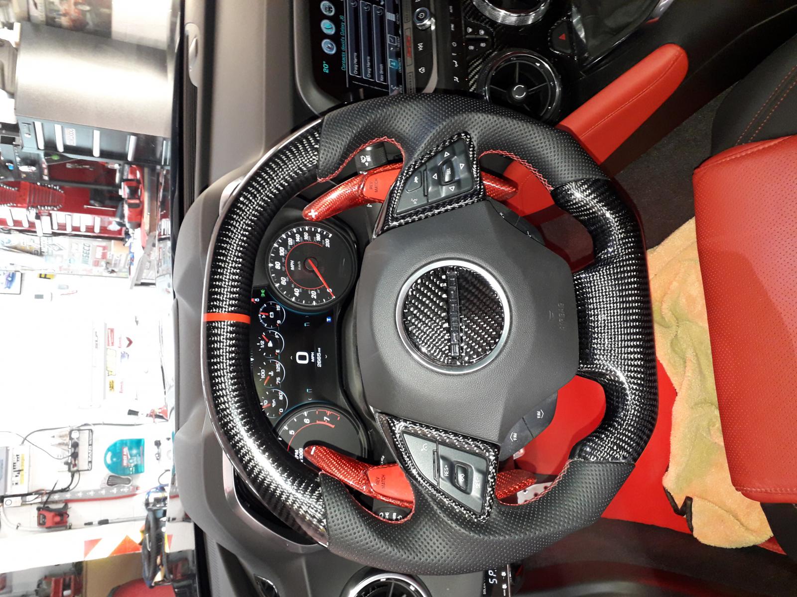

Guys,
Need some guidance here please
Pushed the button on a CF wheel from Matt at Wild Hammer for my 2018 2SS last year. What a beauty! Looks and feels so much better than OEM. Heated option delete but hey ho.
So at last its install time seeing as the nice weather has stirred up the gray matter.
So ive done my research and gathered tools and stuff together.
1/2" T50 torx (quality item)
Torque wrench and breaker bar.
Impact wrench..air and electric.
I can handle the air bag and electrics but its alignment with the clock spring and the splines on the steering shaft.. will it only go back in one position?
Also the crazy stories im readfing about the steering wheel bolt and the loctite... are they ALL like that or might I get lucky?
I dont want to mess anything up as a failure on this could result in a big headache.
Thoughts and inspiration guys??
https://imgur.com/9AW1elo

Well you guys were right. It was a snip!
The pesky bolt came out with a full blast from the impact gun.
The hardest part was re-torqueing it up to 33 ft/lb.
Its not much but I could only get to 30 with one hand holding the wheel steady. I should have got the GF to hold it (and the wheel)
Anyway plenty of loctite and that aint goin nowhere.
Not sure about the paddle extensions..will have to think on that.
Thanks a bunch guys.. this forum rocks

Looks amazing
These paddle extensions I'm not a fan of, because they cover up a good chunk of the tach and the speedo. Carbonaddons sells extended paddles that are actual replacements and not tack-ons, those are shorter and most likely better in terms of DIC visibility.
