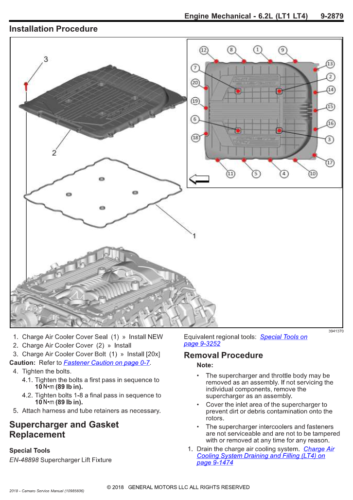

These days the best option for a service manual seems to be a short term ACDelco TDS subscription (see near the bottom of the page) and then saving all the data you need like a click monkey. I purchased the 2018 service manual from Helms Inc., but GM has no longer offered full shop manuals there since 2019.

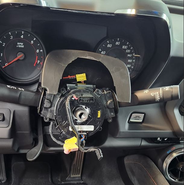

Good info! I ordered a one month access... I did find procedures for SAS reset, all kinds of stuff ! My brother in-law already knew this stuff. But I wanted to print it to PDF to keep. Also, I'm trying to find in the online access subscription where to find the torque specs and the torque patterns for the engine such as intake, exhaust, heads, valve convers, supercharger lid etc. I want to get as much of that stuff printed to PDF as I can before my one month runs out. I can only find the info such as torque settings like 18in lbs, initial pass, first pass, second pass and final pass. But no diagram showing torque "patterns". Does anyone know where that may be in those documents?
Also, progress was not really made last night. Be Bro-In-Law hooked up his crazy fancy Snap-on Tool Diag. tool (made my gaming laptop look like a abacus!) Anyway, he was able to read live data logging for pretty much everything on my car such as throttle position, brake pedal position, lights on lights off, even mirror position etc. But he couldn't get any data when turning the steering wheel left or right, the data value stayed at zero. He thinks the problem is deeper. This evening we're are going to confirm no blown fuse down stream somewhere. But the fuse that's on the unit inline at the wheel/ SAS is good. So we'll see. I might order a new Steering Angle Sensor anyway just in case. Here is a pic of the current state! UGH !

The manual should contain torque sequence diagrams as well, see an example for the LT4 supercharger lid below.
Section 15 covers the steering wheel in great detail, you may want to save those diagrams and check all the related fuses. I'll see if I my (mildly fancy) scan tool can capture the steering wheel angle, just for kicks.

Thanks !!!!

Great News !!! She's ALL GOOD !!! So, after further diagnostics and seeing the live data on the scanner. The scanner showed the steering angle sensor rotating and showing the angle degree changing positive/negative. But, I couldn't recalibrate it / complete the relearn process for zero position. It gave errors about control module rejected the request. I picked up a new SAS today and installed it and presto! The recalibration/relearn zero position worked fine and no dash warnings and no error codes! So, I guess the original SAS I had was kind of working, but it most have been glitched since it wouldn't allow the recalibration process. That was strange, but replacing it got everything back working correctly! I can say I learned a lot from this process and learned I hit a new high for my stress level! Thanks!
