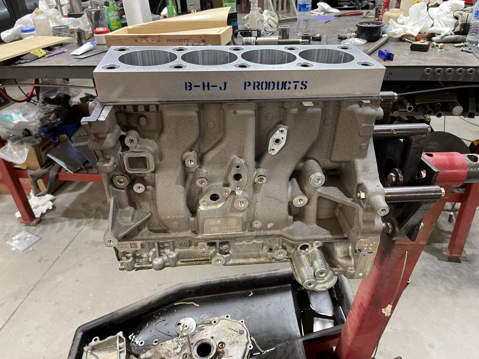

I've had my pistons/rods for awhile, but finally have all the parts for honing the block so I can install them! ARP 11mm head studs of "2000" series material will add a little clamping on the stock head gasket, took awhile getting these! BHJ made the torque plate. Next will be honing the cylinders for the forged JE replacement pistons.
