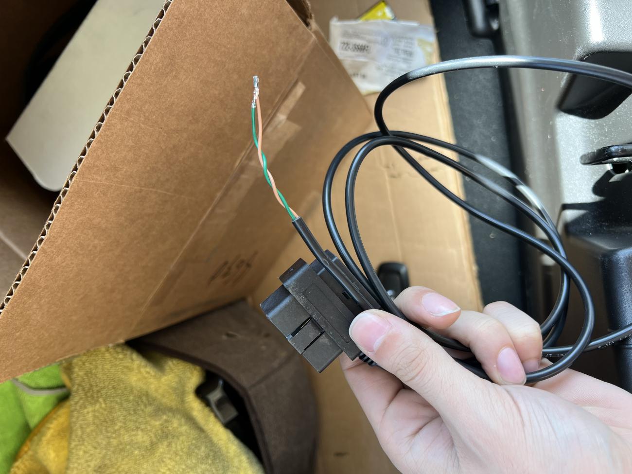

Hello Everyone,
Had a local shop install and AEM wideband and they did not install the OBD2 portion of the wideband. My AFR is reading correctly so this is not the issue, but when I plug my MPVI into the car and open VCM Scanner to datalog, my car is not recording AFR. I assume this is because the OBD2 portion is not installed, but since the actualy AFR gauge reads, is there any way to get around reinstalling with this OBD2 plug. Appreciate it in advance!

Correct the gauge and the sensor will work fine together but not give you the AFR wideband data. You need to connect the OBDII adapter to power, power when only the ignition is on and then you will get Wideband data to the HPTuners. I used this video for how to get hooked to the correct power!
