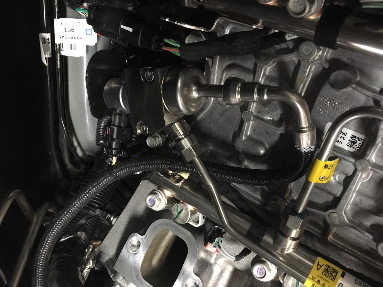

What did everyone do for the fuel line that connects the hpfp to the low pressure fuel hose? With the 1/2 plates it does not look like the factory one will fit. Looks like it will be to short.

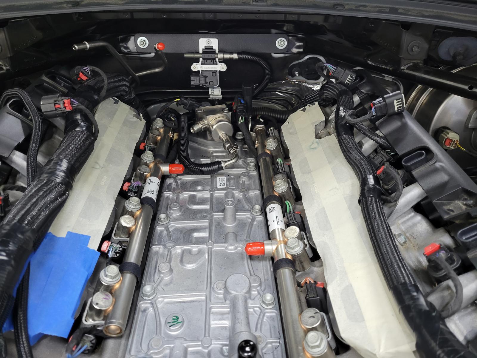

Here is the correct answer
This is what you do

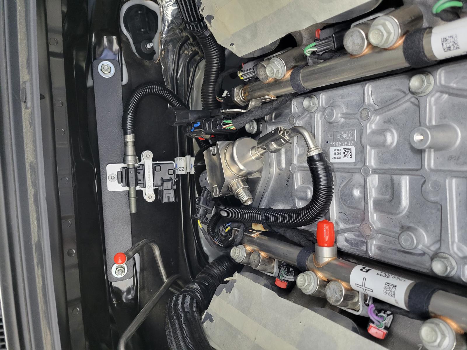

More pics
Here are more pics

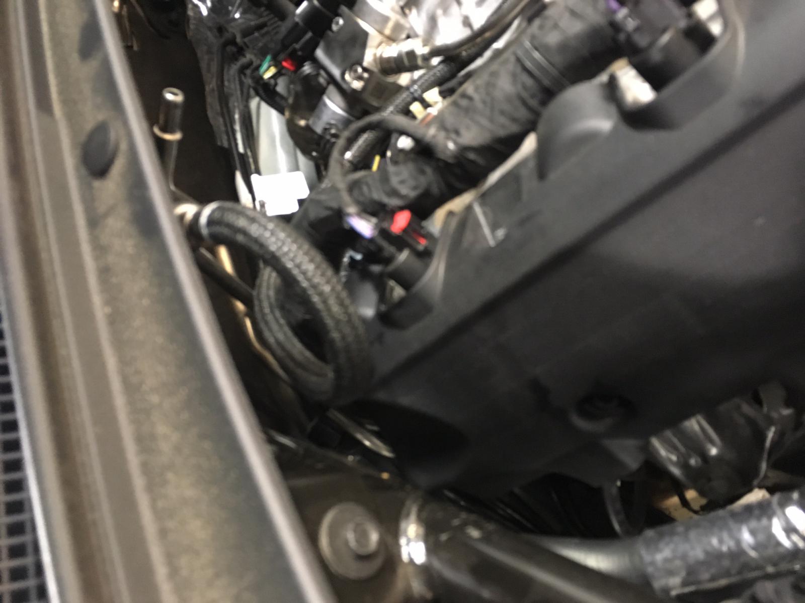

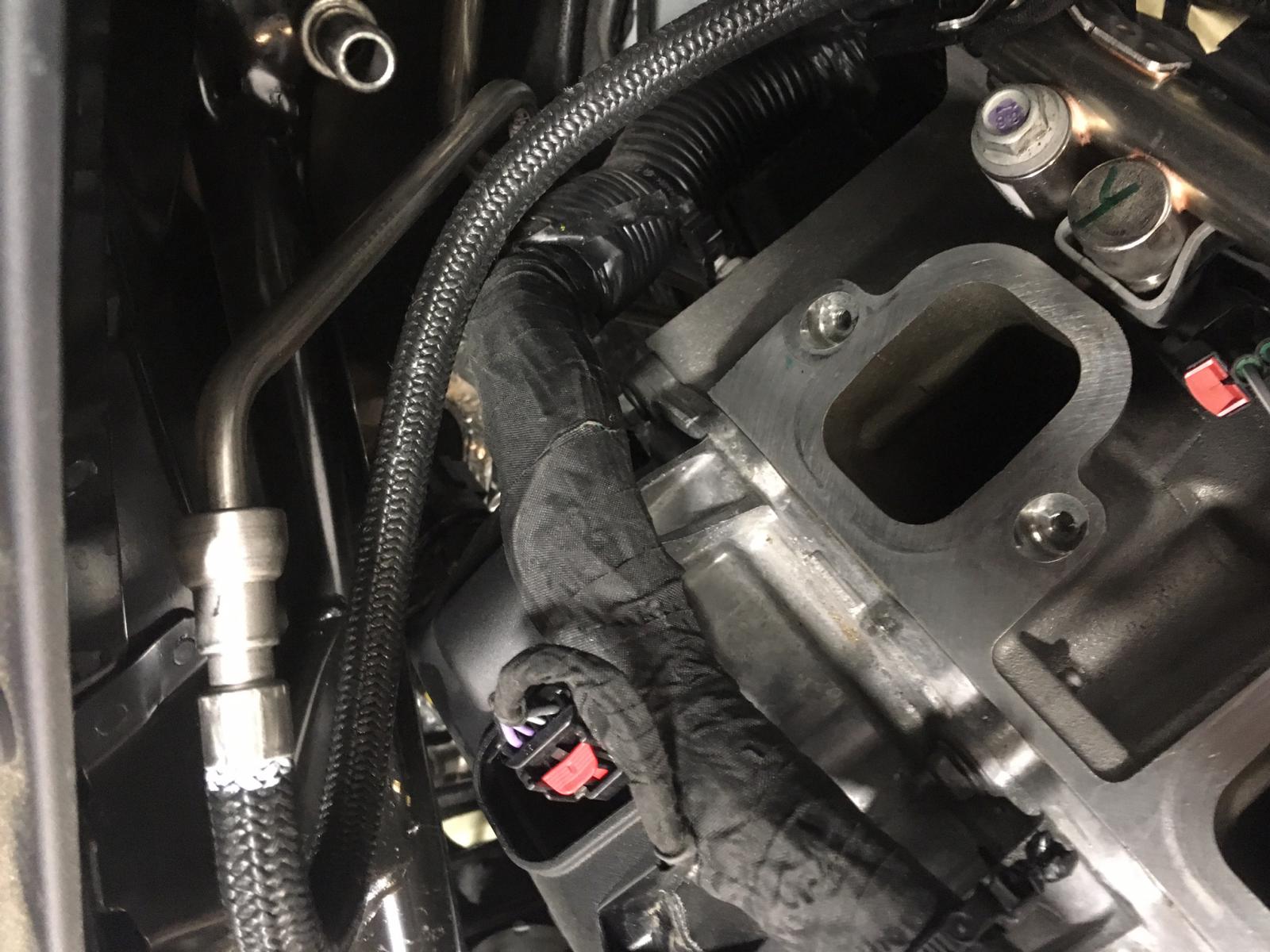

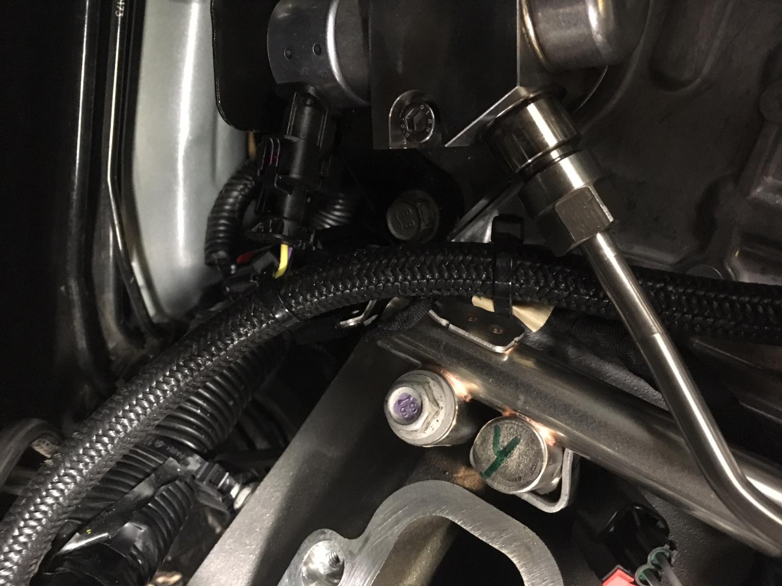

ADM thanks for your response. I took a page out of your book but added my own little twist to it. Now just waiting on another fuel line to come if to go from tank line to inlet.
