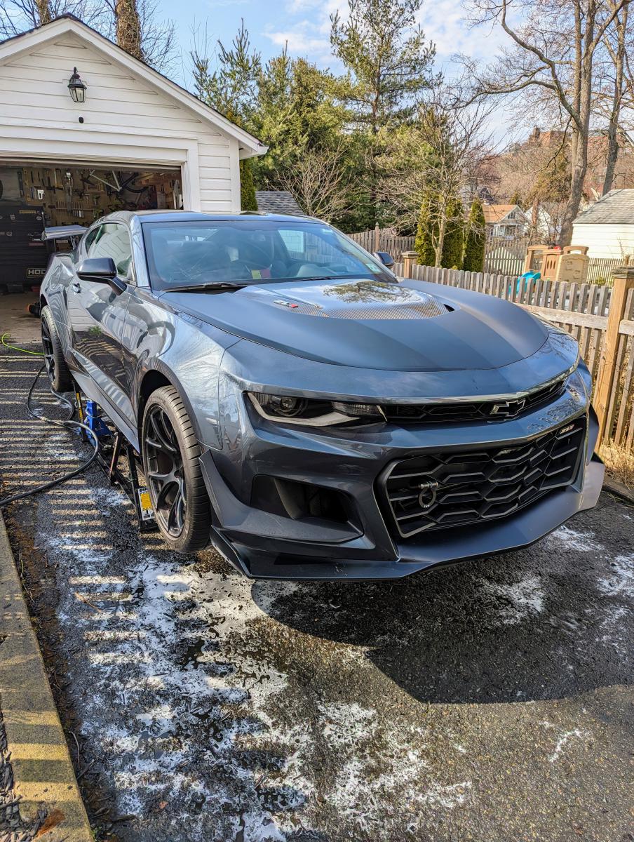

Ok, she's ready for track season. Got the last few bits done yesterday; first event is at VIR April 14-16
- Diff flush with 10-4034
- Installed and adjusted Schroth Profi II ASM Harnesses
- Gave her a quick bath

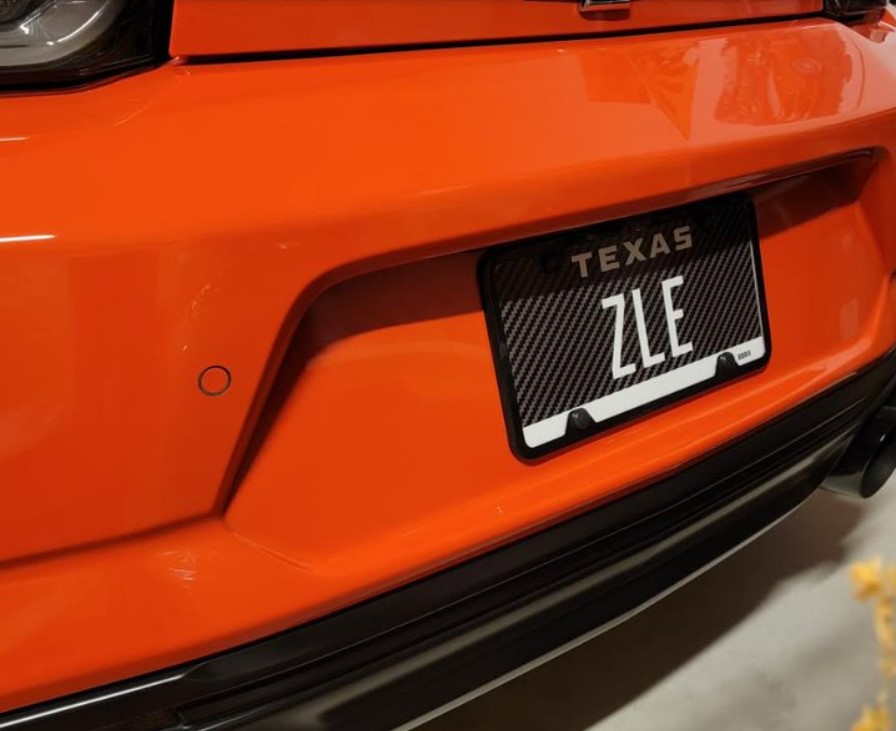

Nice Plate...
Old 04-01-2023, 10:09 AM   #33
RamAir02
Shadow Gray '19 ZLE M6
RamAir02's Avatar
Drives: '19 ZL1 1LE M6
Join Date: Apr 2009
Location: NJ
Posts: 1,458
Nice Plate...
Attachment 1124044
The carbon fiber weave plate is quite the upgrade from yellow NJ plates

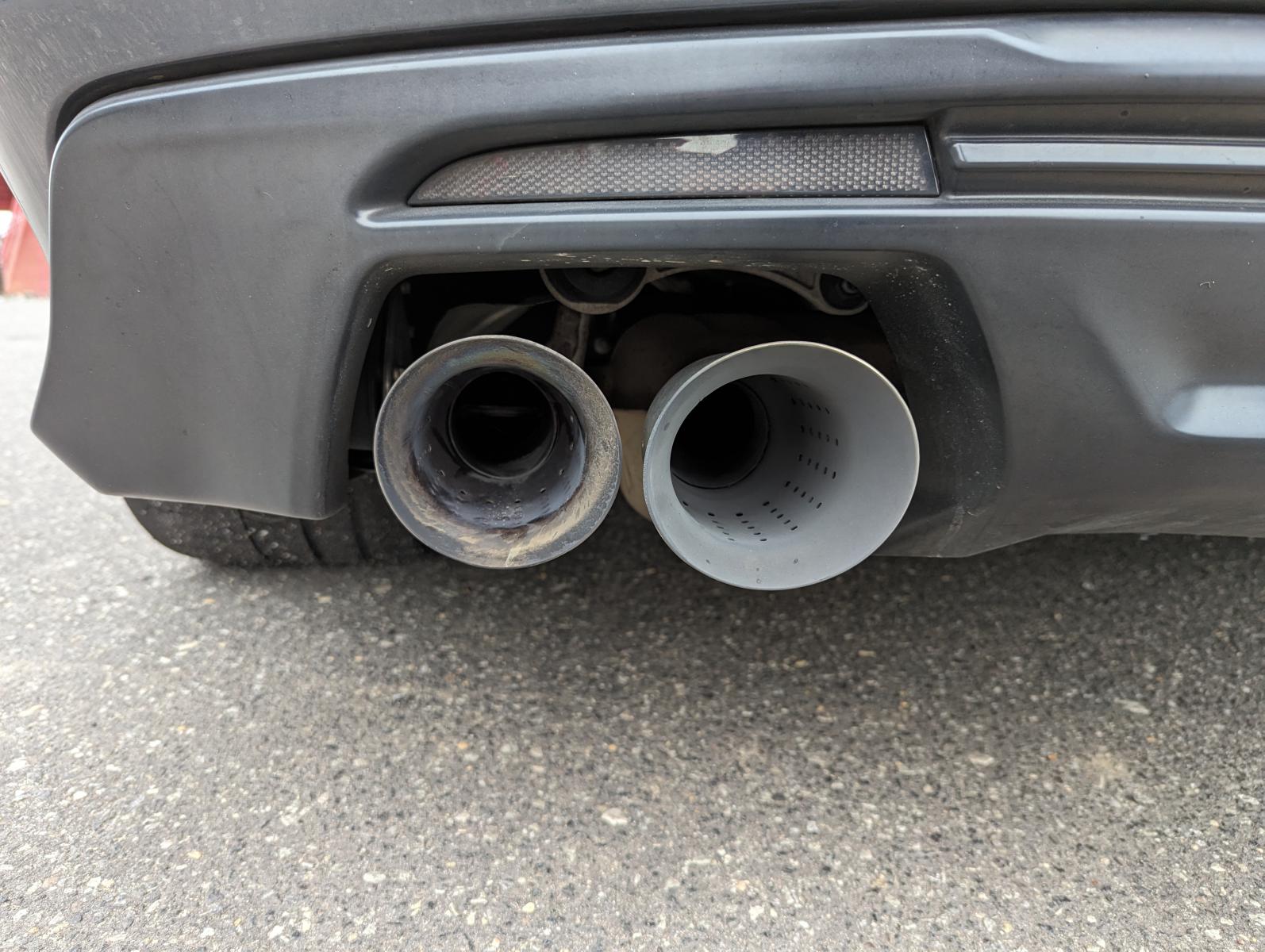

Welp, yesterday was the first day of a 3 day track event at NJMP Thunderbolt. Unfortunately, I had to come home last night...
I'm 99.9% sure the cats disintegrated. I was coming down the front straight and heard a loud sound and saw a big puff of smoke in my rearview mirror. I immediately let off the throttle and then a corner or two later, she went into limp mode (service rear axle, flashing CEL, etc.). Once I got back into the paddock, I still wasn't sure exactly what happened and I wanted to check for engine damage. I started her back up, no lights, engine running smoothly... But I can hear a rattle coming from the exhaust under the driver's side and the left tailpipe was completely white. Heck, the entire back of the car was covered in a fine white dust. I shined a light into the exhaust and found some little bits.
Not sure if only the secondary cats blew up or the primary cats as well. I dropped the car off at the dealer this morning. I asked them to check both sides and also expressed concern that there could be bits stuck in the muffler case. Ideally, I'd like them to replace the entire exhaust from the manifolds back, but I'm sure that won't happen.
On the bright side, I pumped in a new personal best lap in the second session of the day -- 1:30.10. This was my second time at Thunderbolt -- my first time was last May and the best I could muster was a 1:33.30, so it's a nice improvement. Still need more seat time at this track. The lap was sloppy, I missed a few apexes and I was overdriving the car a bit. Thus, I do think there's a good bit more time in me and in the car.

Great time 1:30. Sorry to hear about the car - haven’t seen this type of an issue prior. Hope they do take care of it - also curious about what might have caused it as you are stock engine wise right?
