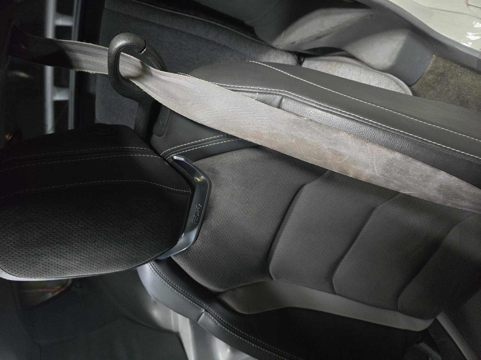

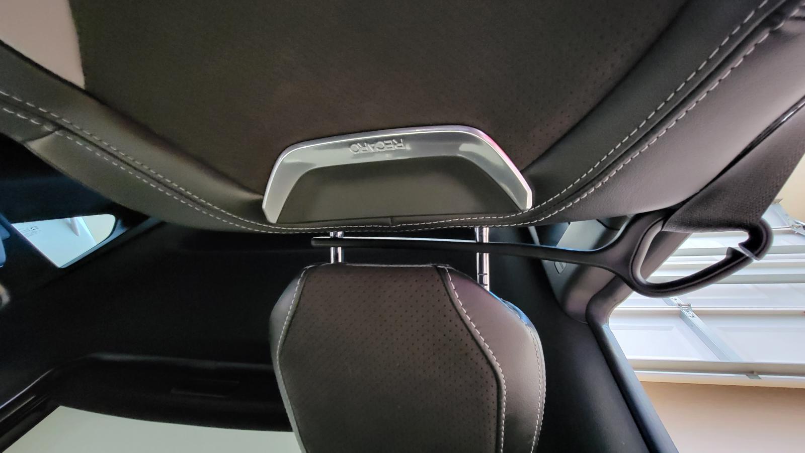

My wife complains about the seat belt being too far back for her, she is only 5' tall, when her seat is adjusted forward. I've never really noticed it but she has complained enough so I went looking for a solution. I didn't find anything specific for the camaro or the recaro seats for that matter but after doing some measuring on the headrest posts I found these that are made for the mustang.
https://www.ebay.com/itm/36407313856...3ABFBM4un22e1h
The hole spacing and diameter fit perfectly for the Recaro headrest. The only issue is the loop doesn't clear the shoulder of the seat so the body of the guide under the headrest rides at an angle on the posts. I think I'm going to take them back off and use a heat gun to either slightly angle the loop forward or up so that the body of the guide will lay flush on the seat under the headrest.
Overall I think it works well and fits with the style of the Recaro seats, even if it is for a Mustang!

Not sure why that photo loaded upside down.

Dang it! Did it again! Oh well, you get!

What if you turn it upside down (not the pics)?

It's hard to tell in the pictures but the body of the guide has a slight curve to it also. So when you turn it upside down, it curves to the back and blocks the seat release lever.

I got some cobalt seat belt guide. Had to enlarge the holes and I flipped the driver and passenger side.
But I think they came out well

Can you still release the seat with this guide installed? Looks like it covers the latch almost completely, or is it just the photo? Thanks.
