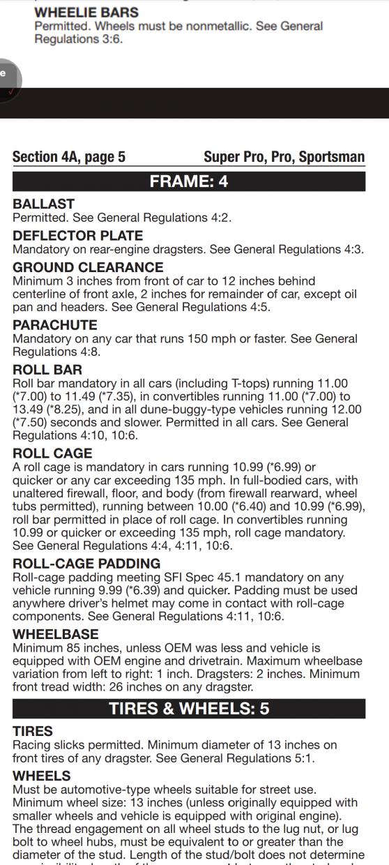

Hi Guys, so a little off topic to the Demon , so back in the days 1976 to 2003 , when I Drag Raced 11.99 was the threshold , you needed a 8point roll bar. So has this changed, I Raced my then 22 1SS last year 12.17 @114 . Now having my ZL1 and low 11s ET , is a Roll Bar required . So here is a screenshot NHRA site rules, Iooks like things haven't changed much 11.49 to 11.0 roll bar required 10.99 quicker roll cage mandatory. If I understand this I cand exceed 11.49 ET .

I don't believe a Gen 6 ZL1 requires a roll cage above 9.00.

Nice thank you, I figured so , but only thing I found in the rule book I screenshot. Thanks again , Can anyone else verify or find in the NHRA rule book? Thanks

You can download the 2023 rulebook at nhra.com or call your local track. Bandimere gave me the 9.00 figure when they Tech'd my car last year.
