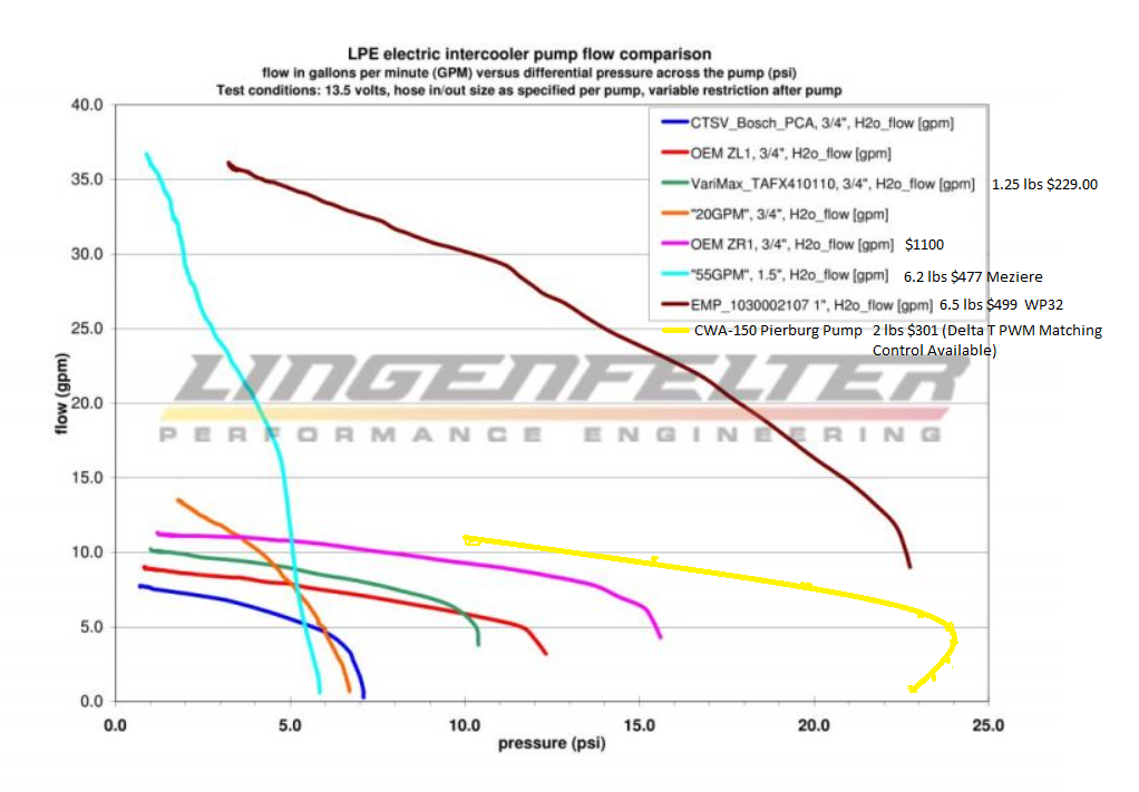

Negative my friend. I’m not using the Varimax pump (originally came with the 2.9) anymore and I’m not using the Bosch pump (that came with the 3.0) as the flow is only 4.4 GPM at 12 PSI or so (technically 1000 liters/hour at .85 bar, I looked it up on Bosch’s site), making it similar in performance to a stock LT4 IC pump. No bueno. I’m going with a Pierburg 150 which will do over 10 GPM at 12 PSI.

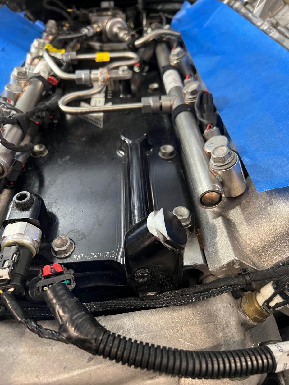

So a small update: the new 3.0 does NOT fit with the Katech AFM-delete valley cover. The hefty PCV boss on the cover interferes with the blower snout. Well, it did…but we broke out the die grinder for some “clearancing” action You have to be care not to get into the PCV plug sealing o-ring but this picture shows it about 60-70% of the way there before calling it a night. We’ll take a little more off, touch up the black finish, then hopefully bolt the damn blower down! I gave Mike @ Katech a heads up too so maybe they can address it during the next cover production run… or just grind away.
