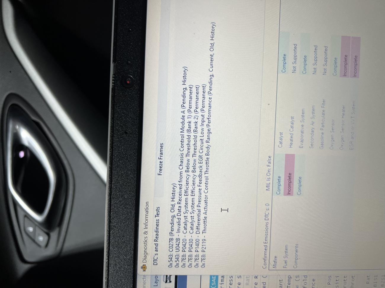

Hello/
I am getting this code that won’t clear p2119. My builder mentioned he has had issues with NW TB and the TPS sensor. He said I’d have to call NW for the correct sensor. Does anyone know what part number that sensor is?

You could try an email to Soler performance and see if they know part numbers for the sensors. Looks to me like the actuator and sensor is all part of same assembly, which appears to only be sold with a throttle body attached. there may be some kind of zeroing or calibration involved if you try to swap the assemblies.

Yea I called Nick today and he said the p2119 is not am issue, or one that would cause my issue of not starting. It is more of performance range indicator being out of spec from oem. He said I could have tuner disable this code if needed.
